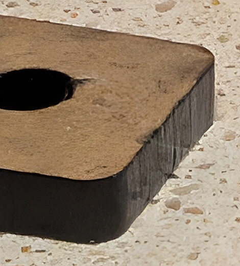

I usually cut wood with my GF, but recently got a new project that uses 1/4" black acrylic. I’m having issues with the cleanliness of the cut sides, they have ridges that I can’t eliminate. Other posts on this forum indicate this is a natural thing, but the rough, ridged edges on acrylic just aren’t professional enough for me to sell as a product. I’m looking for ways to reduce or eliminate these ridging artifacts.
Here’s a 1"x1"x.22" test cut where you can see the vertical ridges. This is what I need to eliminate.

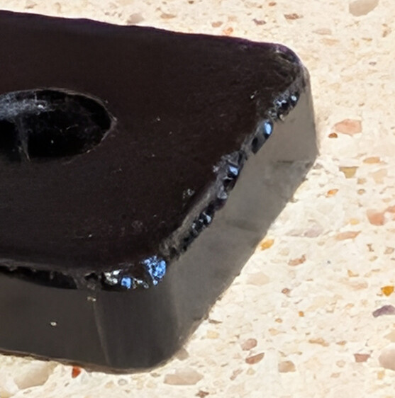

  • Multiple passes seem to burnish the edges, but the corners become crumbled (see below)

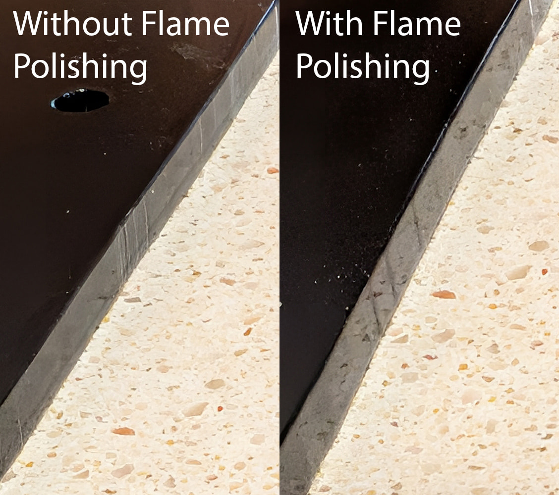

  • I’m flame-polishing the edges with a kitchen torch, to soften the corners, but that only mellows the ridges without eliminating them:

I have had good luck with high-grit wet sanding (including a sequence of Zona papers) followed by polishing compound, but it is a lot of work and can be challenging for curves.
if you can get one piece exactly the way you want it, could you make a silicone mold, then cast the pieces in acrylic resin? That will generally give you a consistent finish similar to your original.
Based on your settings, you have a 40W Glowforge Basic/Plus, which must have a very old tube. It’s really difficult to cut 1/4" acrylic cleanly with only that amount of power. Cutting with two passes gives me smooth edges but they are not visibly clear any more, so you’re back to some combination of flame polishing and wet sanding. The right answer may be to have someone else cut these in bulk using a more powerful laser with better air assist, or to buy a more powerful laser with better air assist.
Or try some blue tape over the air nozzle with some holes poked into it. Might be able to get enough air volume to keep the lens clean without creating a wavering flame path that results in striations & ridges.
Thank you for the suggestions and insights. It doesn’t sound like I’ve missed anything obvious, and further testing with speeds ‘n feeds have not improved the random reeding artifacts.
The casting my own resin idea is an intriguing one, with its own challenges (I do other smaller-scale resin casting), but I’m not sure that would scale for this project. The wet sanding idea is a good one also, although having to hand-sand hundreds of 6x6” irregular-shaped objects gives me nightmares. I might just do it for the top side, which is mostly straight.
