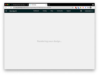

No, I mean “rendering speeds”.
When the app sits telling me it’s ‘rendering’ for 30 minutes it’s not on my end.
Now it just told me it had a problem uploading my design and come back later.

Do you mean you’re seeing this screen for 30m?
Do you see that when you open an existing design?
If so, I suspect it has something to do with your internet connection (to your computer) and/or your browser. Trying clearing your cache, try different browsers, try running a speed test.
