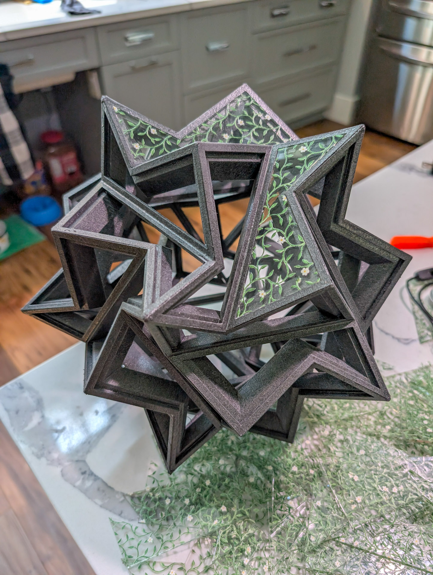

Sawtooth Polyhedral

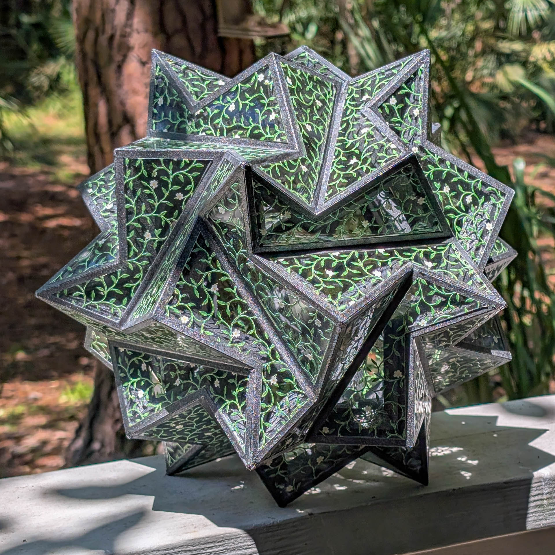

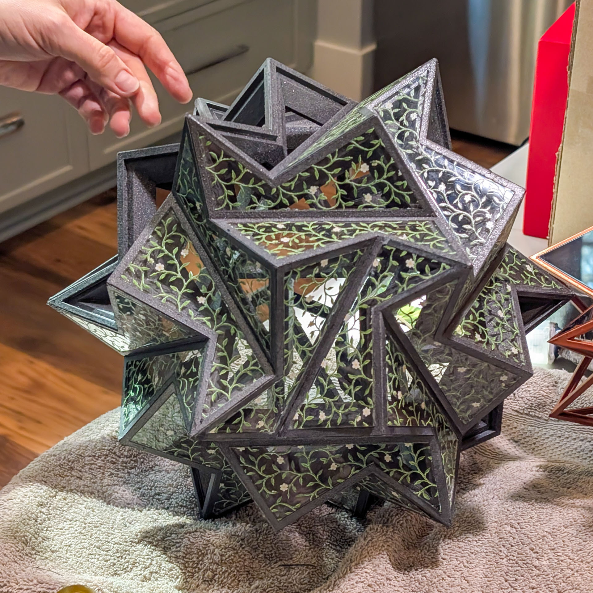

This Sawtooth Polyhedral explores the contrast between sharp, complex geometry and the softness of nature. Its dramatic, spiked form is constructed from 60 individual faces, each framed by a 3D-printed border designed to interlock with the neighboring pieces with almost LEGO-like precision.
Inset within each frame is a piece of clear laser-cut acrylic, UV printed with an intricate pattern of winding green vines and delicate flowers. The transparency of the acrylic allows the botanical pattern to appear suspended within the structure, while overlapping faces create unexpected layers of color, light, and detail as the piece is viewed from different angles.
What I especially enjoy about this design is the contradiction between its form and its surface. The sawtooth geometry is angular, pointed, and almost aggressive, while the flowing vines and tiny blossoms soften those edges and give the piece a more organic character. The result is a polyhedral that feels simultaneously mathematical and botanical, engineered and delicate.
It’s also a combination of several of my favorite fabrication techniques—3D printing, laser cutting, UV printing, and precision assembly—all coming together to transform a complicated geometric form into something that feels unexpectedly alive.

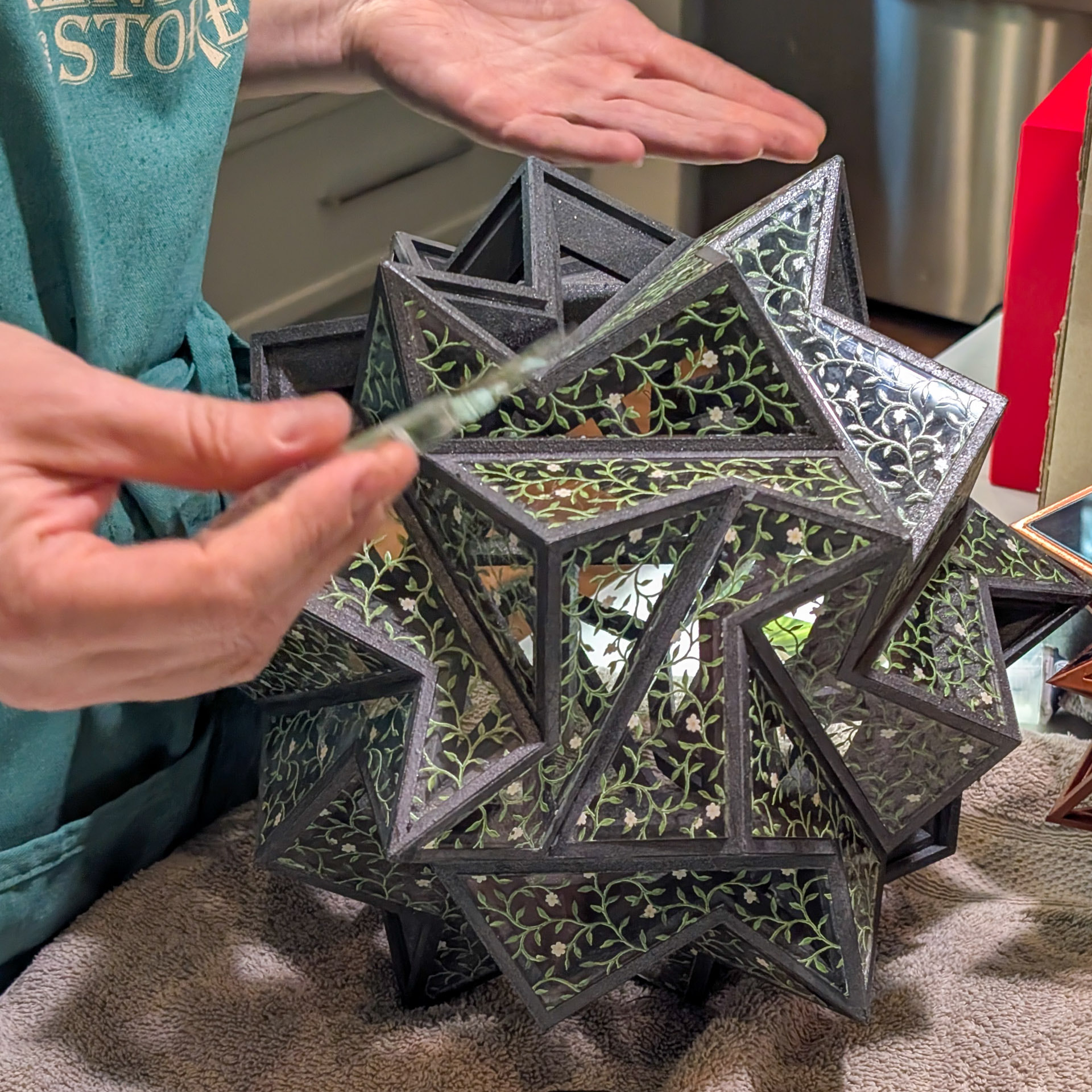

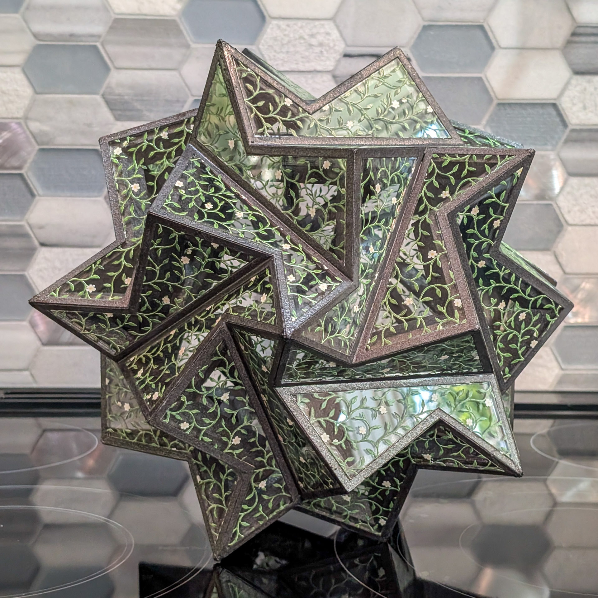

Did you UV print the designs on the back of the acrylic? Is the acrylic different thicknesses to give it more apparent depth?
No, it’s on the front.
No, it’s all 1/8" clear.

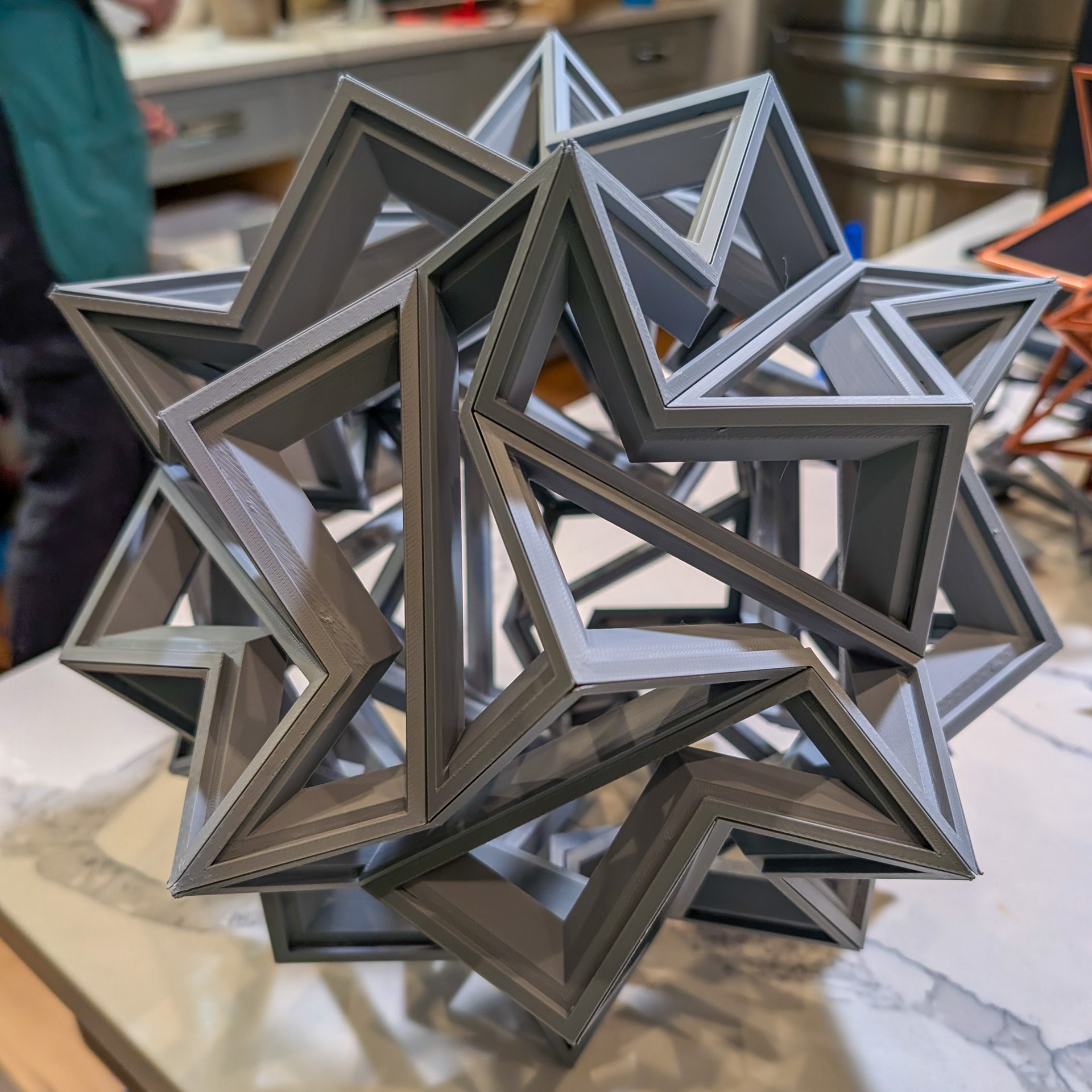

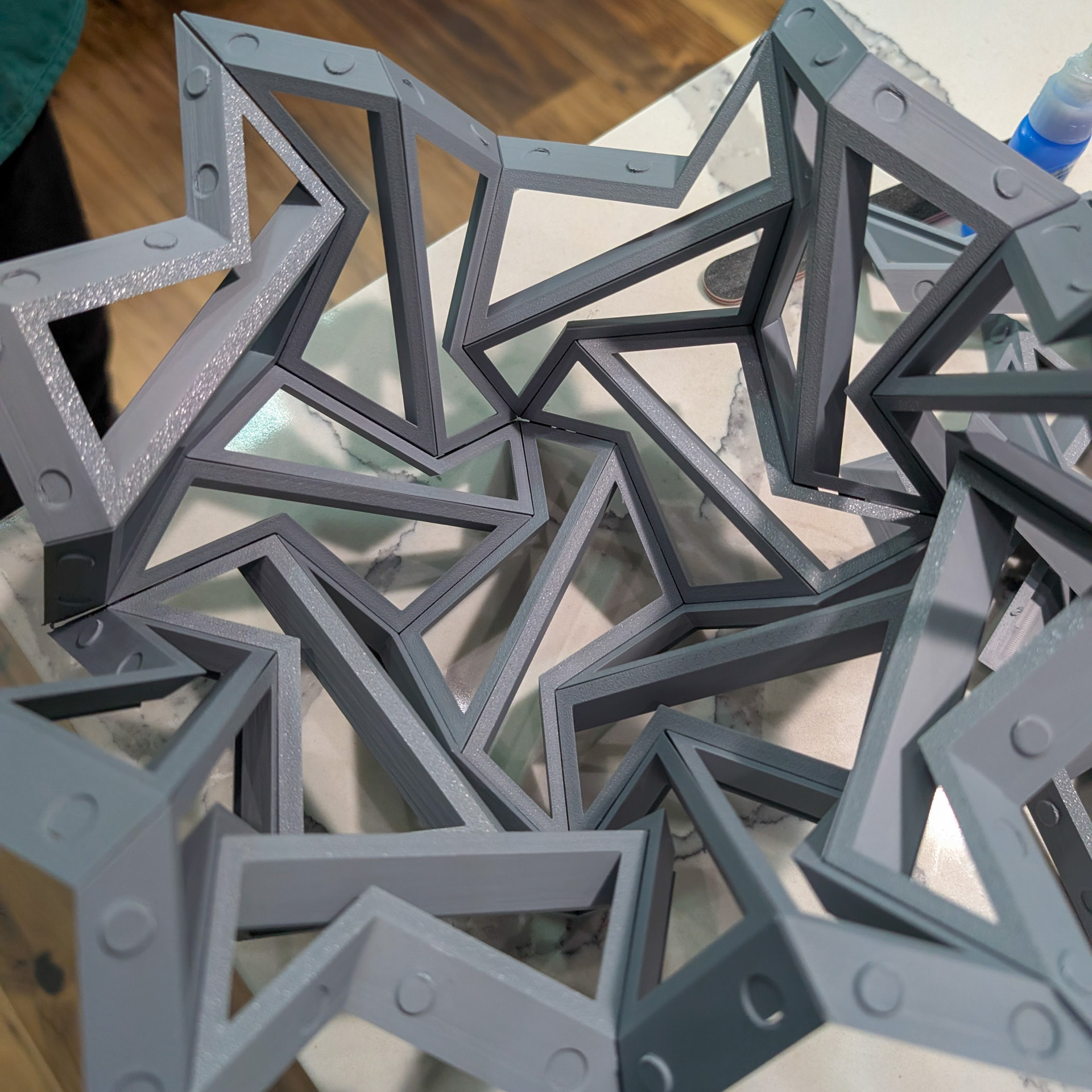

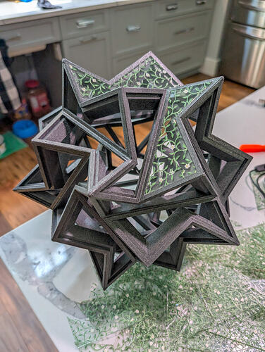

Did you spray hammered metallic paint on 3D-printed structure after assembly and before inserting the acrylic panels?
Yes. Filled in the gaps with silicon, spray painted primer, then hammered bronze spray paint.

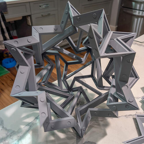

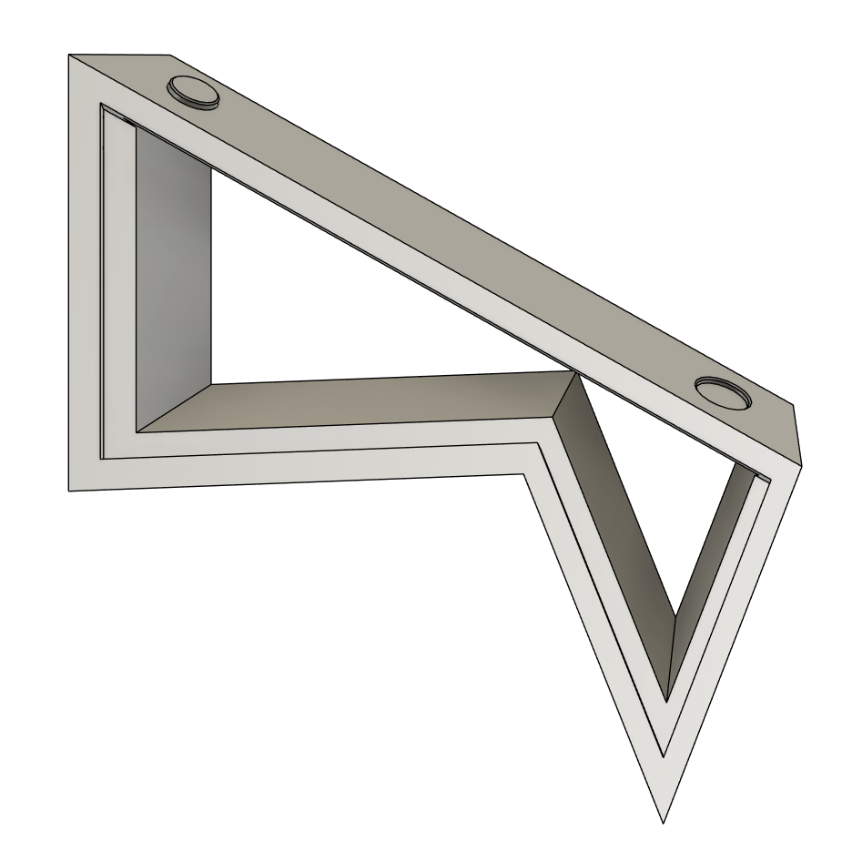

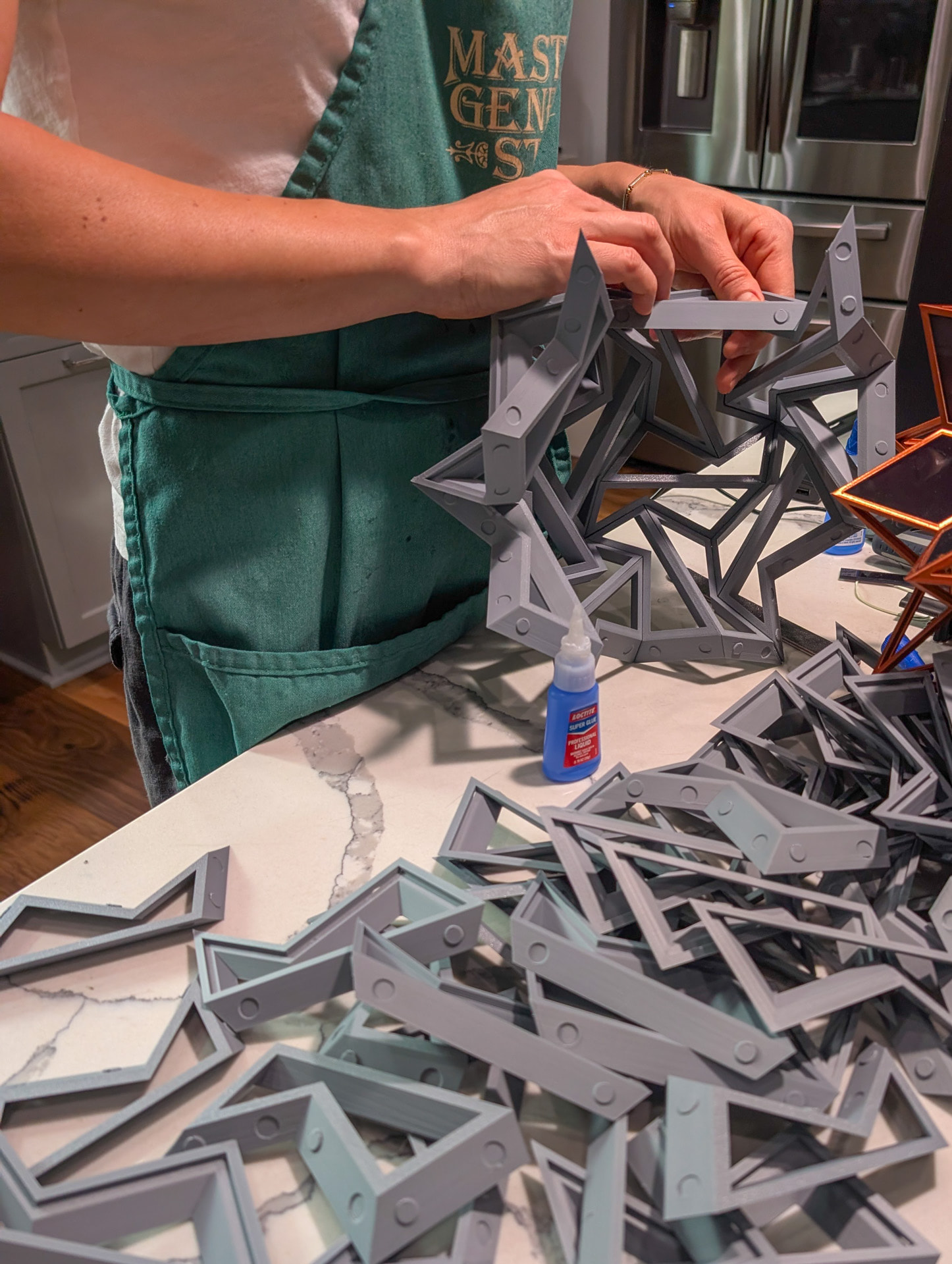

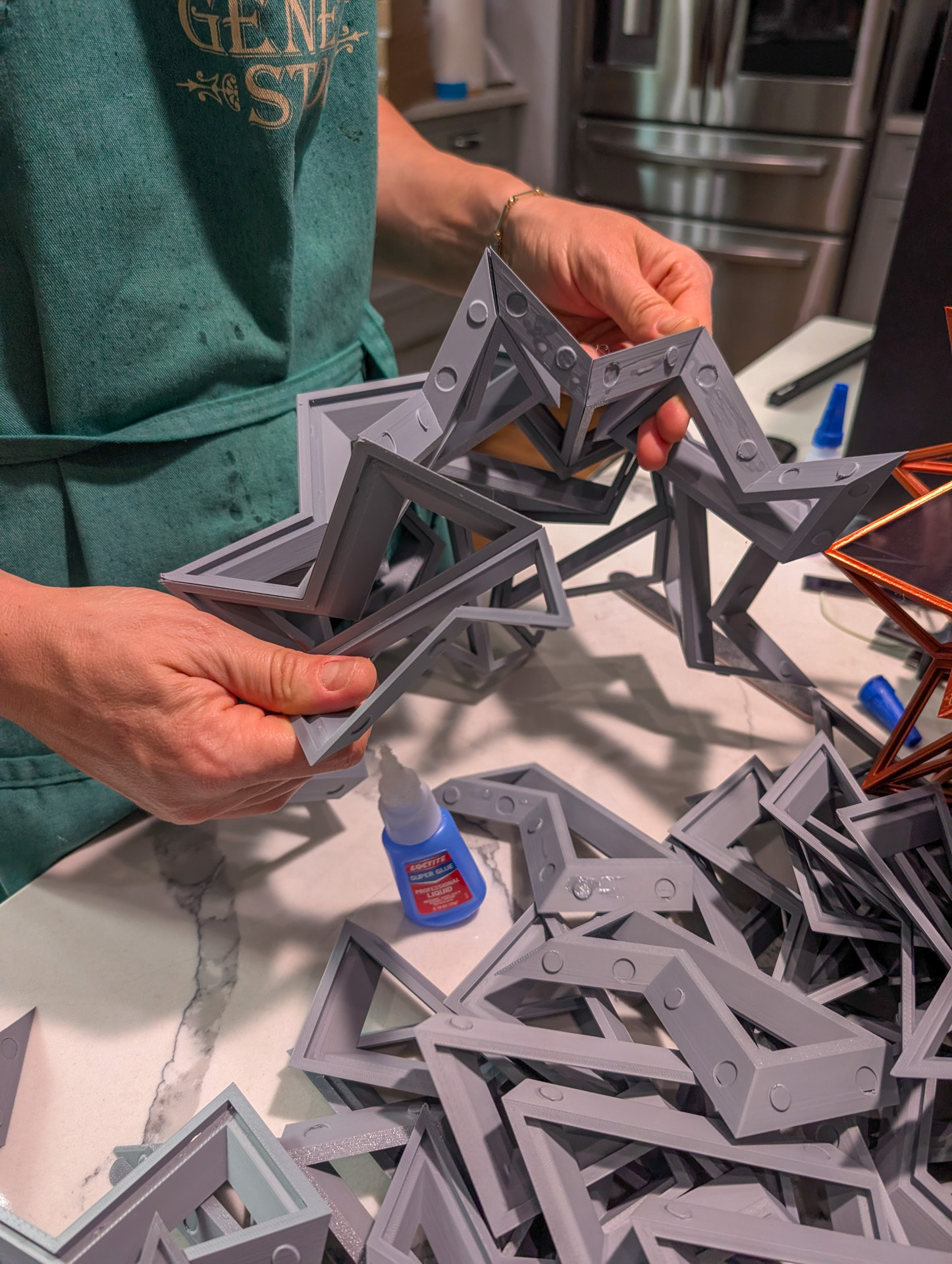

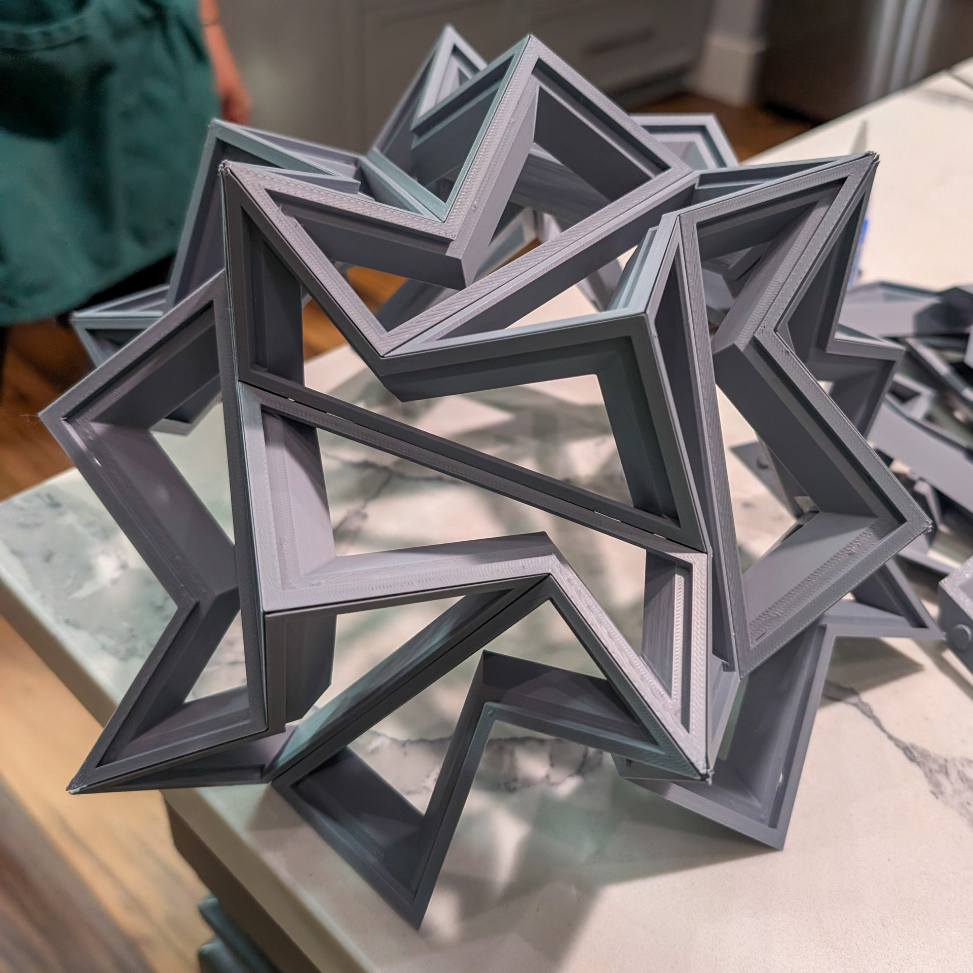

can you share how many individual unique pieces there are in the design? How was the plex installed? looks like there is an undercut…Two 3d printed pieces per panel? Amazing CAD work. What system are you using?
There are 60 of these 3D printed shapes, and I used glue to keep them together. There were small gaps in some of the edges, which were filled with silicon sealant. It was then primed and spray painted.
There are 60 acrylic faces that snap fit into each 3d printed part with no glue.
I design in Fusion 360. This particular shape was exported from a photoshop plugin called Flexify 2.0, and then imported into Fusion to manipulate. I wasn’t sure how feasible this shape would be to make due to the convex and concave angles, but it went together without much resistence.
