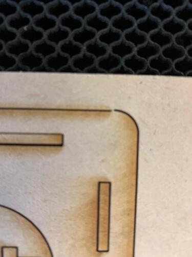

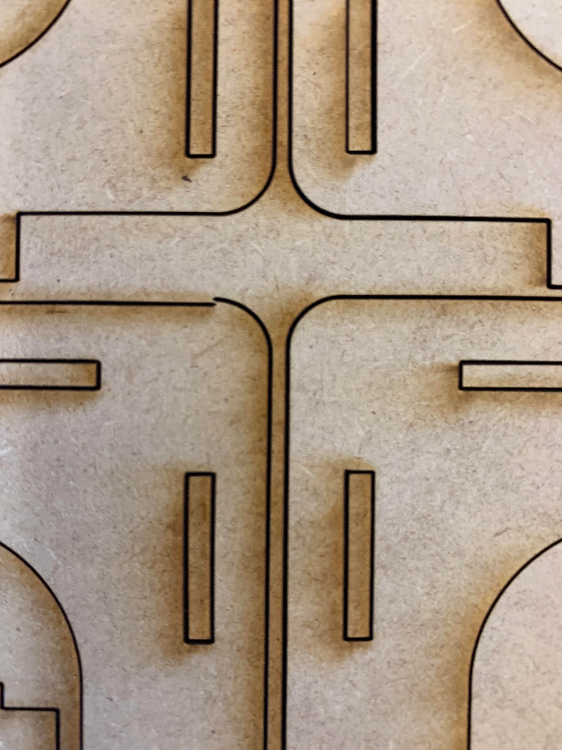

For the past little while I have experienced shifting during material cuts. It has been fairly consistent in the location of the shift. I have checked/cleaned the wheels/rails and belts. Any help would be appreciated. This is in my classroom and students are coming back to school and I’d like to get it resolved quickly.

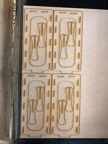

It seems odd to me that two of your items have this problem and two seem to be ok. Am I seeing that correctly?
Mirrored?
To clarify - the image you show has the shift happening in two spots, upper left and lower right. If you only put items in those two areas does the shift still happen, or is it consistent on that design?
