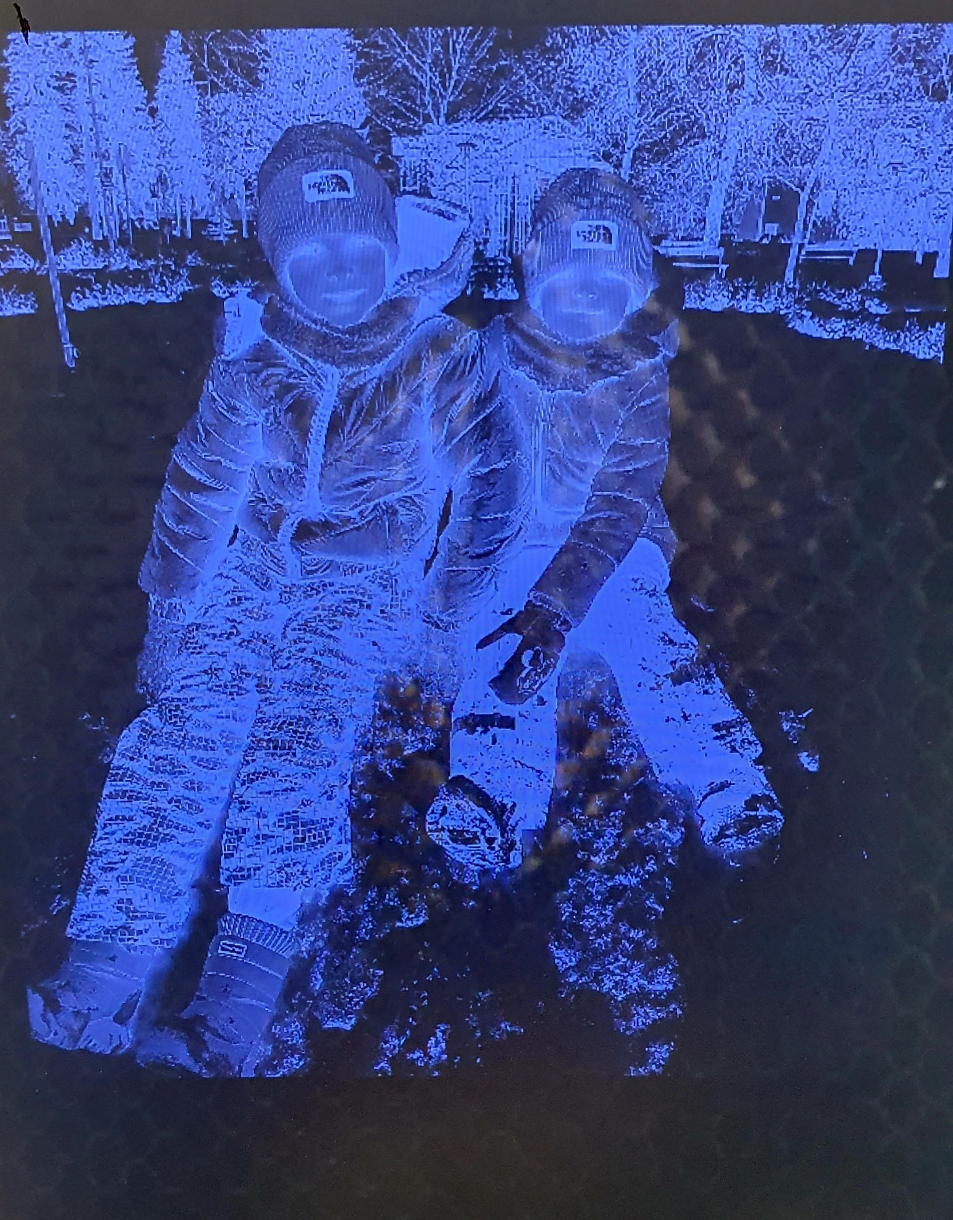

I’m trying to engrave slate, I’m using the recommended settings,
But im getting no definition on the faces, any idea what im doing wrong

Thing 1: Slate engraves white on black (ok light grey on dark grey) so it’s essentially a negative. You should invert your image before engraving.
Thing 2: slate doesn’t handle greys easily. You might get better results by using “convert to dots”.
Thing 3: in general you should prepare your images to be very contrasty before engraving. There are guides to this, check out #9 in my FAQ for more info on photo prep:
The extra half thing: not all images are great candidates for engraving. Your picture is great, captures a fun moment, I’m sure it’s a keepsake. That said the best engravable images tend to be simpler with clear subjects and uncluttered backgrounds. There’s a lot happening here, it may not be the ideal image to try, especially on a material like slate where greys are hard to capture.
Ok one more tiny thing: as you test again, you can sand slate down to get a fresh surface. A good way to save material as you get it dialed in.
OK, ok one tiny tiny last thing: slate can be enhanced by wiping it with mineral oil before engraving. Helps the contrast. Use a tiny bit, wipe it on and off so that it’s dry and then engrave.
Good luck!

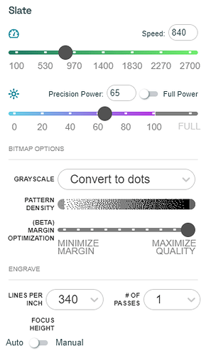

You may also wish to consider a higher lines per inch to get as much detail as possible.

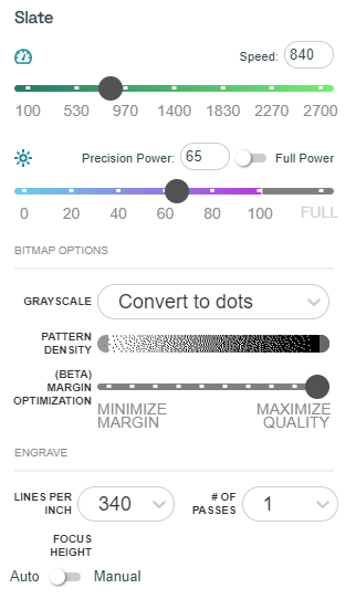

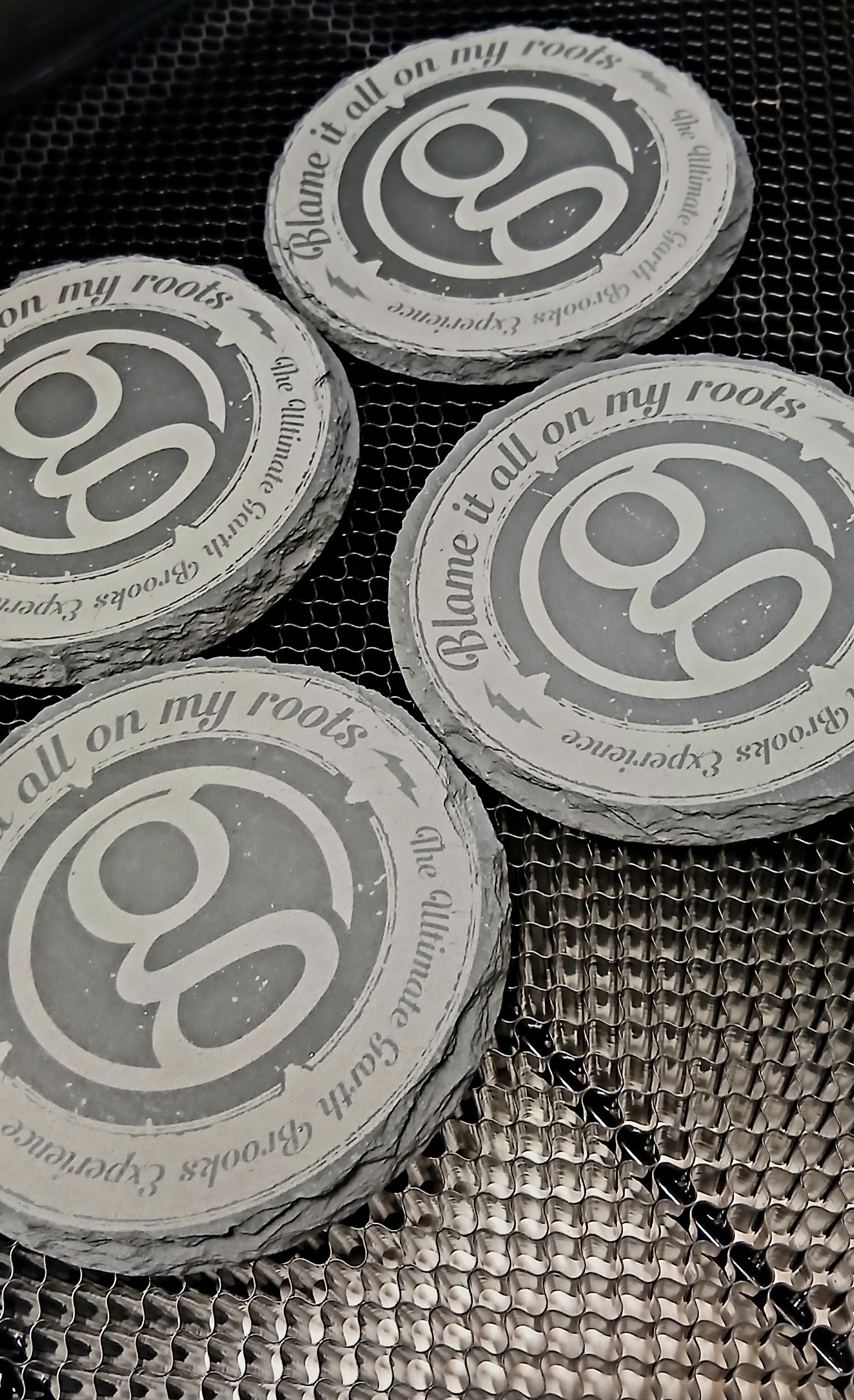

I use these settings to engrave slate. I prepare the slate with shellac to make the black more pronounce and in most cases, I invert the image

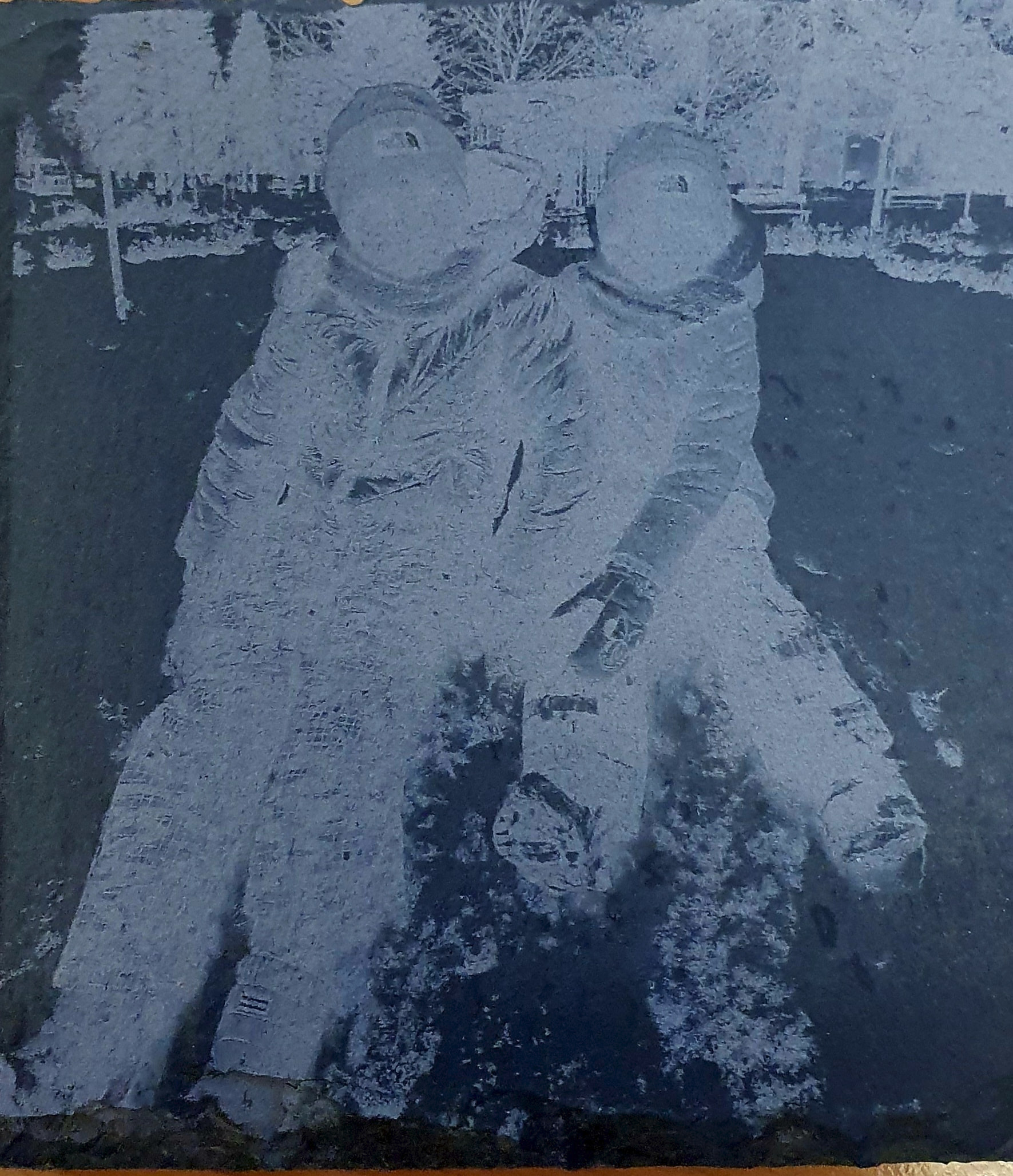

I’m still playing with settings at the moment, switched onto pens, note books and other stuff.
Managed to get something engraved without as much detail

got some slate etched. Thanks to all for the advice
Decided to do it as a line type drawing, turned out pretty good.
