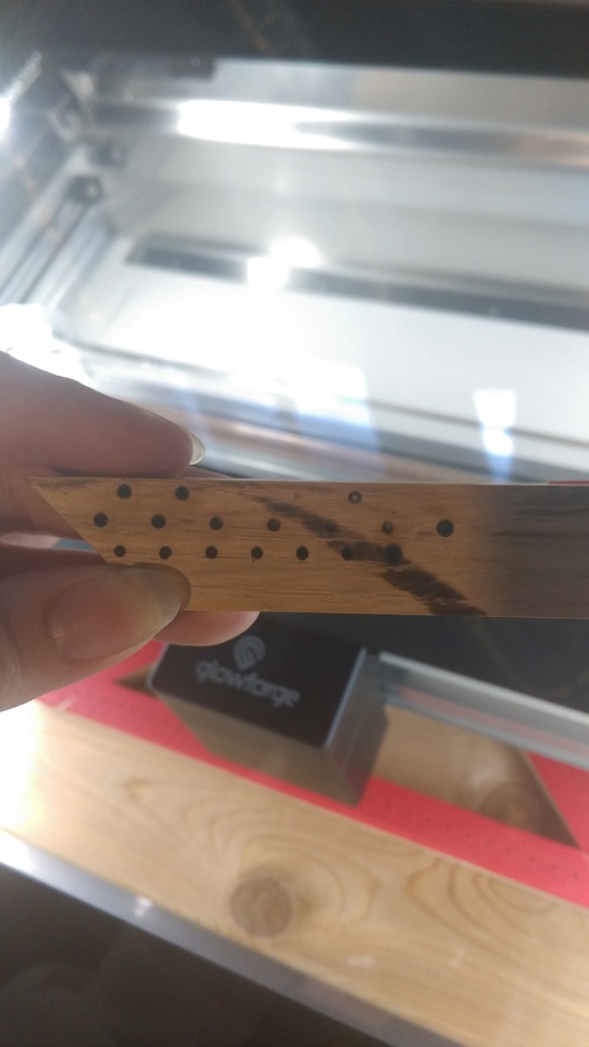

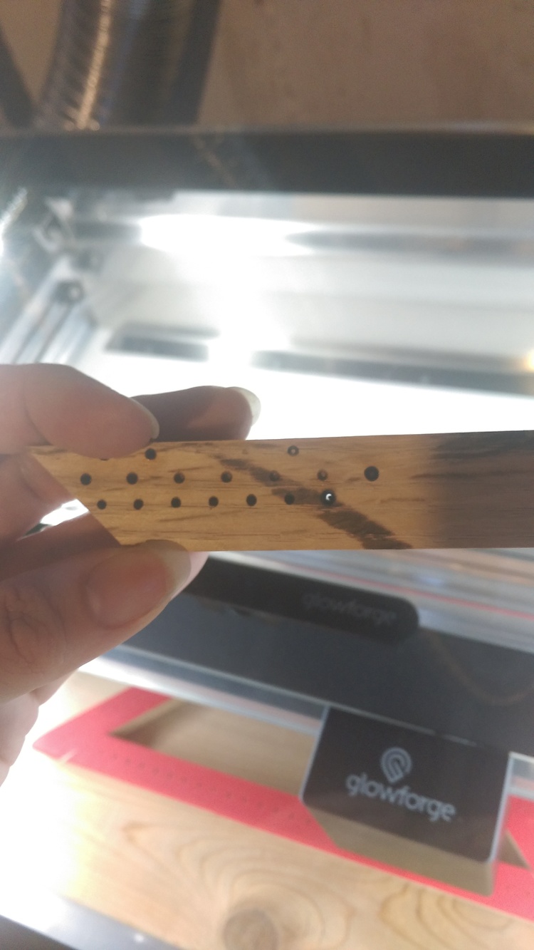

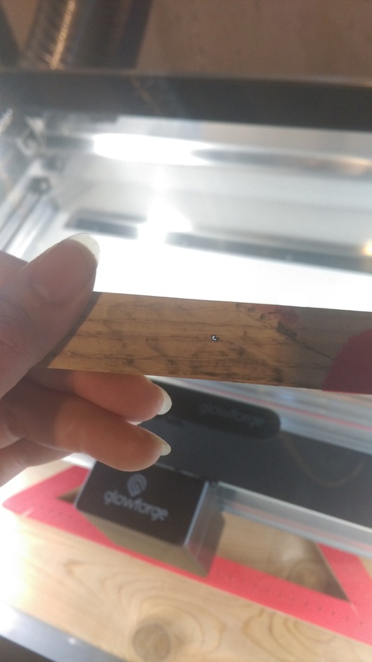

Guys, I am so impressed with this laser I just had to share! I’m working on a few triangle pin looms (and having a helluva time getting the alignment perfect, but that’s another topic), and so I was testing out engrave depths for the many nail holes. I threw a scrap piece of oak in the Glowforge, and figured, what the heck, let’s make one hole a cut, just for ****s n giggles. Well, this is oak, and it’s over a half an inch thick. Look at the photos. Look at them!!!
IMAG1232
WHAAAAAT?!?! The laser made it through, in one pass, at full power and lowest speed!! I was not expecting that, and am ridiculously impressed!
I don’t know if anyone else had tried thick wood like this…if so, I’d love to see what you did! This was also on a basic machine.

This is 3/4 " oak, same as you, full/slowest.
You can see the different level of penetration between the hard and soft grain.
That’s a pretty neat side shot. I’m guessing it didn’t make it all the way through and you cut the rest to look inside…? Yea? Or did it actually make it through that???
Edit - Actually, now that I’ve thought about this, it obviously didn’t make it through since you can see where the laser actually was. haha. Sometimes my brain doesn’t work so good eh.
I don’t usually talk about it, but I did a 3/4" engrave on my Basic once. Also measured the depth of the engrave with my calipers.
But the reason I don’t talk about it is because, at those settings, I don’t think it was the safest thing in the world. The air assist kept the flames totally at bay, but still.
I tried a thick engrave on this too…I was trying to do the half lap joints so I didn’t have to do them on the table saw. Flames, yes. Lots of them, and a charred mess at the end. The engrave wasn’t 3/4" tho. Brave man! ha!
No, it didn’t cut through. I finished it with a coping saw just to get a look at it.
