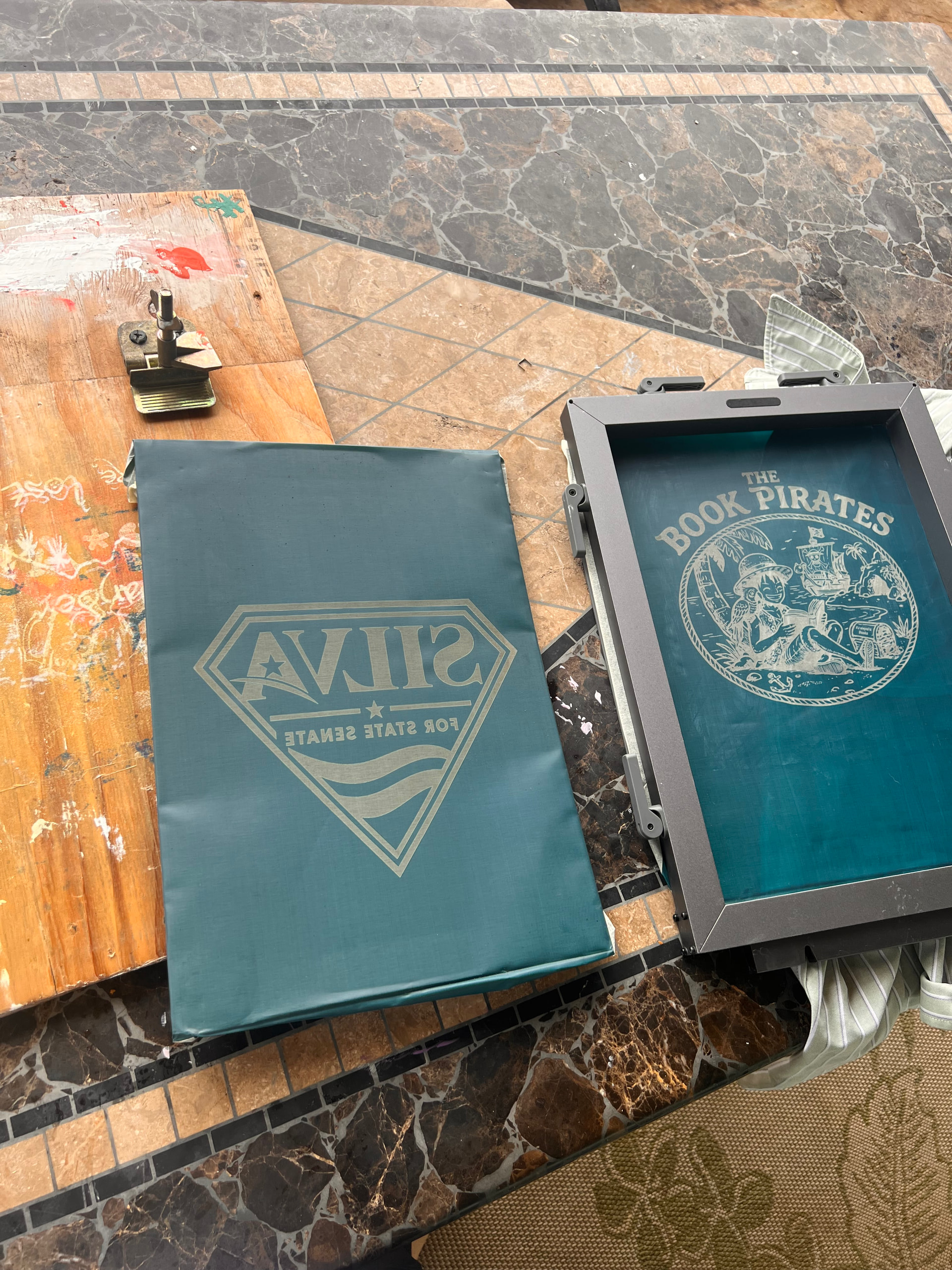

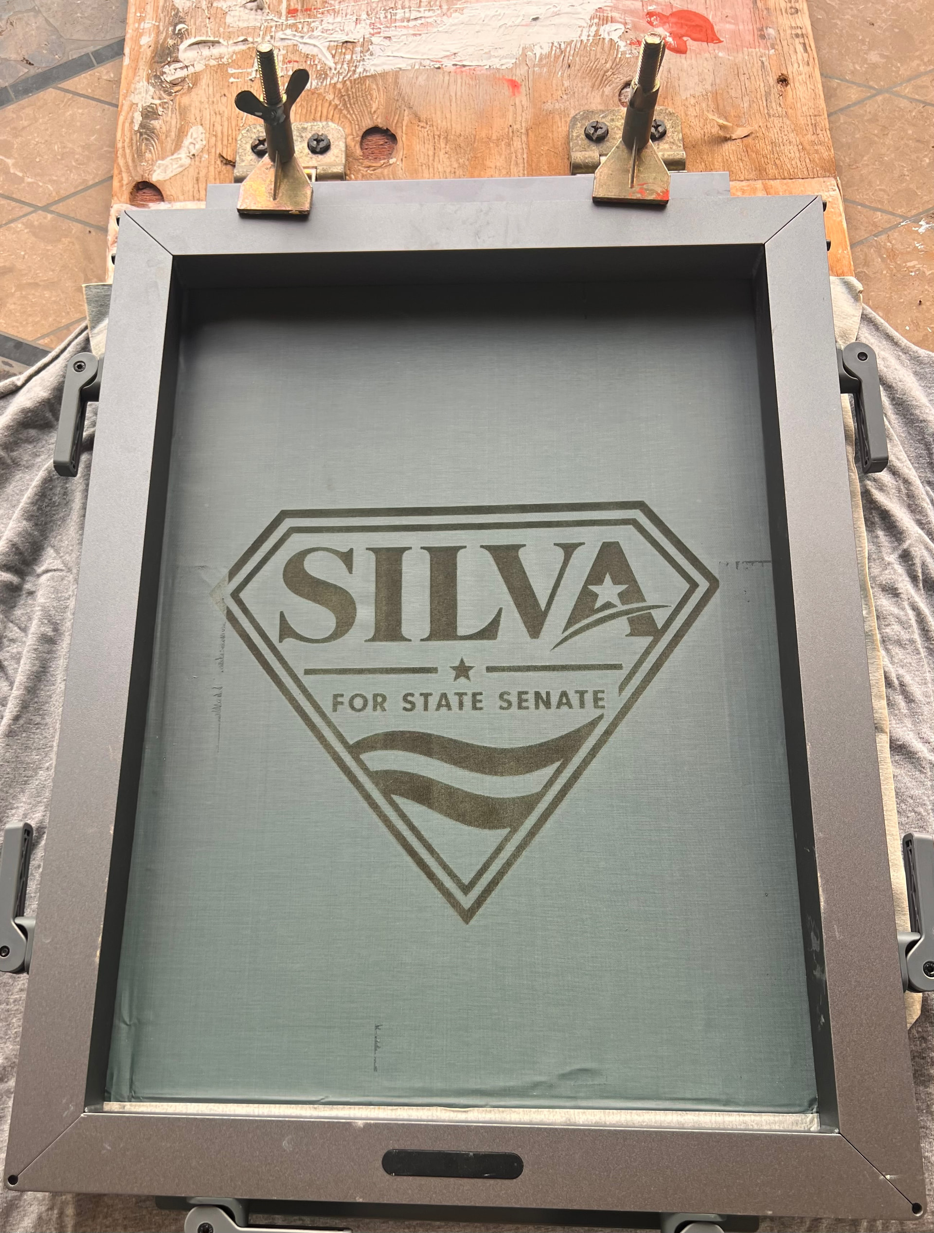

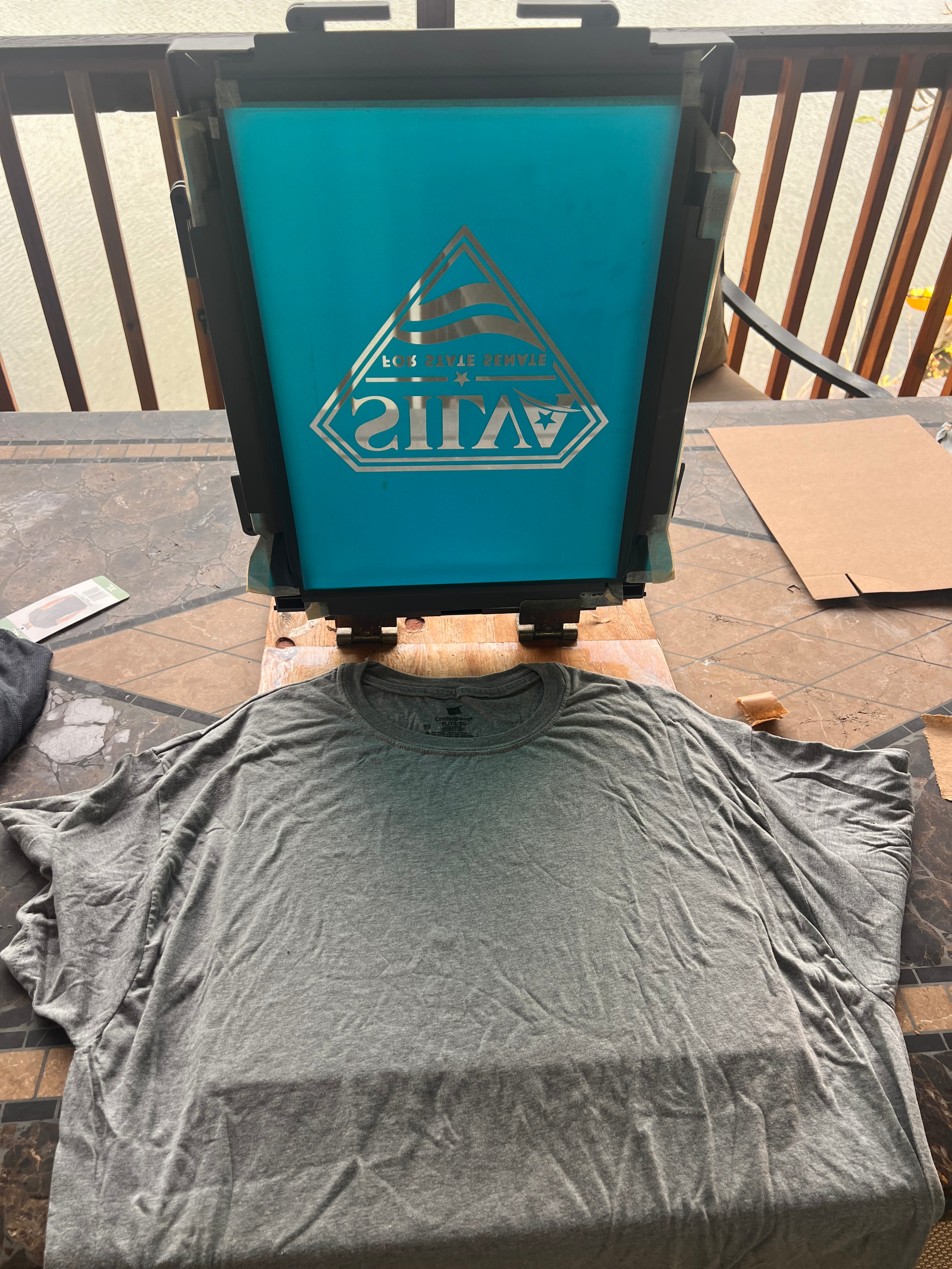

My friend is running for state senate, and asked if we could make some shirts, so last weekend I used the :glowforge: to make a screen on the xtool screen / frame that I got (i never bought the xtool laser but this screen mechanism is just awesome. Hand making wooden screens and stapling the tar out of them made my resistance to starting a screenprint very high)
they came out great, but I didn’t let them dry overnight and tossed them in the oven wet at 310F for 4 min rotating at 2 min, which usually works great and did dry them, but my shirt bled a little in the wash. When it air dries overnight that recipe has lead to colours that don’t bleed.

I only purchased the screen and the frame, not the whole kit, but in retrospect I probably should’ve bought the whole kit. You can just throw the screen into the Glowforge and zap away the coating. I honestly don’t remember the settings I found them on here!
