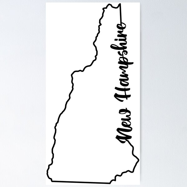

This is the artwork I was using and getting the ‘no artwork’ message. I am so new to Glowforge that finding the info I need is like searching for a needle in a haystack.

As @wesleyjames said, if the artwork isn’t inside the boundary areas, it will say ‘no artwork’. If your attached image is a jpeg, it will only engrave anyway…not cut. To be able to cut out images, they need to either be vectors or at least have a vector cutting line around them.
The item you attached is a jpg which the Glowforge will engrave but not cut. There are two types of files - raster and vector. To cut/score, you need vectors.
Not only that, but even if it was cut, the 'H" and dot on the “i” would just drop away, and the lines joining the letter in the rest of the text would be impossibly thin. The resulting part would be unable to support its own weight.
If you have Premium, you can generate a vector cut line using the Outline function (the icon looks like a mountain). It’s possible your artwork is too tall and part of it isn’t fitting within the engravable/cuttable area, which would generate the No Artwork message. Try rotating the design 90 degrees. You can also get that message if you have not yet chosen a material and set the parameters for the operation (cut, engrave, or score).
