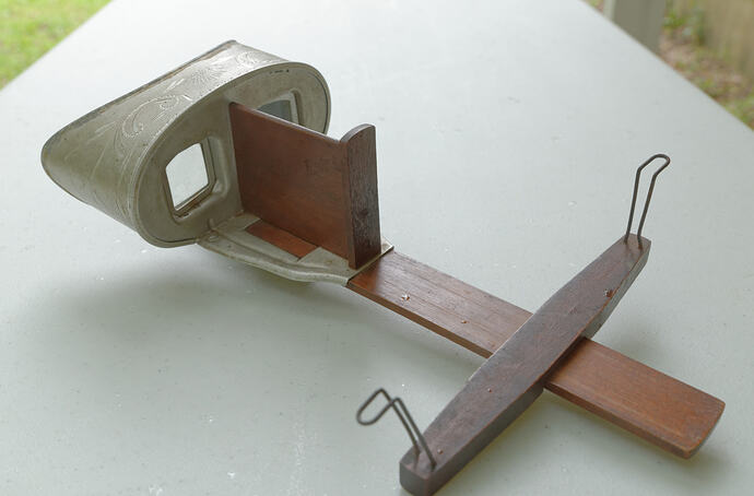

On the ride back from the monument I got to thinking about how to view the shots I’d taken and decided I’d build a Holmes stereoscope – one of those Victorian VR headsets that use pairs of photos mounted on cards:

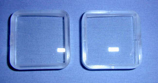

When we were back in in town that evening, I went looking for a source for stereoscope lenses. Oh, the internet is a great thing. Almost immediately I came across Berezin Stereo Photography Products (berezin.com). And yup, they sell 'em. Glass for $60 a pair, or plastic for $20. By the time we’d wrapped up our adventure and I made it back home, the plastic lenses were waiting for me.

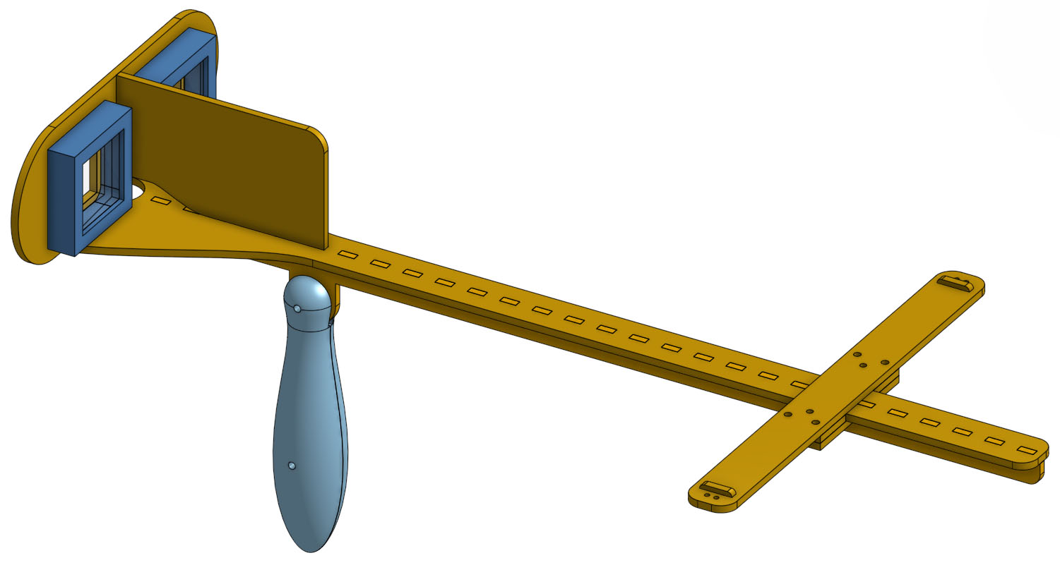

I formatted a bunch of my photo pairs to fit on cards the same size and shape as the ones used on the old stereoscopes and printed them out. Then I set about designing my stereoscope to fit the cards and the lenses I’d bought. Here’s what I came up with:

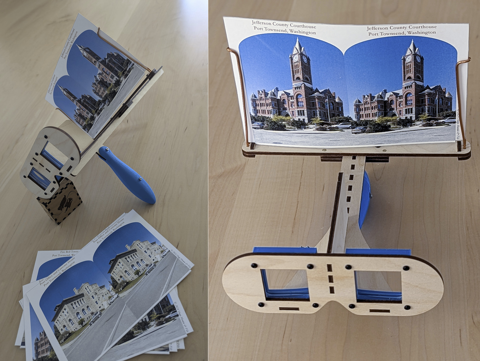

As you can see, much of is GF output, but it’s been strategically augmented with 3D printed parts.
It works a treat! For landscapes, I still take stereo pairs. When I get a batch, I turn them into new cards.
