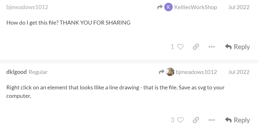

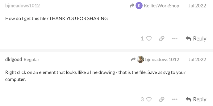

After searching the forum I found this if you are willing to try it.
