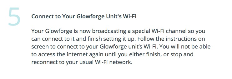

I think I’ve done a good job of setting it up
I’m on this step in the directions:
It says, “follow the directions on the screen to connect…”
WHICH screen?
My Android phone is connected to the wifi being broadcast by the glowforge.
but nothing changed on screen. Also tried it with my Mac…
do I need to download an app?
the screen on the machine? Does it even have a screen?
It’s a very beautiful machine
feeling pretty dumb…

Using a browser on your phone while the phone is connected to the ad hoc network broadcast by the Glowforge, go to setup.glowforge.com.

that was my hunch, @marmak3261 … but I just tried again, and I get the Chrome dinosaur and it says, “you are offline”.
and of course, I am.
since I have airplane mode on and the printer can’t possibly be connected to my network.

I’m sorry to hear you hit a snag during setup, and I’m happy to help. Could you please try the following for me?
  1. Turn your Glowforge off
  2. Make sure you are connected to your usual Wi-Fi network, and navigate to app.glowforge.com/setup using your browser
  3. Turn your Glowforge back on. If the button isn’t glowing teal, press and hold the button for at least ten seconds. Once it is glowing teal, let go
  4. Choose “Continue” in your browser
  5. Follow the instructions onscreen to complete Wi-Fi setup
I hope this helps! If you run into any trouble, please let me know.

it worked
the 14 second restart was the secret
