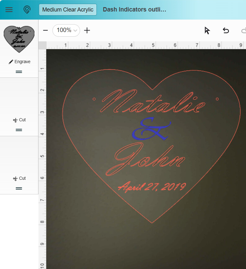

Starting today, my GF Pro is not importing files correctly.
When I import any SVG it’s doing two things:
  1. It converts elements with a fill to what appears like a negative bitmap. This occurs with any file I upload, including files that have printed correctly as recently as last week.
  2. It also does not show a preview of the other layers that are a stroke, nor do they print.
I opened several older projects from ‘My Designs’ with similar attributes and they opened correctly. But when I upload any of those same files as a new project, it loads incorrectly as described above.
I have rebooted both the computer and the GF and reloaded the browser page to no avail.

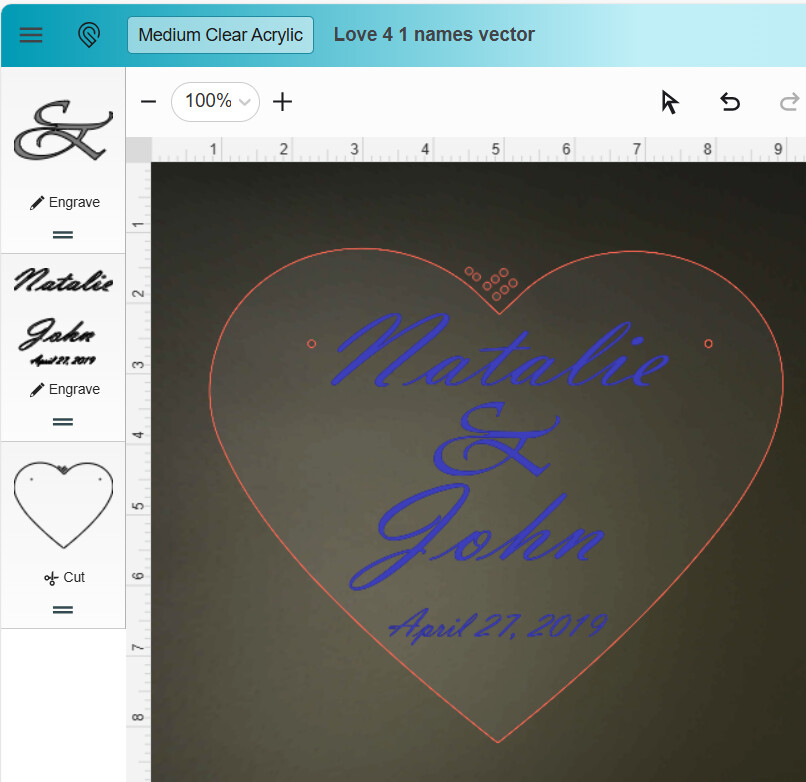

As an example, attached is a screenshot of what the workspace looks like and the file that I uploaded. In it, the lettering is vector art with a fill. The heart shape and small circles are strokes. There is not now, nor ever was a bitmap image or scan in this file, nor any non-printing layers
fwiw, I’m working on a Lenovo Win11 laptop, in the Edge browser - which has worked fine until now. I also tried in the DuckDuckGo browser with the same results.
For comparison, here is a screenshot of the original project from ‘My Designs’, which still loads correctly.

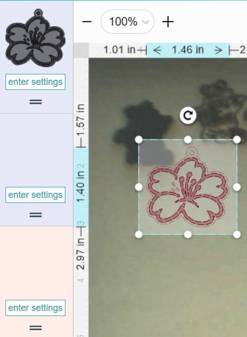

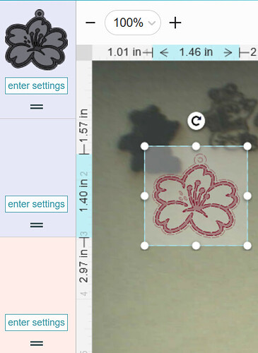

I had an issue about 8 hours ago or so. I had an engrave logo, but I had words in the middle that were not to be engraved. It worked a few days ago, but this time when I loaded it again, the entire center was engraved over, but if I changed it to score or cut, the spot that wasn’t supposed to be engraved showed up. Refreshing my browser didn’t work and reloading the file didn’t work.
Anyways, it was weird, but I deleted everything from the UI, went to my file and duplicated it and moved the duplicate to another part of the file. Saved it, then refreshed my browser again. Uploaded it, and both the duplicate and the original showed up properly. There was nothing wrong with my file. It was just doing something weird in the interface.
This is what I mean by not engraving the middle.
Thanks for the suggestions. Firefox is not compatible with this computer, but I’ve used both Edge and DuckDuckGo with the same results. I also changed the material - no change. Not sure what you mean by resetting the file, but I’ve deleted the art, reuploaded the art to the same project, and created a new project with the same file, all with the same result.
There is new behavior that I’ll elaborate on in a separate reply.
Yeah, that is weird. Wonder if it’s the same issue. In my issue, it is flattening and making negative any object with a fill. I haven’t tried going back to inkscape to dupe the file, but the one that I tried first was a dupe on another file with edits. Might have to try that again
Okay, now we have some new behavior. After dlkgood suggest Firefox, which I don’t have, I decided to try Chrome on my Chromebook.
This time, if I opened the file as a new project, it looks normal. (yay!) But…
If I add an svg to an existing project workspace, it still loads with the same issue. (dang)
Since it worked on the Chromebook, I decided to go back to the PC and see if I could do the same there (which I could not yesterday). Guess what? It worked just like on the Chromebook.
So the behavior is changing, but at least it seems that I have a work around by creating a new project for each file rather than loading it into an exiting project. If I want to gang images together, I’ll have to do it in inkscape - at least for the time being.
