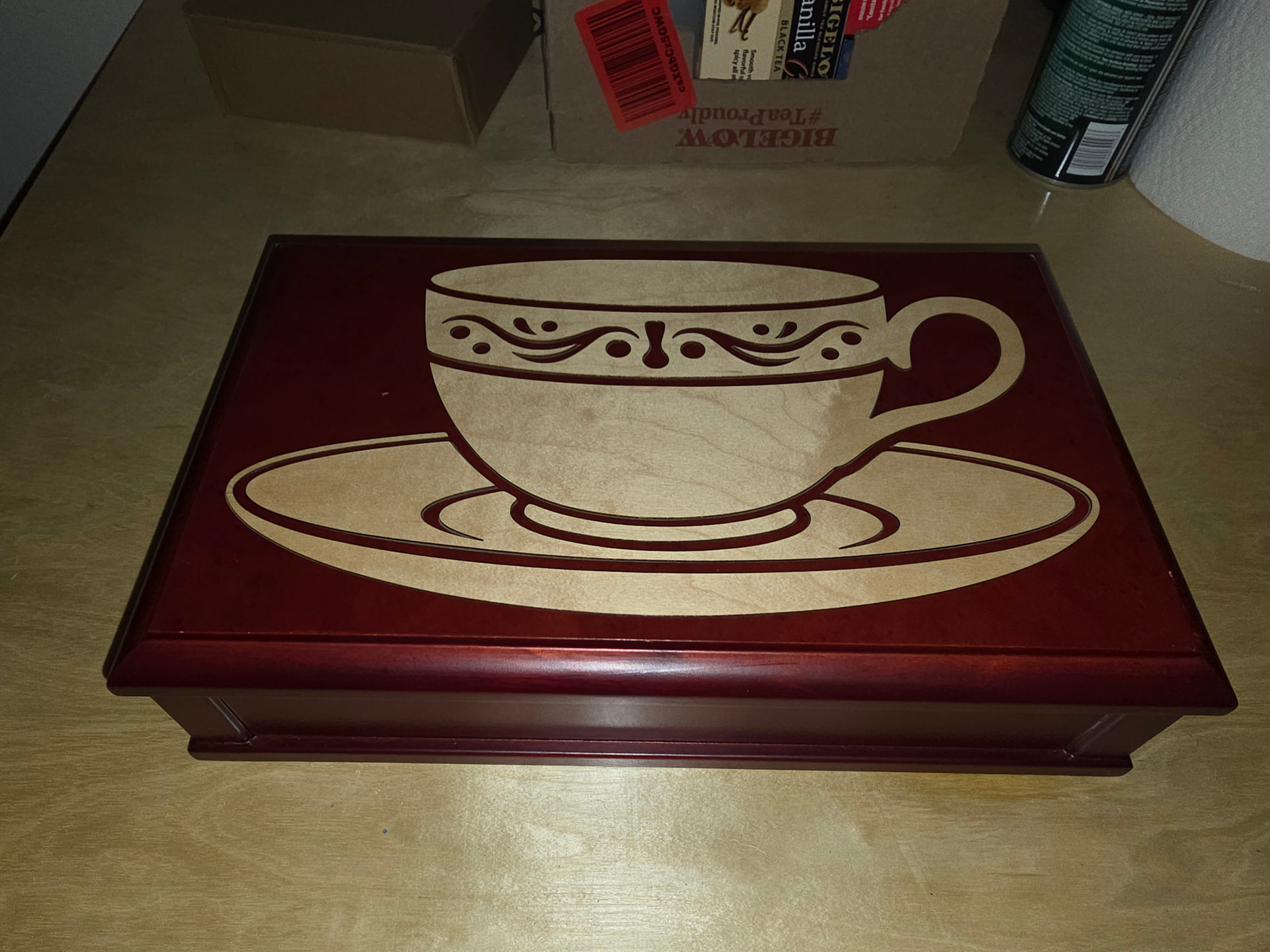

Tea Chest for my Mother for her Birthday
My mother has always had time for a cup of tea and good book.
I received the bare Bigelow tea chest from a friend and I thought; with a little work this could be nice.

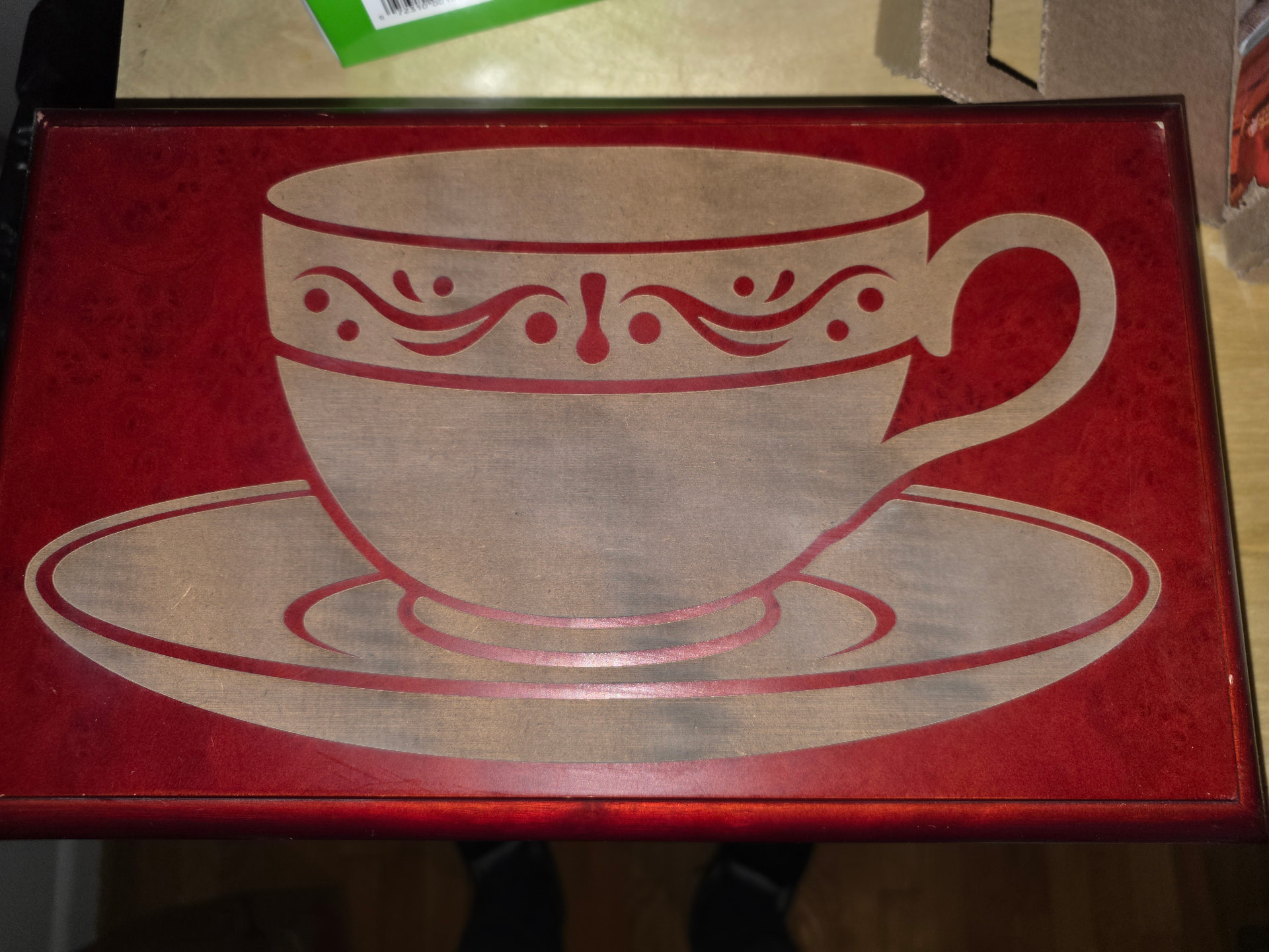

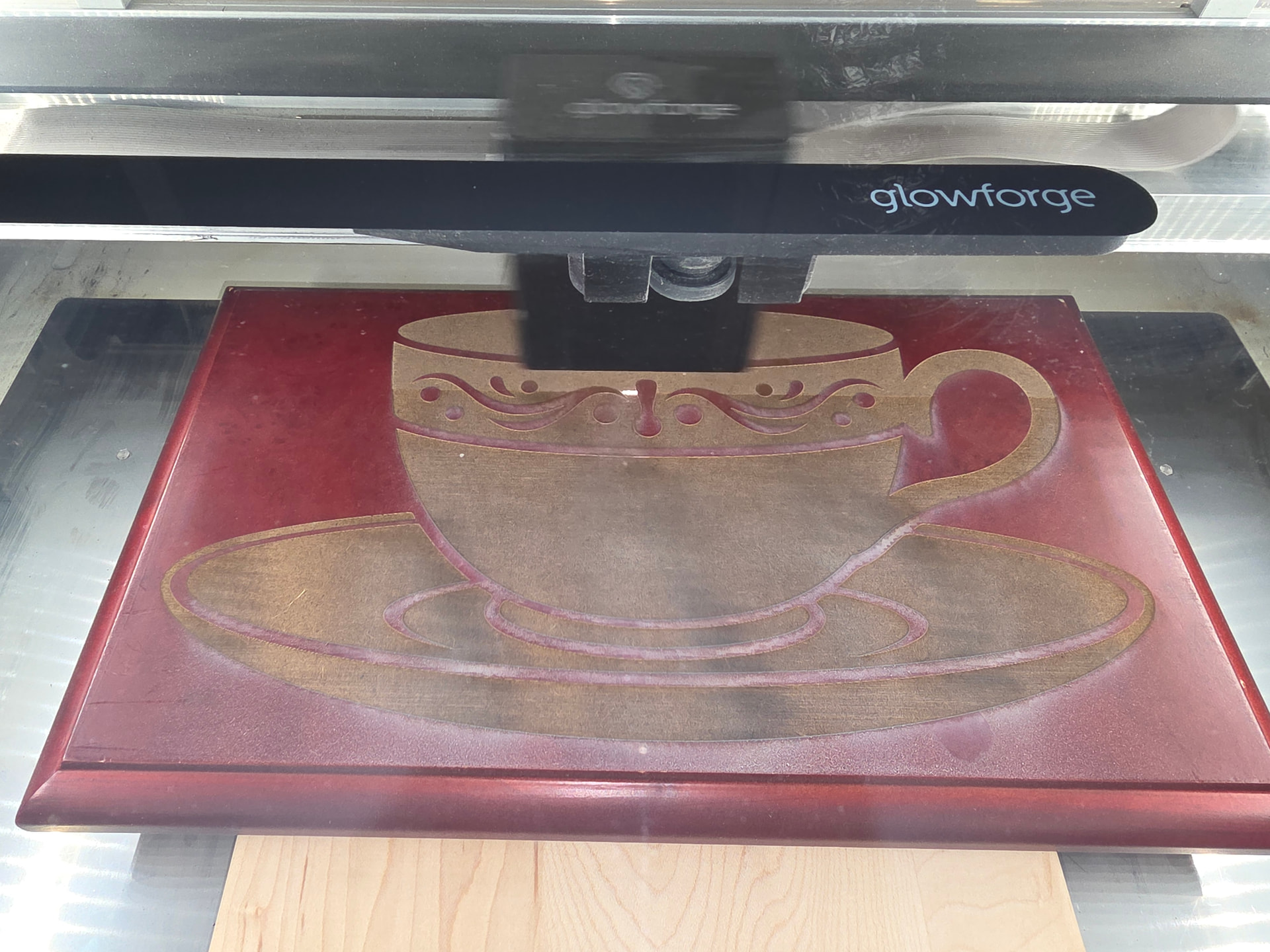

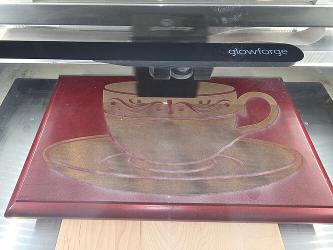

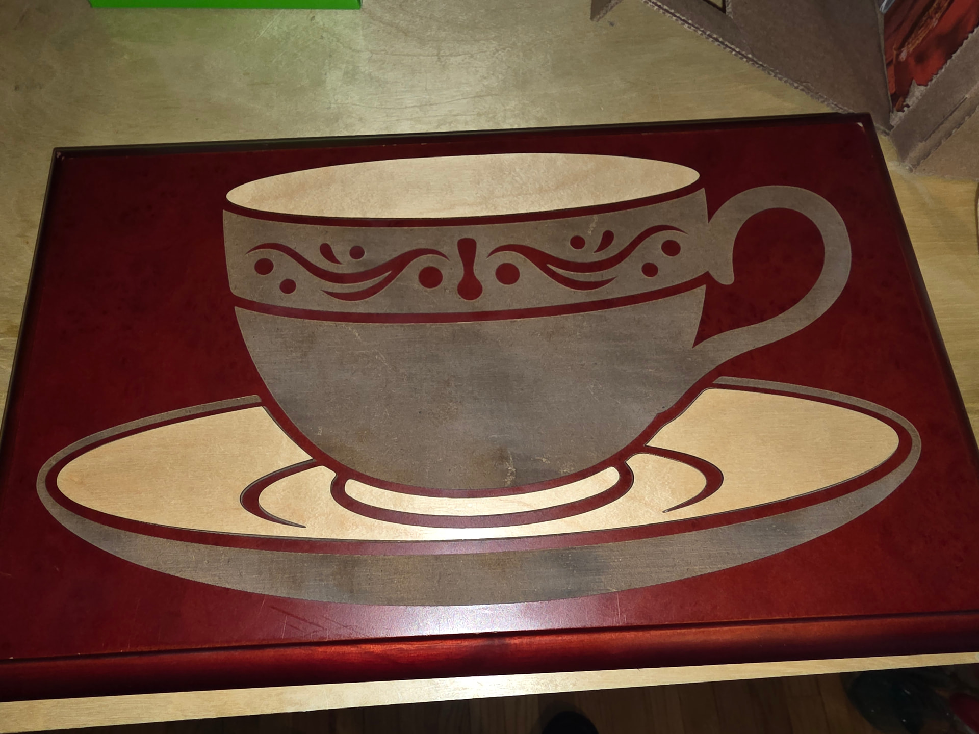

Engraving away the varnish to make room for the Maple veneer.
Took 5 passes until I was happy with the depth. I wanted the veneer to be inset but not flush.

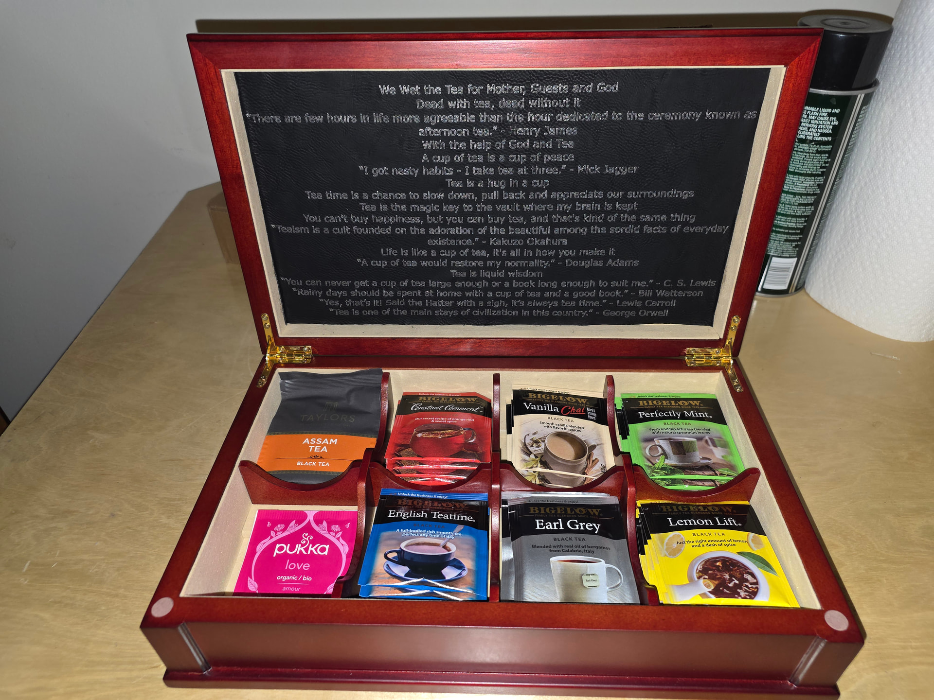

The top liner is faux leather run at 500line 1000/20 to get the silvery effect.
Someone mentioned that a color splash would make it perfect and after a little thought I agreed.
I ordered some abalone shell from Maui to finish the project.
I think the blue makes it POP! Don’t you?:smiley:

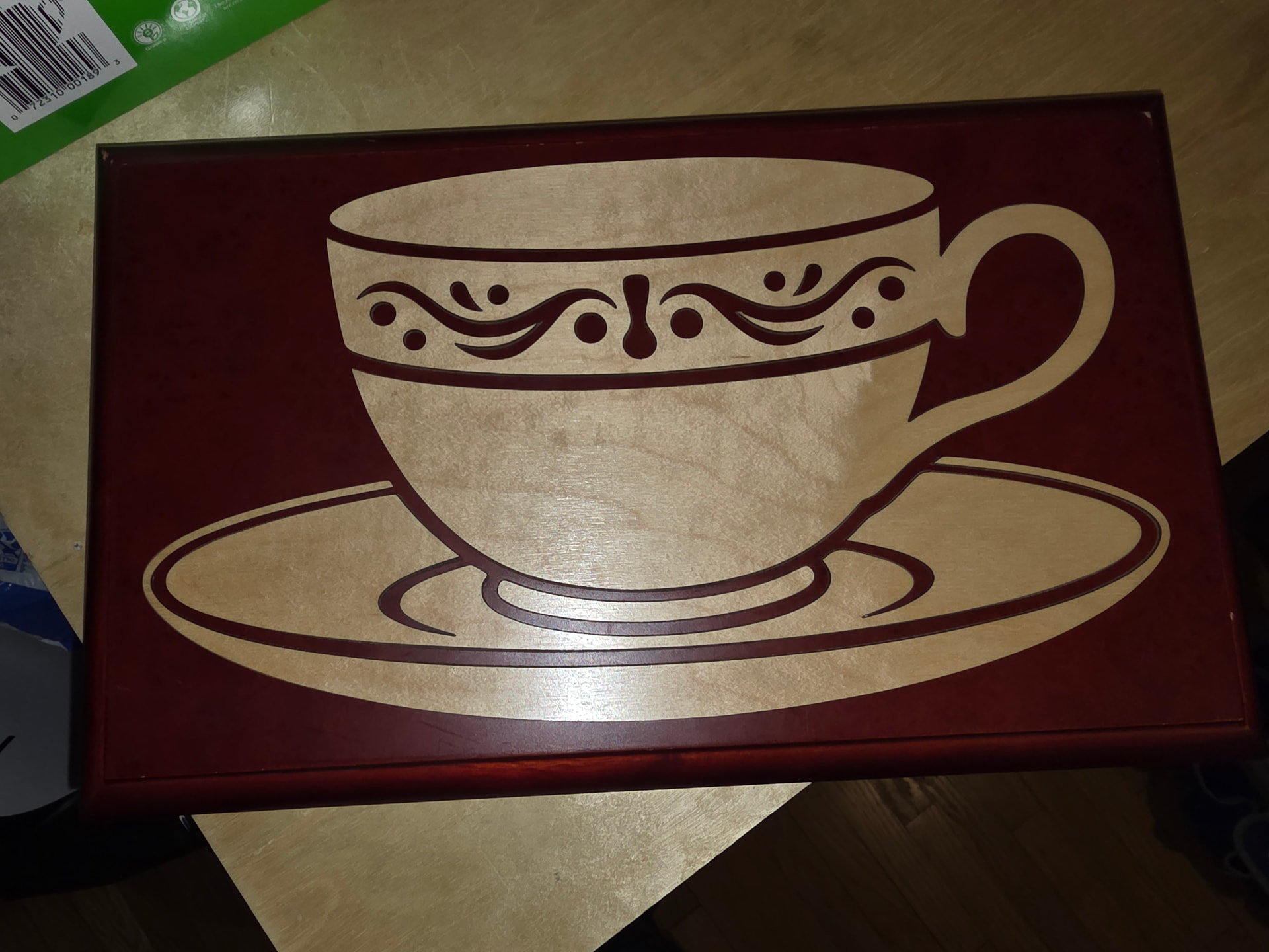

Looks amazing. The alignment looks spot on. I’m always nervous about getting things lined up properly without the crumb tray in.

Oh my, what a nice job! You really gave it a luxe look. She will be delighted!

That turned out beautiful! I really like the design of the cup, and the sayings on the inside! Your mom is really going to enjoy opening it with every cup of tea she drinks! Thanks for sharing your work with us.

First, I must say that your mother has a treasure in you! Beautiful job on the inlay and the liner. Not sure how you’ll top such an exquisite gift next year though!

Gorgeous! Is the pattern on the teacup personal?

Found it online. Cleaned it up with inkscape

I though exposing the wood by engraving away the varnish looked great, but applying veneer just took it to a whole new level @guyverchaz, and the inside inscription is inspiring.
