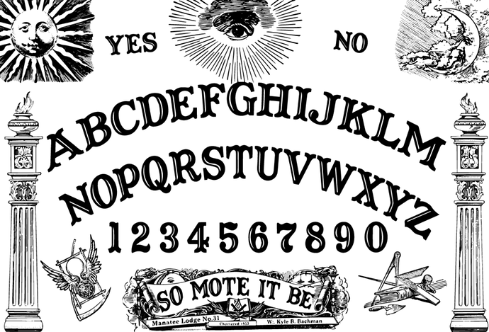

Been trying to engrave this fairly detailed black and white images. Its not nearly as complex as the Halloween ones featured by dan on facebook recently or anything as complex as the 3d engraving people have been doing. I find that If i keep the design the size of a credit card its no problem, but the moment I go any larger then that It loads and loads and loads till it finally gives the “Unable to process, try again later, or contact support” message. I was really hoping to cut this out as a functional piece for some Halloween fun Monday.
Any one else running into issues with larger designs? or any tips on how to get this cut.
I’ve tried several formats, ive tried raster vs vector, ive tried different levels of detail. Individually each section will print but the moment i try as a whole ERROR…

I tried your PNG image at 10, 35, 75, & 195 Lines per inch. Loaded fine for those resolutions. At 195 it would take 76 minutes to print. Couldn’t get it to load at any higher resolution though it should have been well under the ~3 hour buffer size up to 340 LPI.
Your image default physical size is greater than 9" x 12".

I took your file above and played with it for a couple of minutes I made it slightly smaller to fit a 12 x 20 artboard (but it’s still too big for current GF engraving limits). It loads fairly quick into the GFUI with 1 error that can be ignored. I didn’t turn on the machine to see how long to process.
Converted to vector via image trace, added some colors to break up engraves and drew a box around the whole thing you can ignore when engraving (or use as a cut). Anyway, all for illustrative purposes. Have fun
