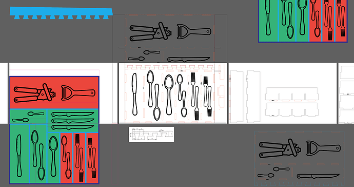

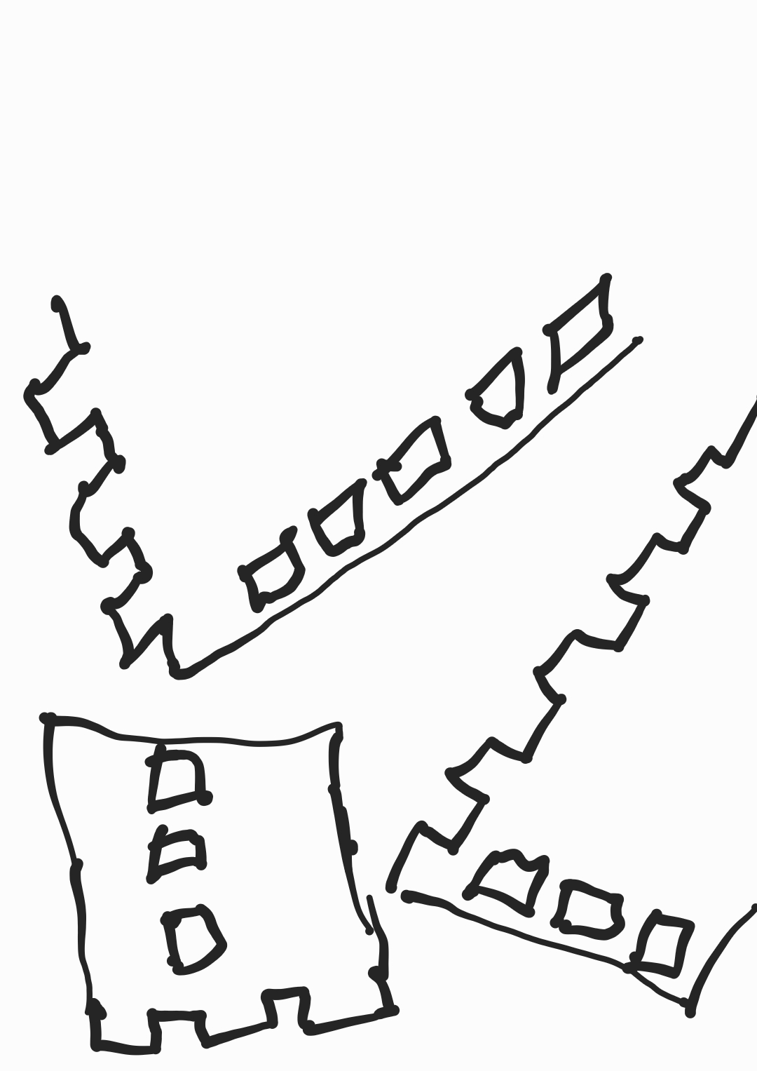

Say you were making a drawer insert (think fork/knife/spoon separator, but bigger) for a larger drawer. The dimensions make it bigger than can be cut in one piece, even using pass through. Would you just make it as two separate inserts? Or what “joining” methods would you use say to get the “base” to stay together? I am assuming some type of jigsaw-like tab and slot deal that you could also add glue to, but I have no idea how many tabs/slots you should use for maximum strength. I am thinking of a drawer that is roughly 8x36x36.

make it two layers thick, make the joins between ends and different points along the length.
Glue the two layers back to back so each join is covered by the other piece
Finger joints on the long sides.
This.
If you do inset finger joints on one plane, and then the outie ones on the other, once you nestle them together it should be rock solid.

Here’s what I did:
Yeah…that was kind of how I was envisioning it. That middle section is very much like I was talking about. Thanks.
