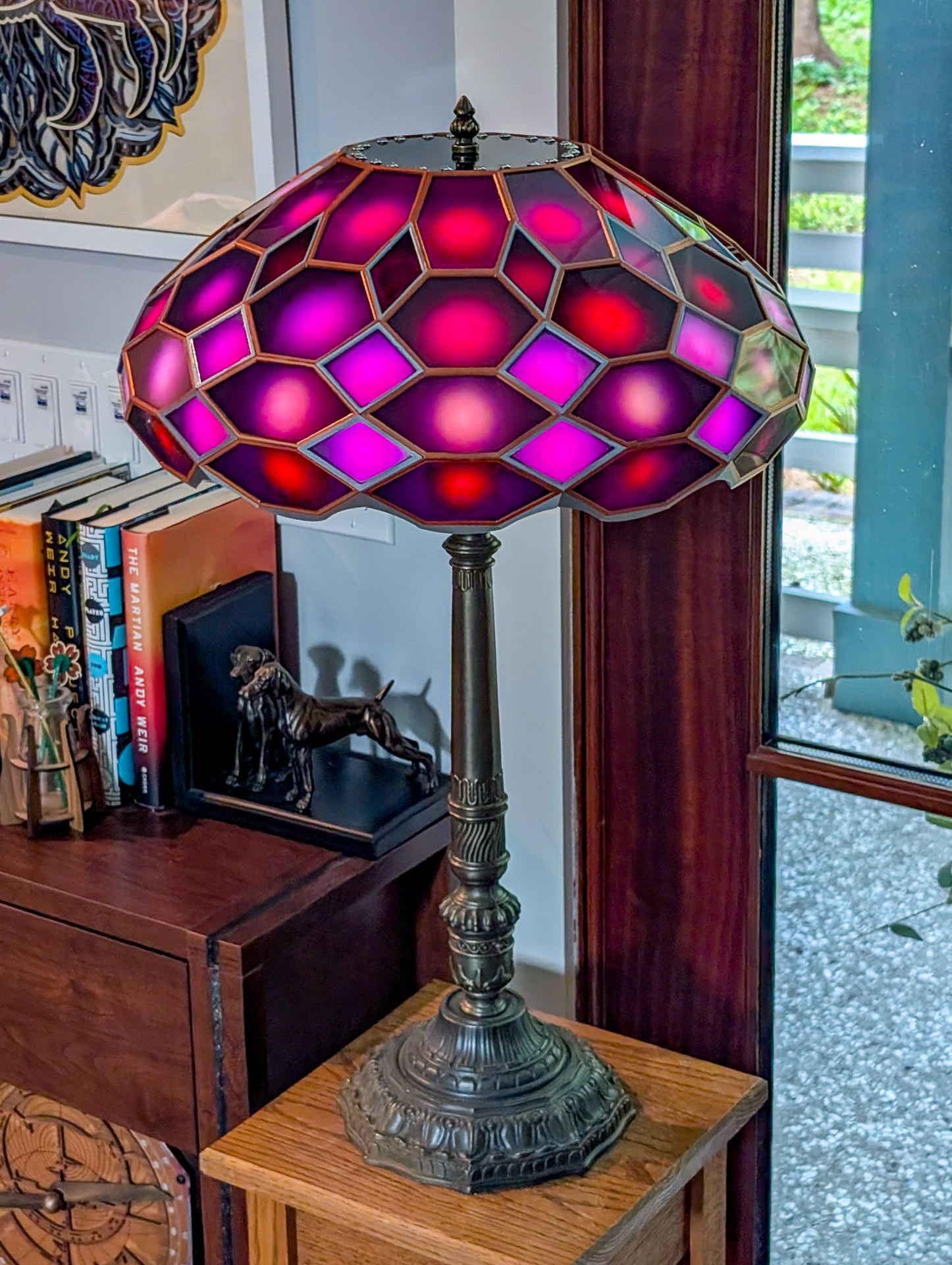

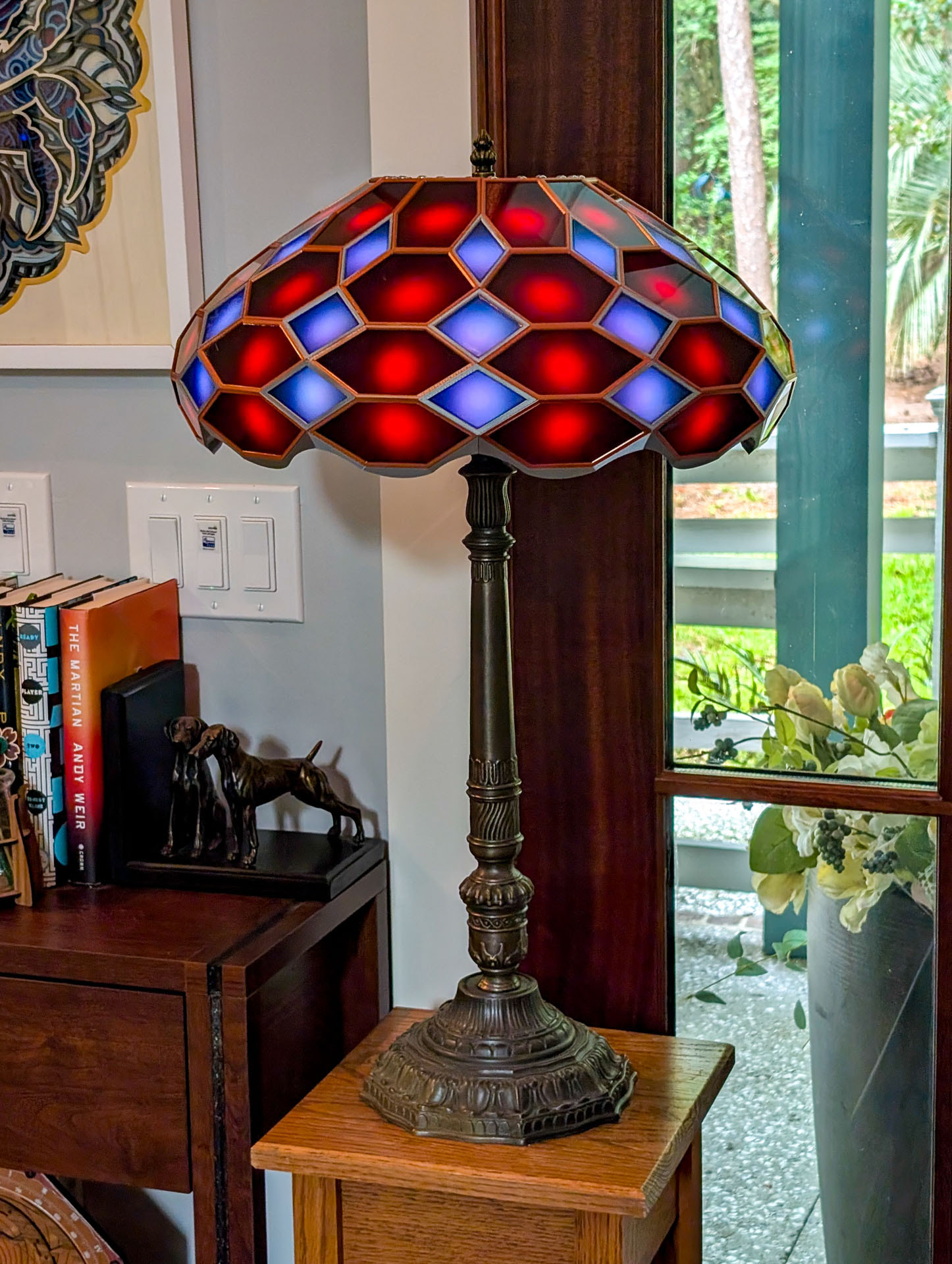

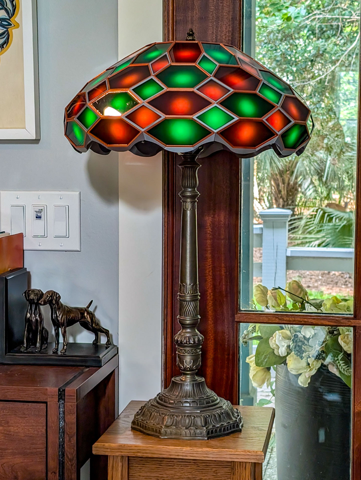

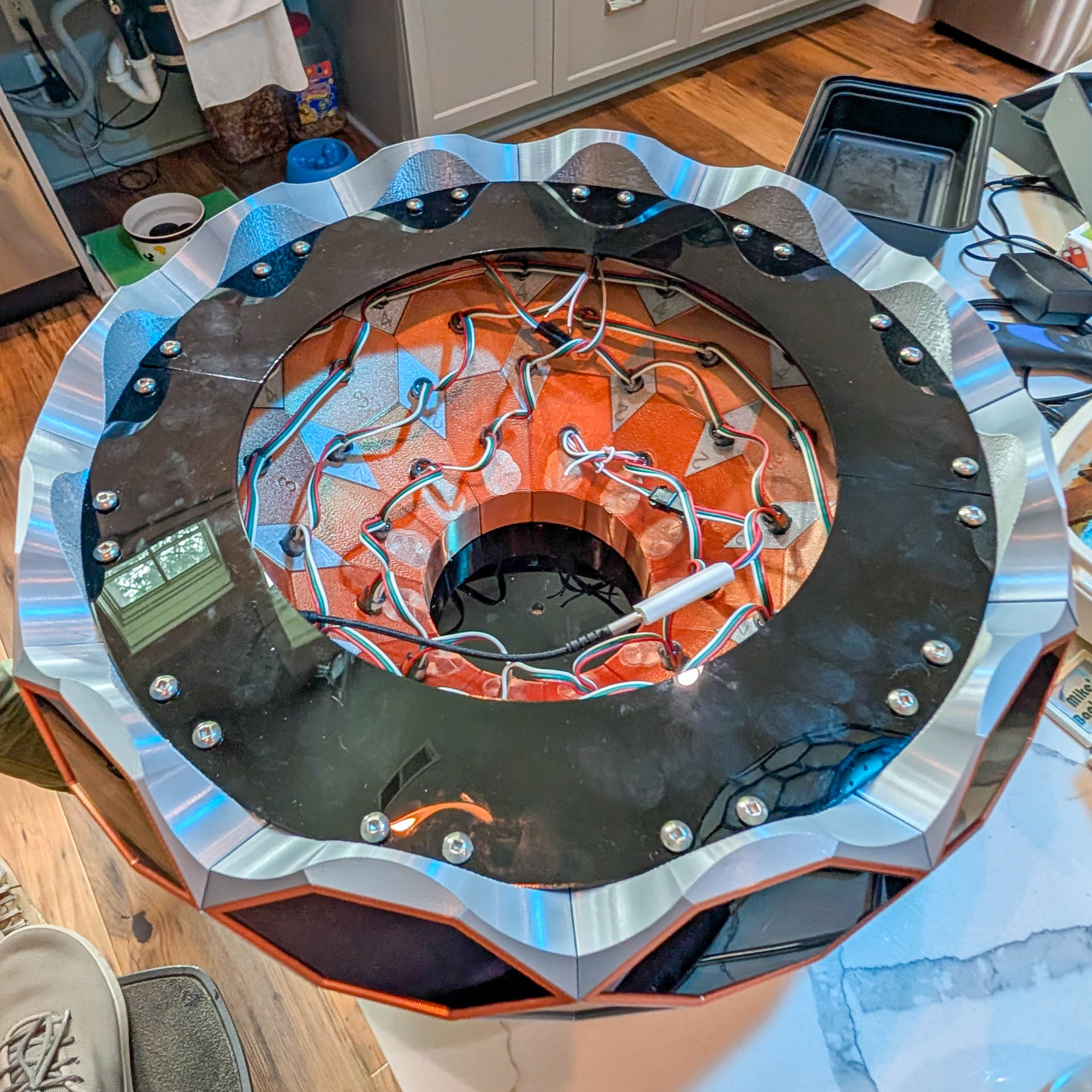

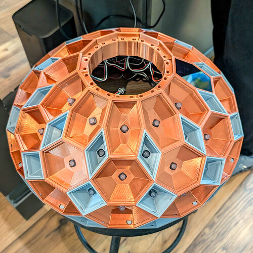

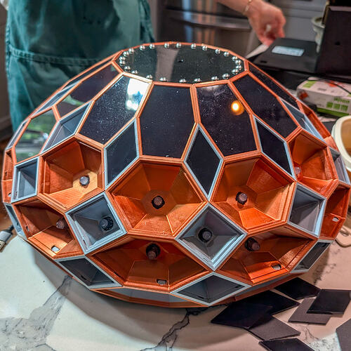

WLED Zonohedrified Hexagonal Antiprism lamp
This one has been in the works since last year. Exported as a shape from Stella4D, designed in Fusion 360, this custom antiprism has 84 faces of 7 different types. 3D printed using silk copper and silver PLA filament. LED pixel bulbs behind black LED acrylic faces illuminated by small WLED controller.

Your lamp is beautiful. How long did it take to print? That is a huge project to print.
Probably 2 and a half rolls of filament and about a week printing 12-14 or so parts at a time.
