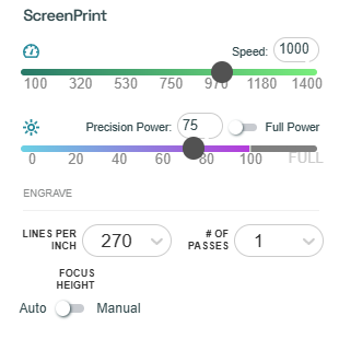

Anyone have an x-tool screen printer? I am struggling with setting for 200 mesh. I am down to 1000 speed 10 power 195 lpi. Most but not all emulsion is removed. If I go higher it burns through mesh.
huh. that seems odd. 10 power wouldn’t seem like enough to burn it off.
i haven’t run one in a while, but i looked up my saved settings and i was using 1000/75/270 and one pass on my basic.
The screens xtool sells are Polyester fast engrave screens. When I originally tried 1000/75/270 I ended up with a burnt hole. Suggestion?

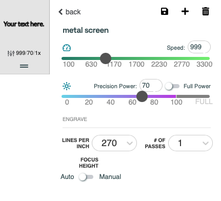

I don’t know if they changed the screens, the ones I got from x-tool are metal, and I use the above settings that I think I got from shop, and use it in the :glowforge: since I don’t have an x-tool anything other than the screens.
I did some digging and found the metal ones. Will purchase and try those. Thanks for your help!
i have the original screens from xtools and those are the settings i used. i never cut thru them. and my settings are almost exactly the same as @aloha’s.

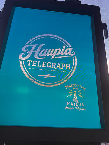

you can see multiple people are using similar settings (and you can see what the screens we got from xtool look like after engraving in this thread from a couple of years ago.
