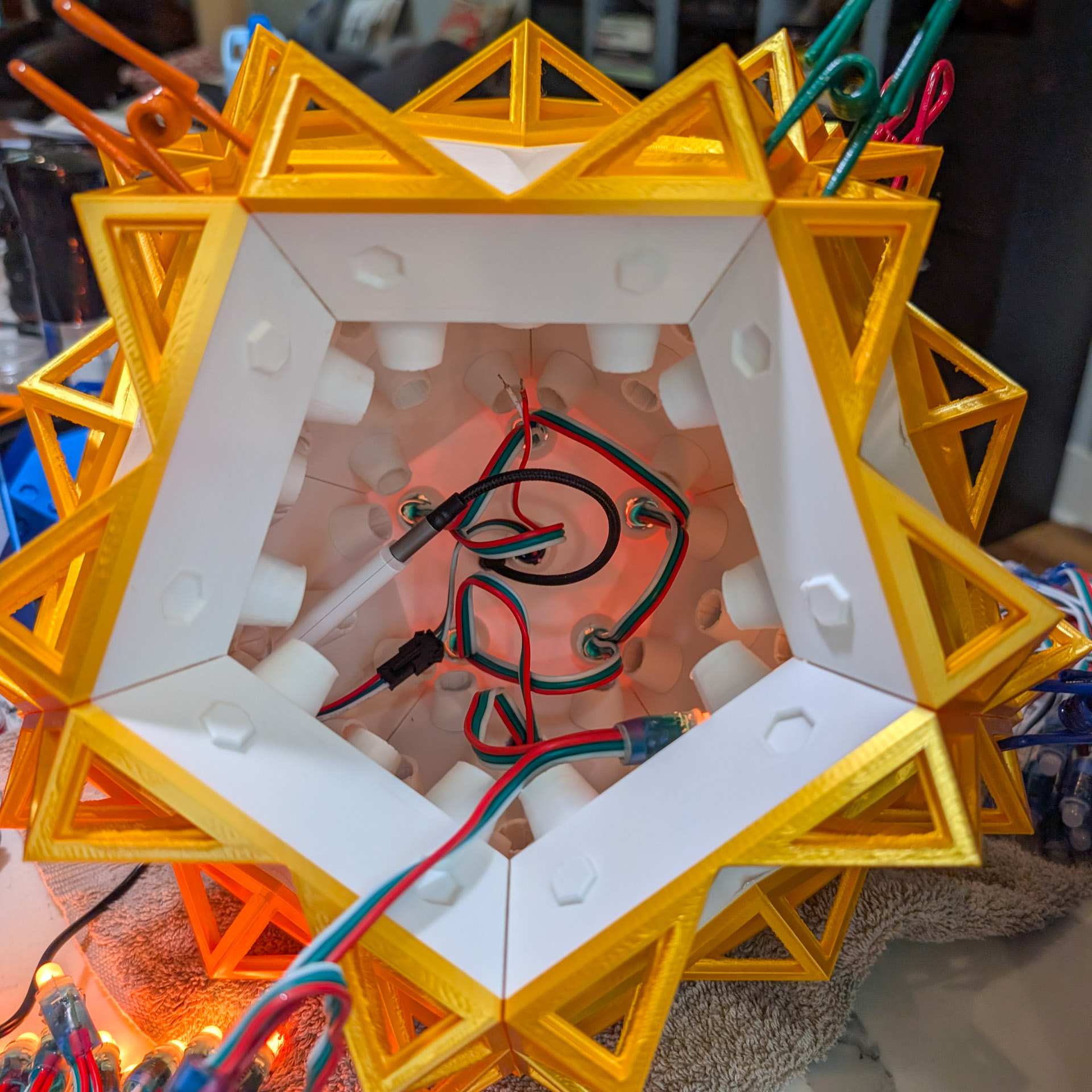

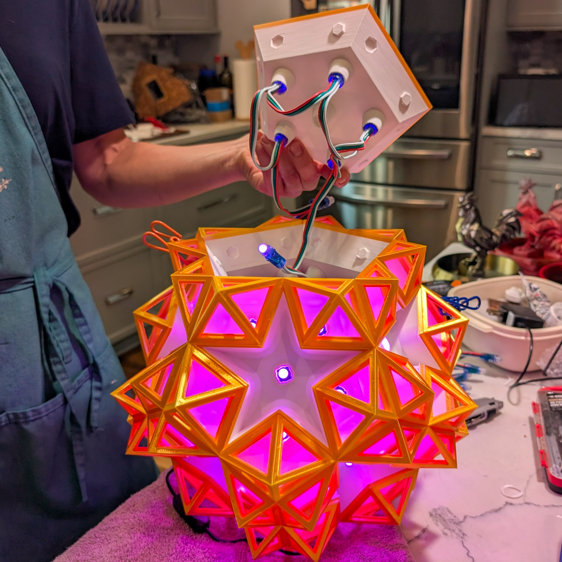

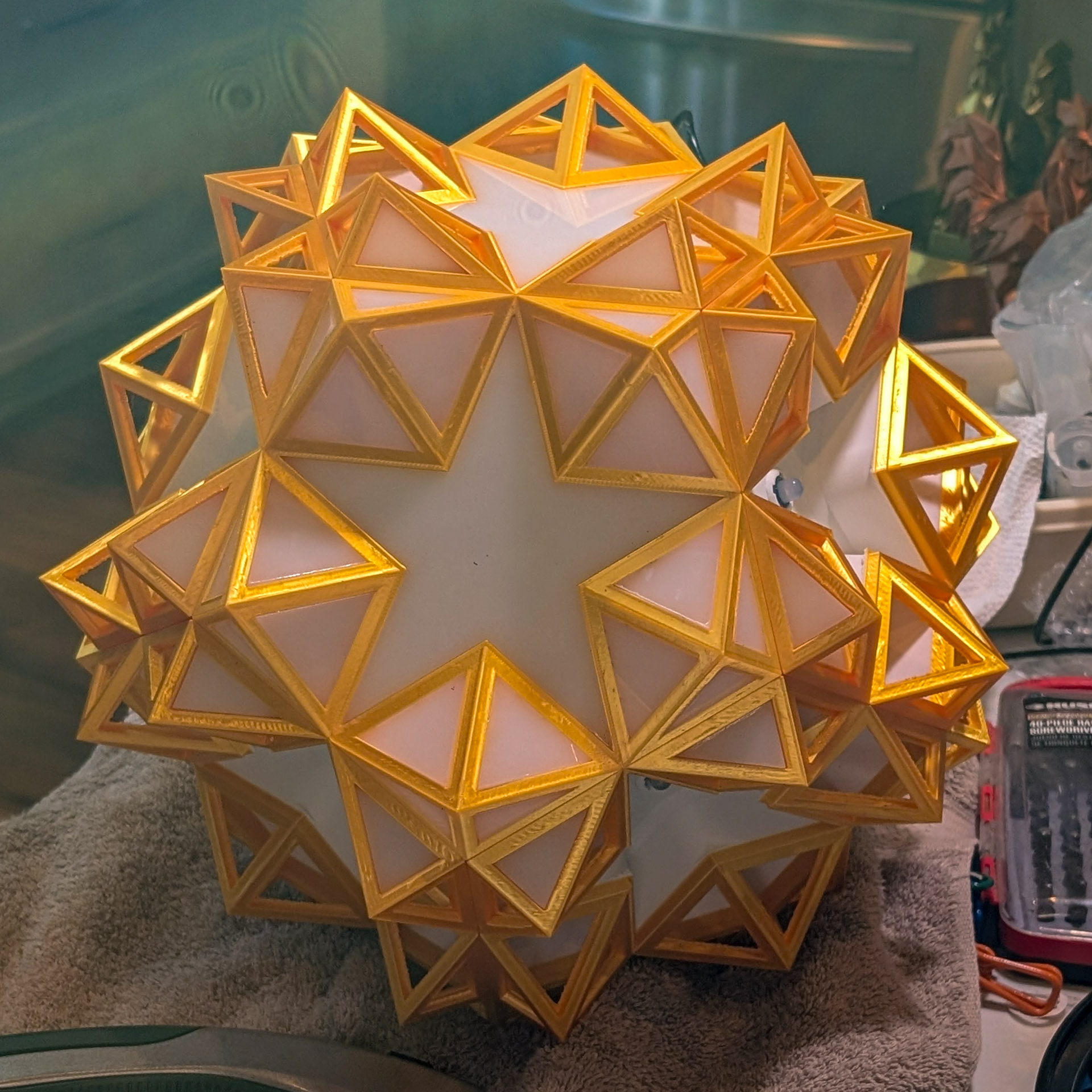

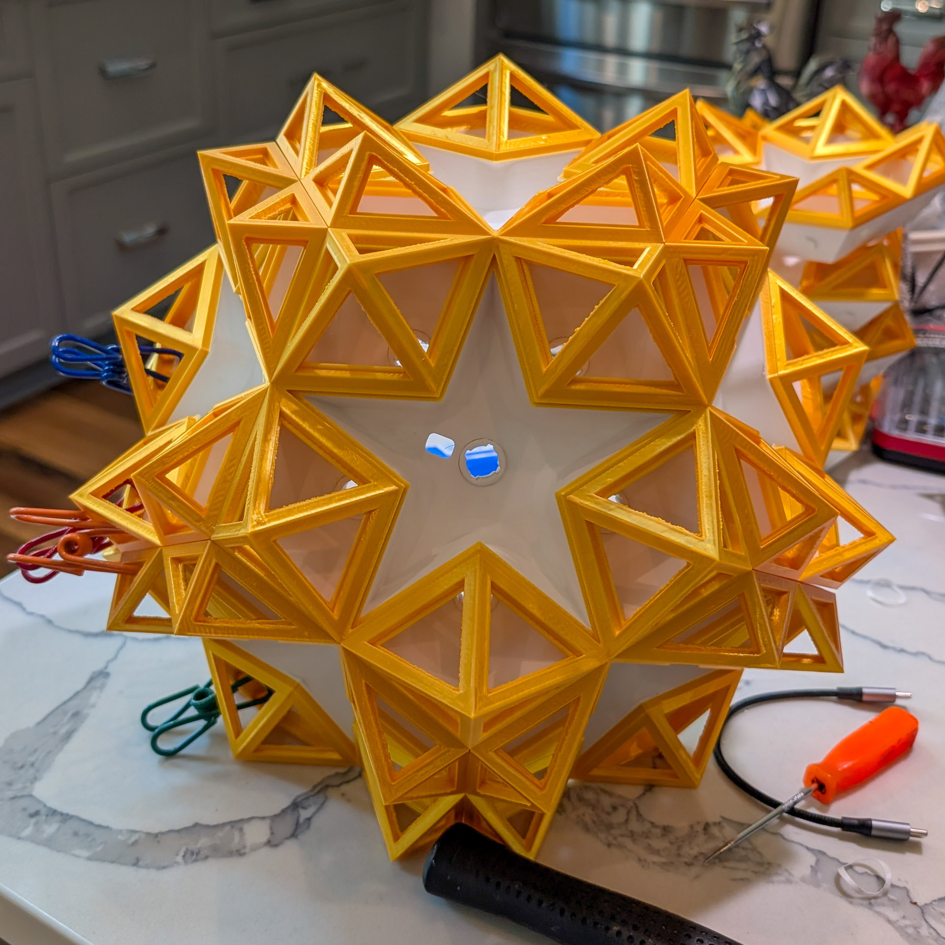

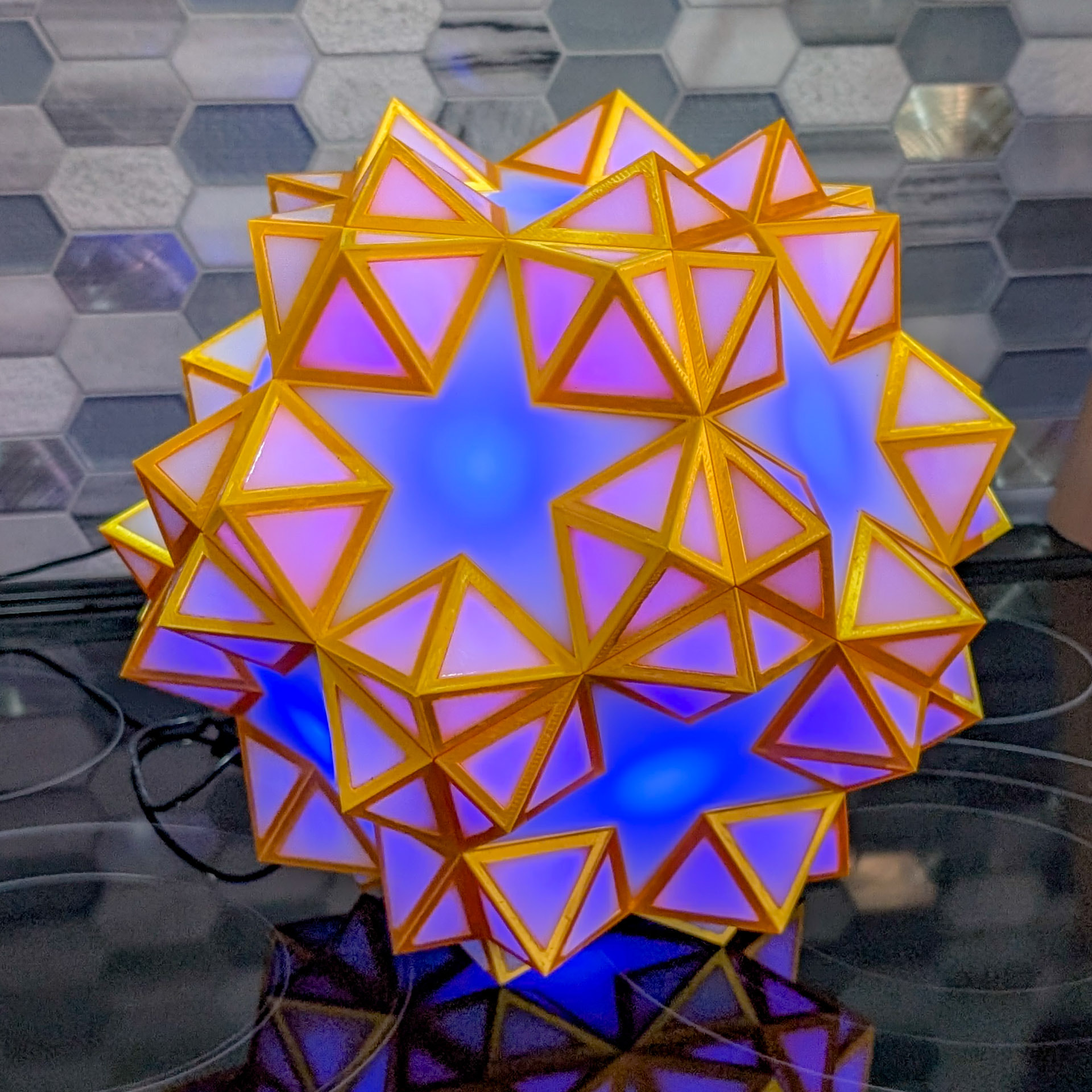

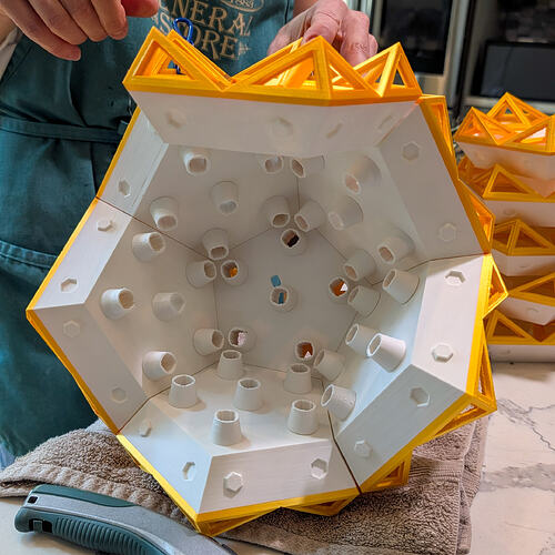

Yet another light up polyhedradoohickiething-a-ma-bob

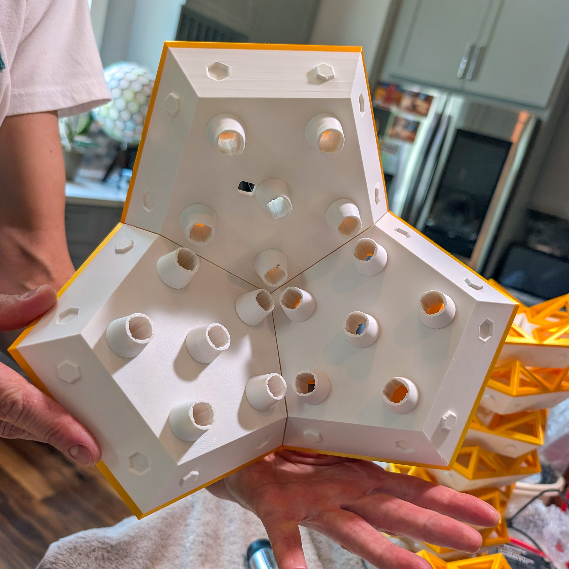

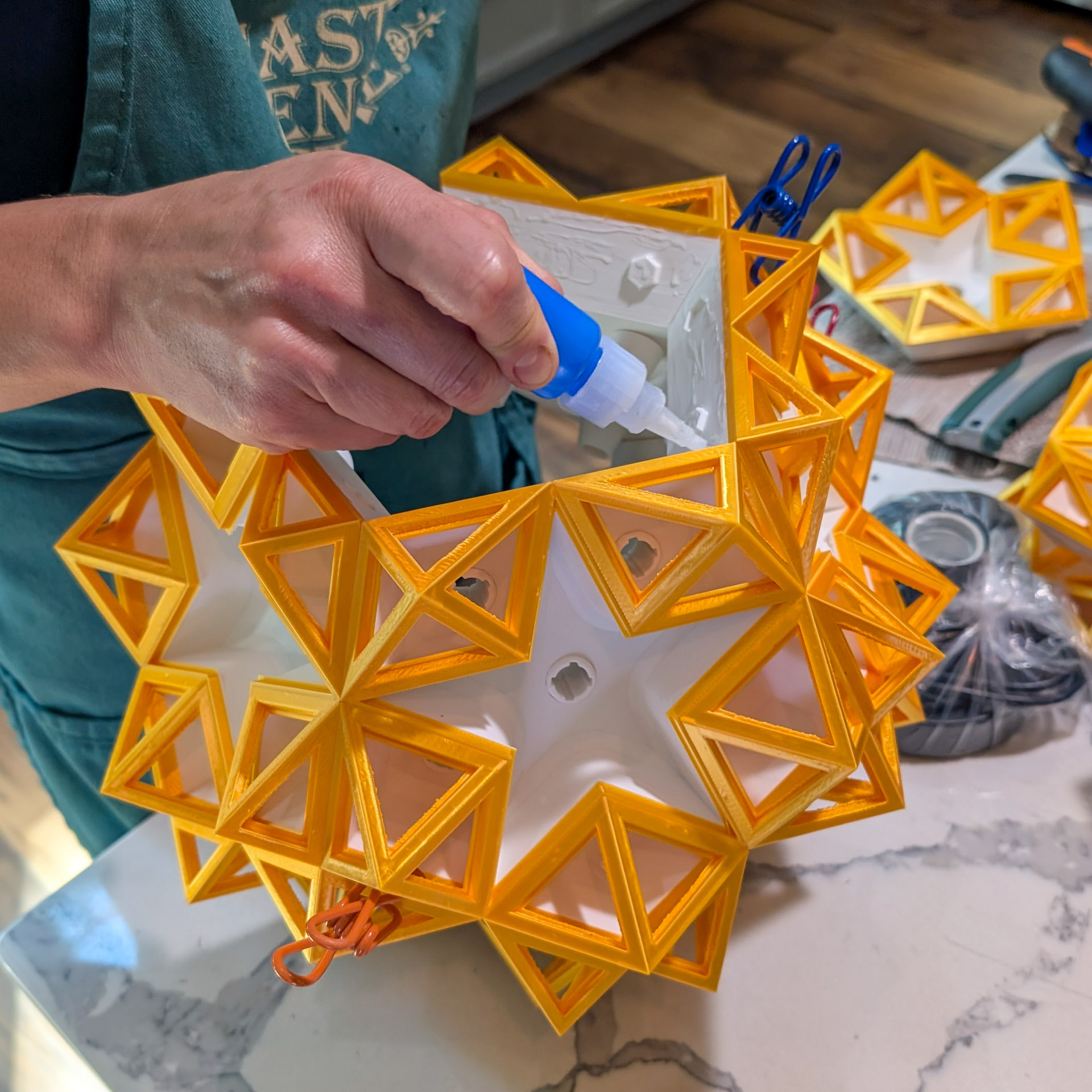

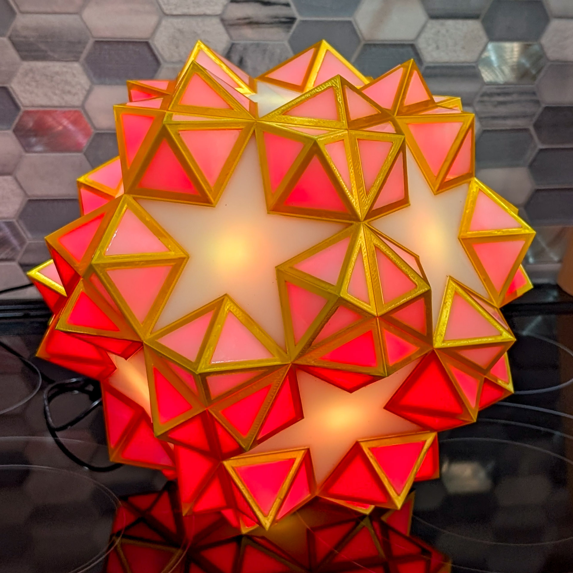

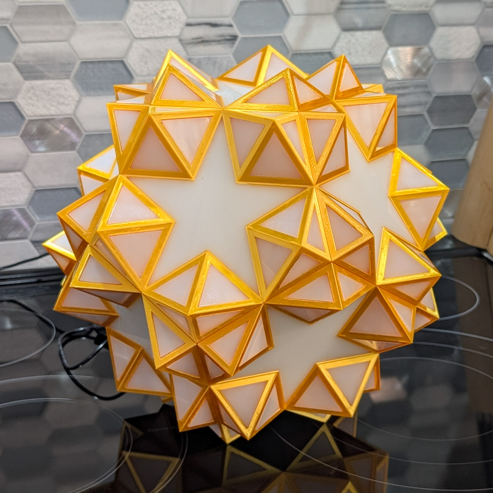

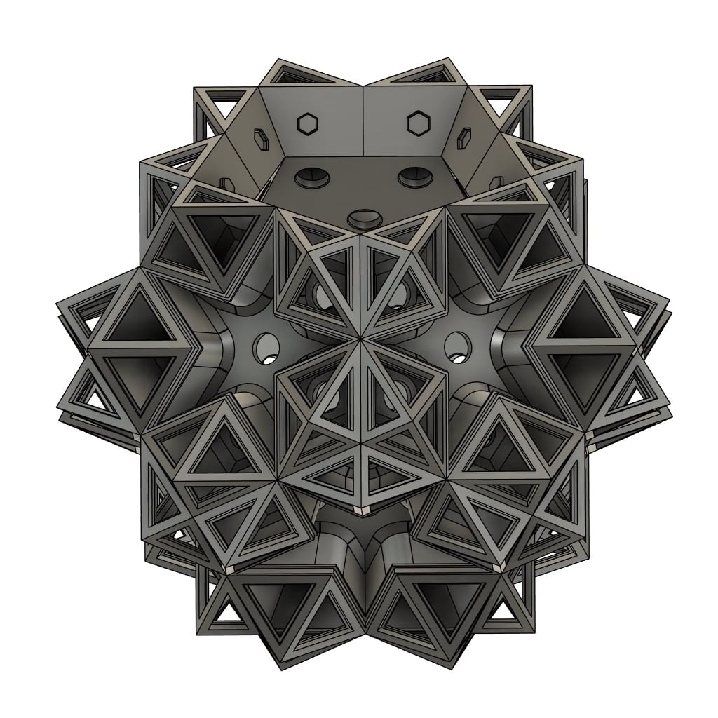

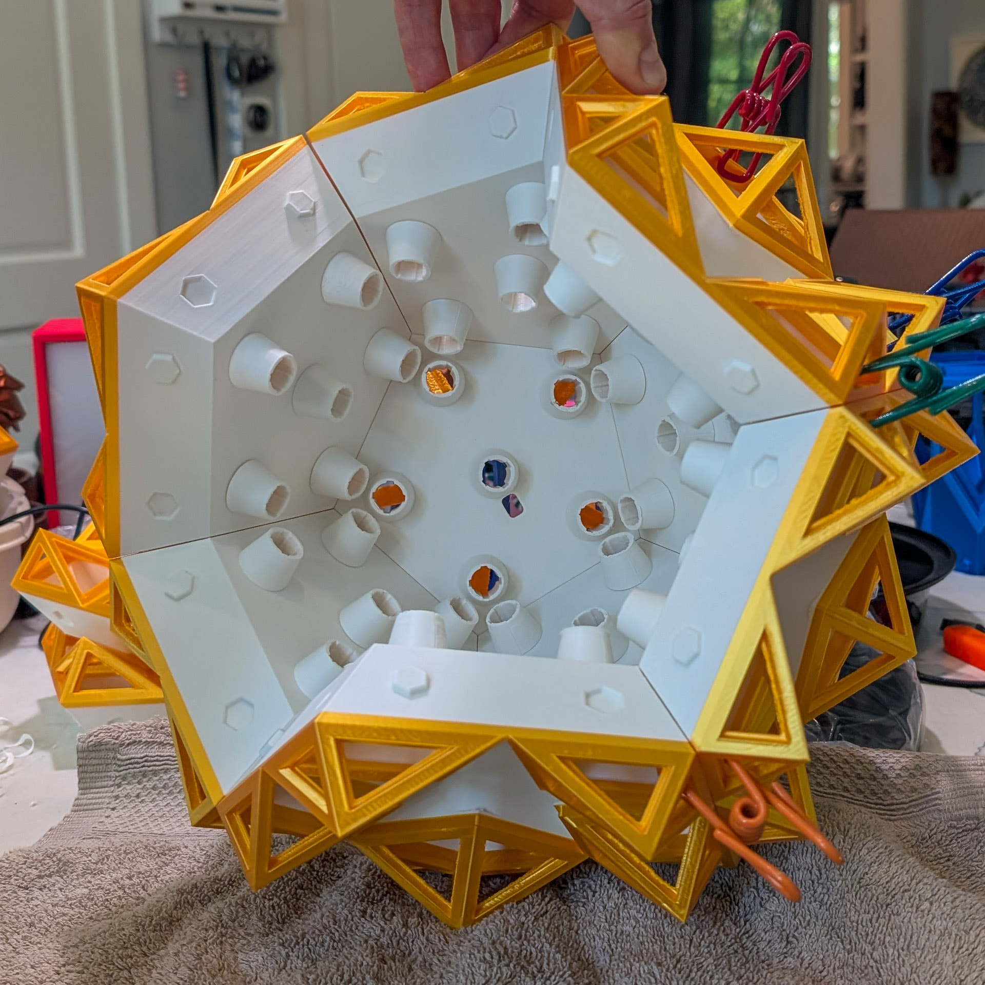

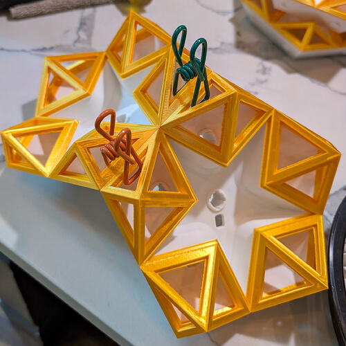

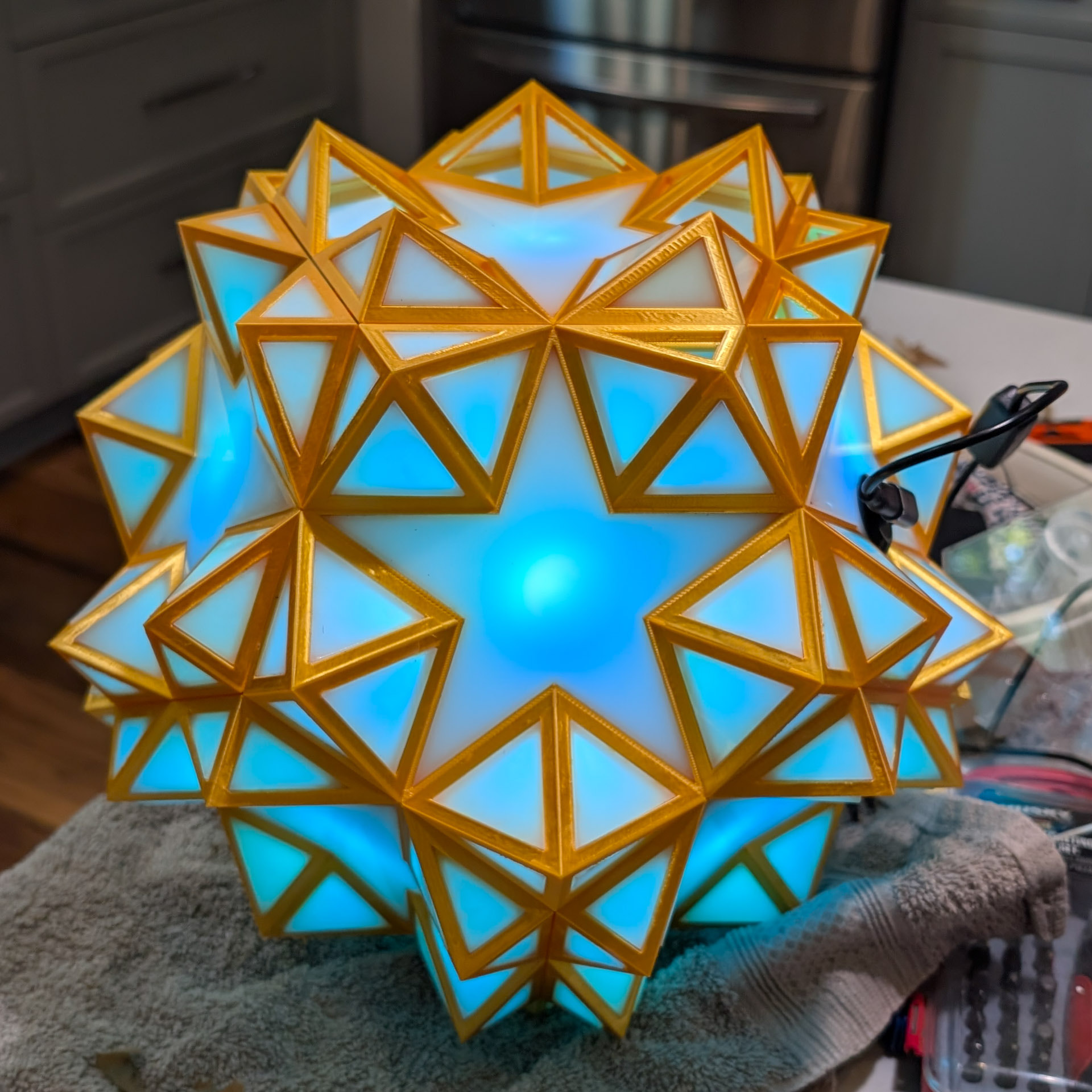

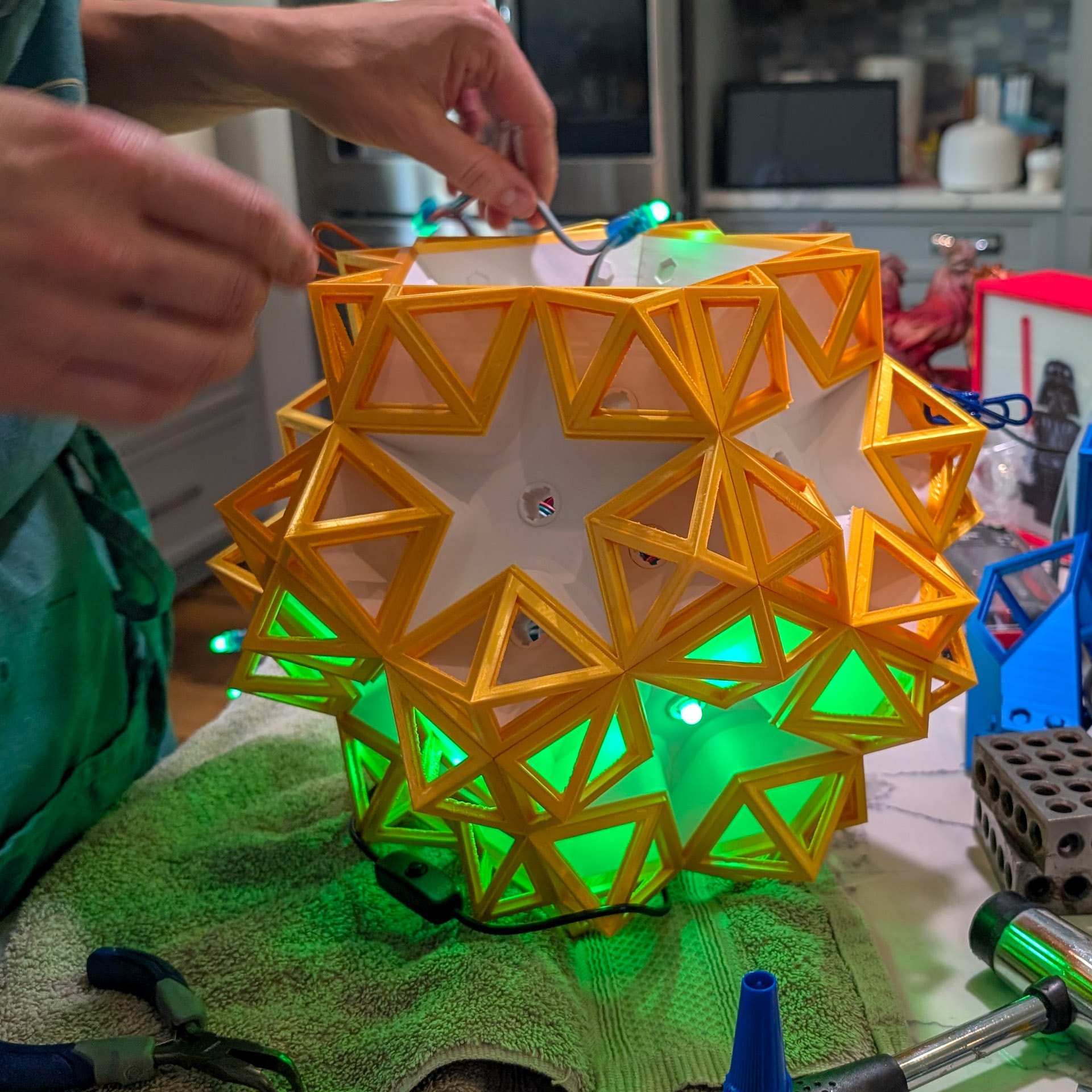

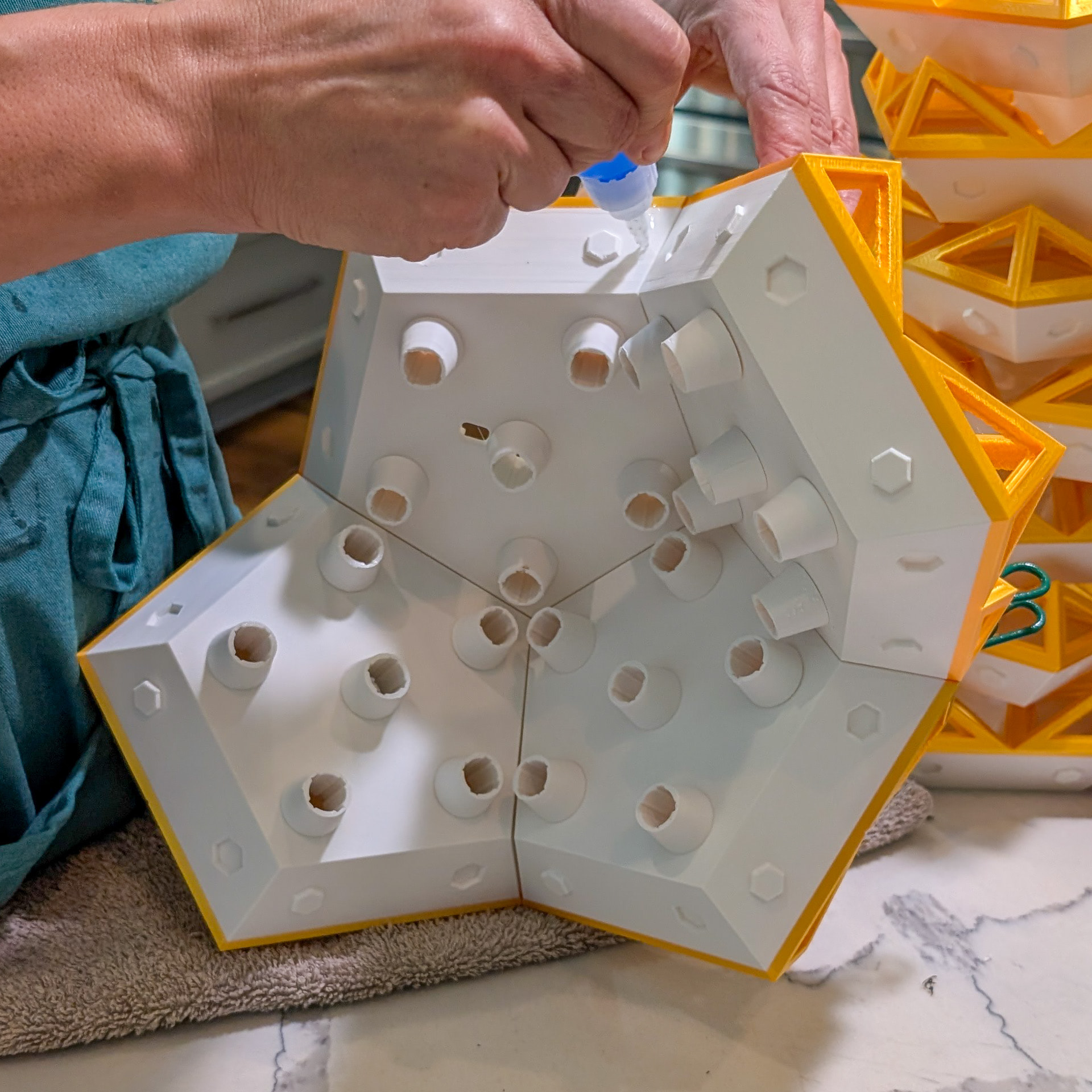

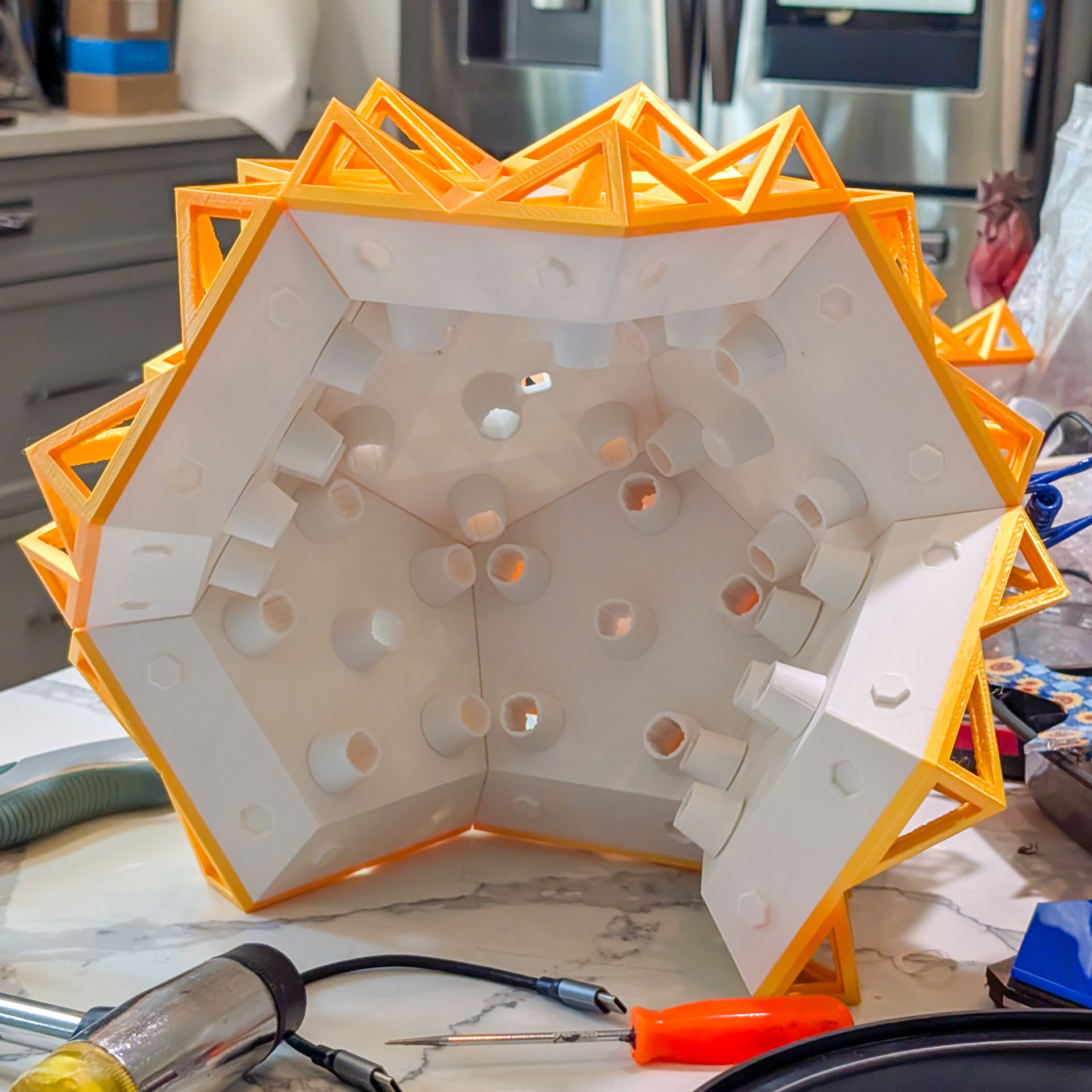

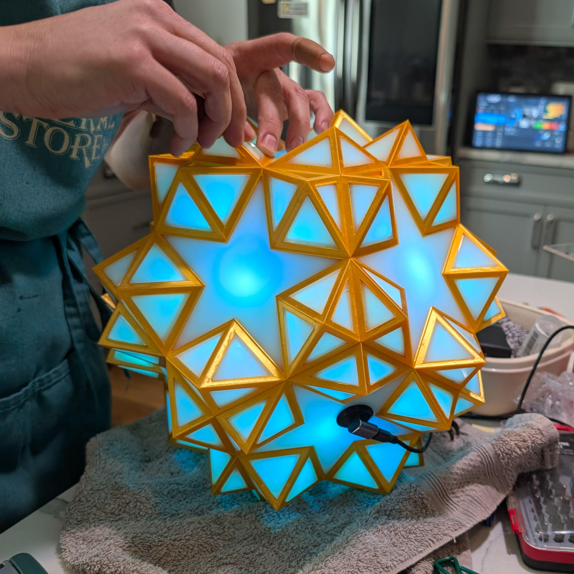

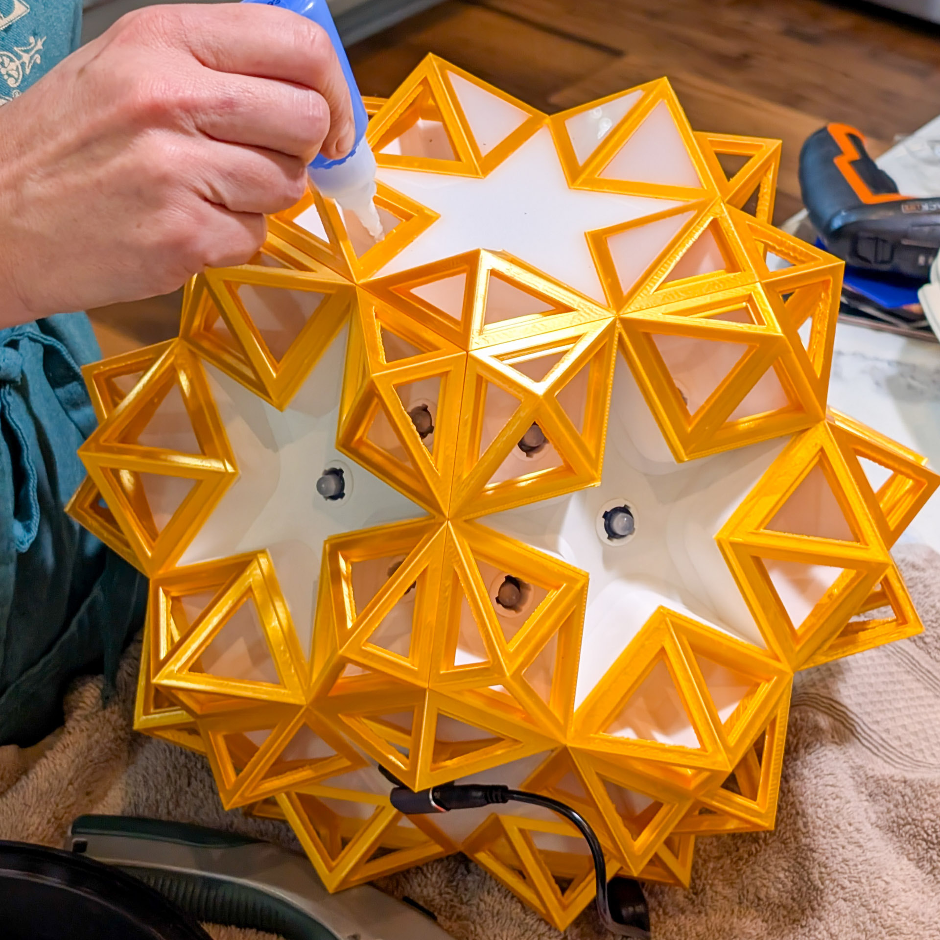

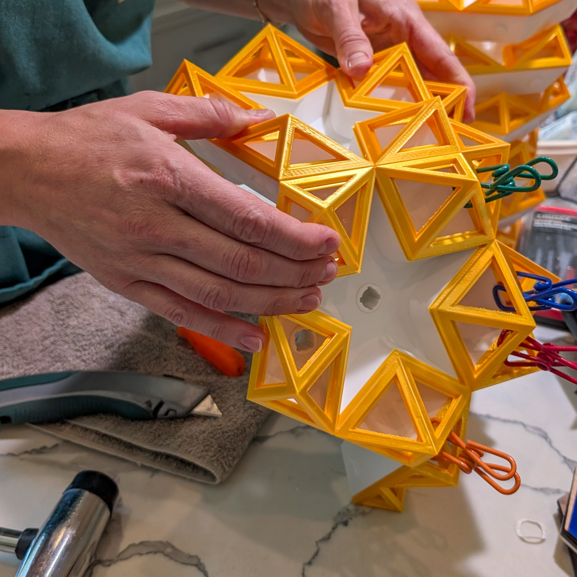

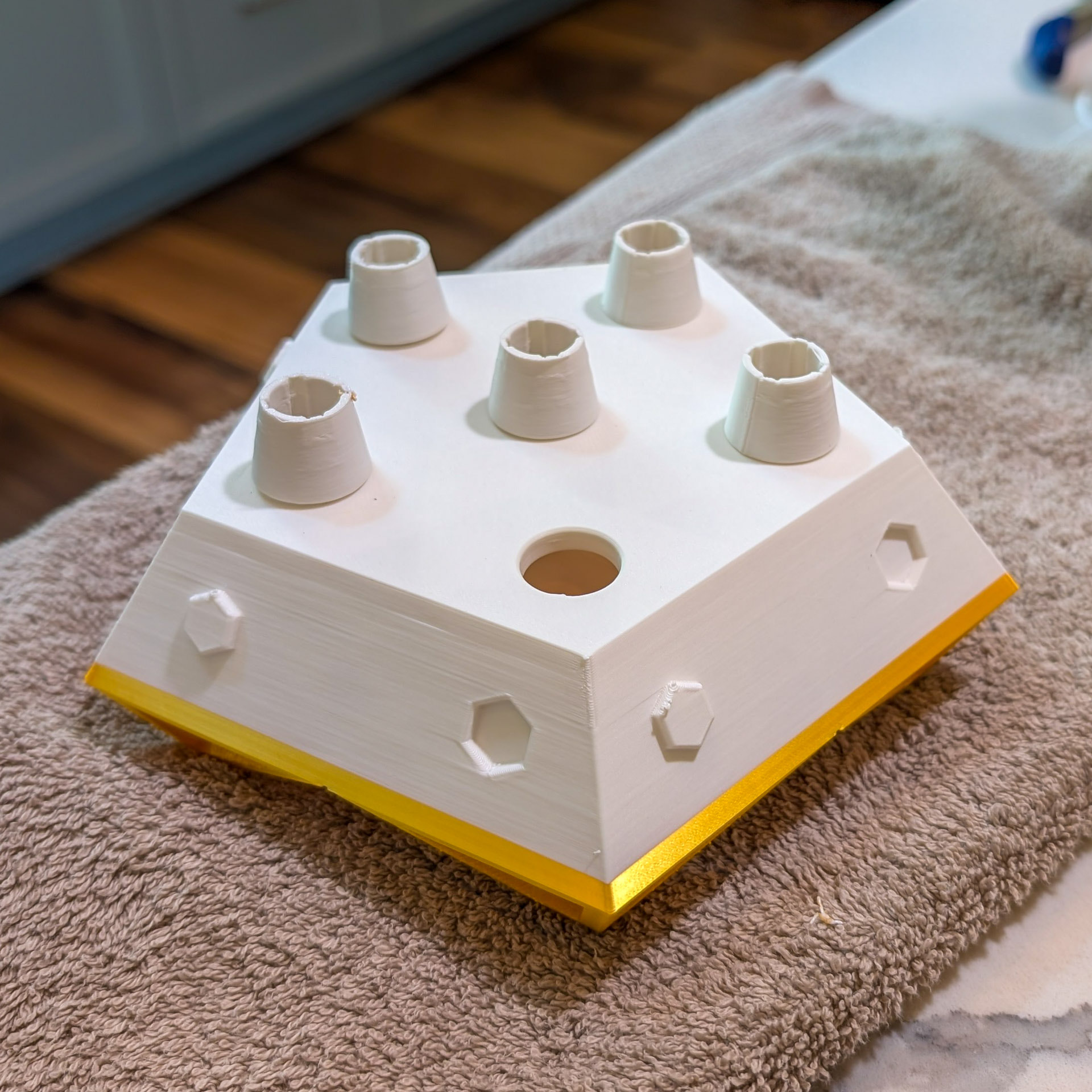

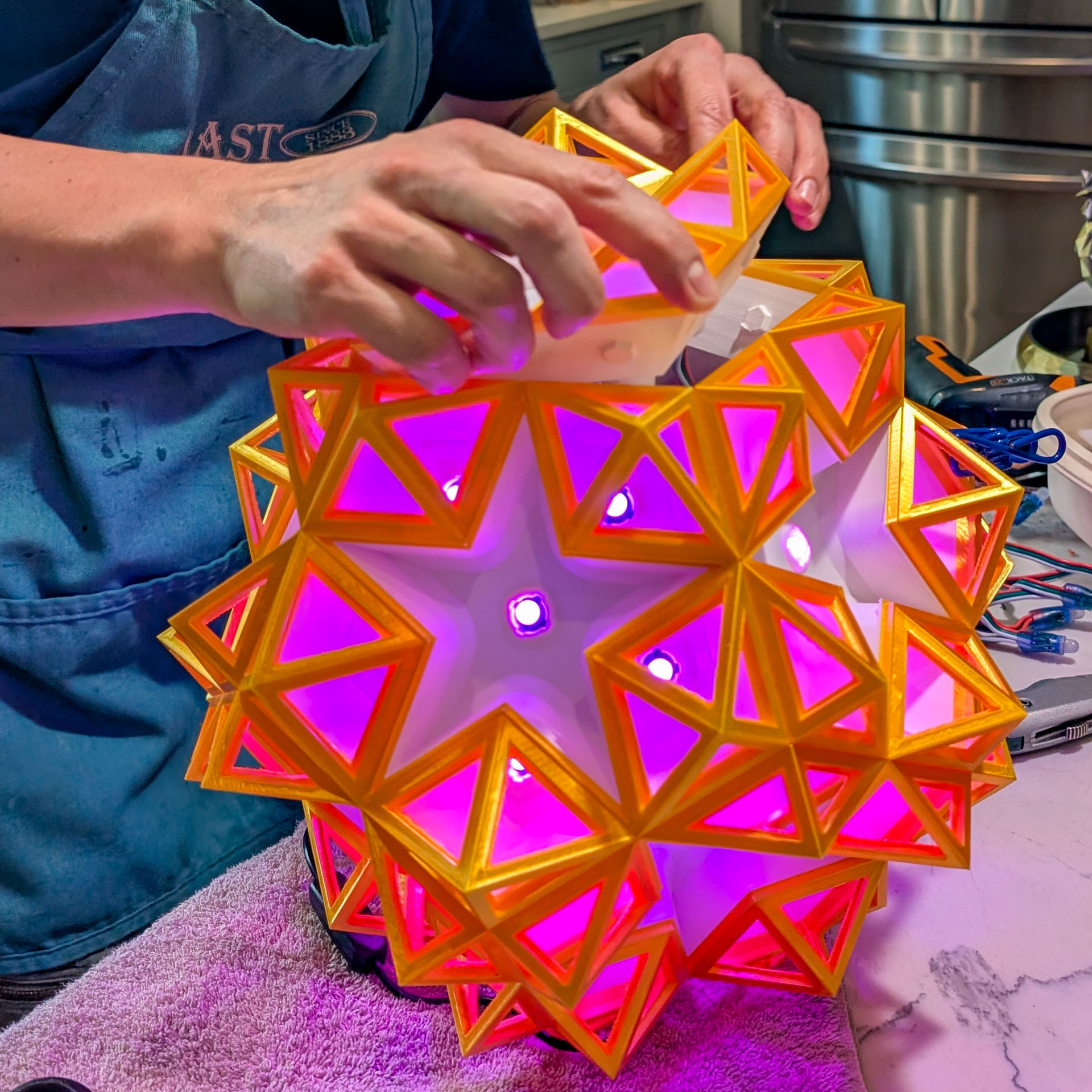

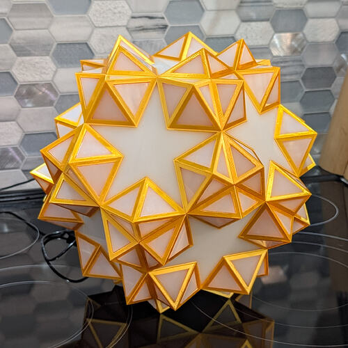

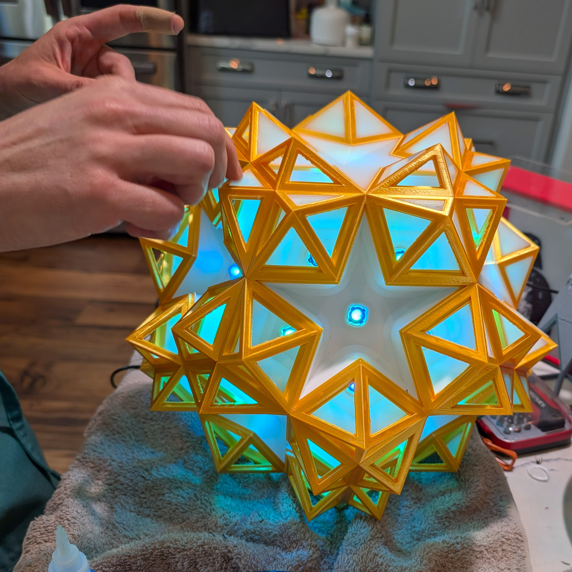

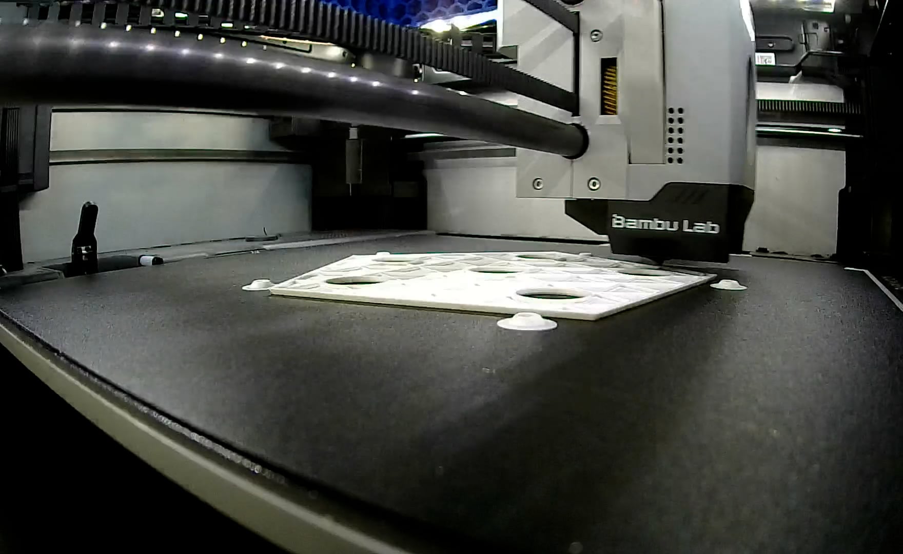

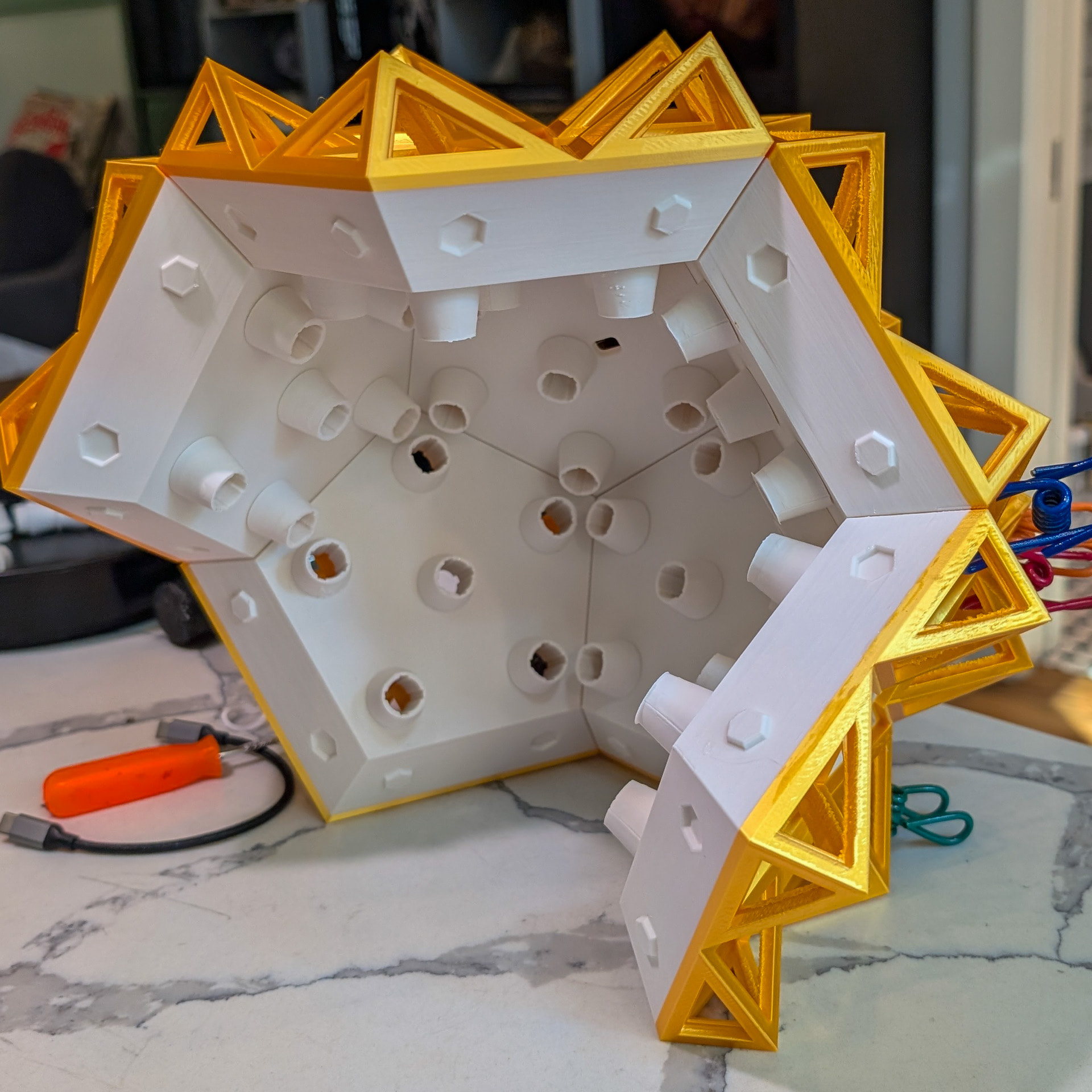

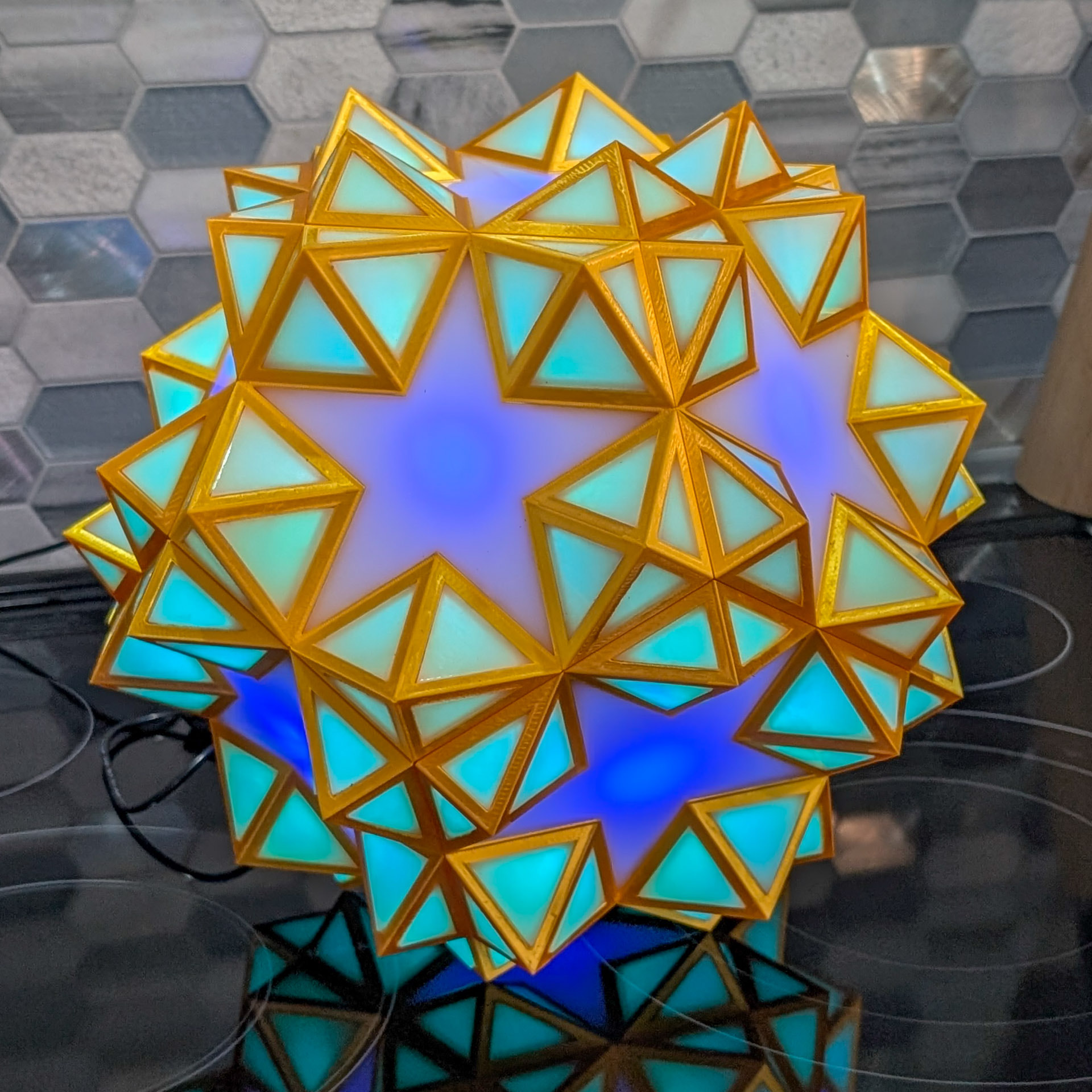

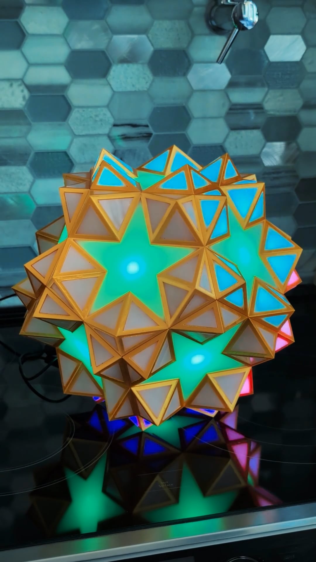

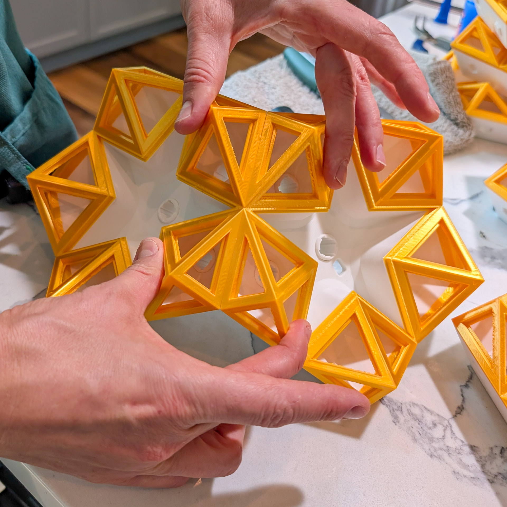

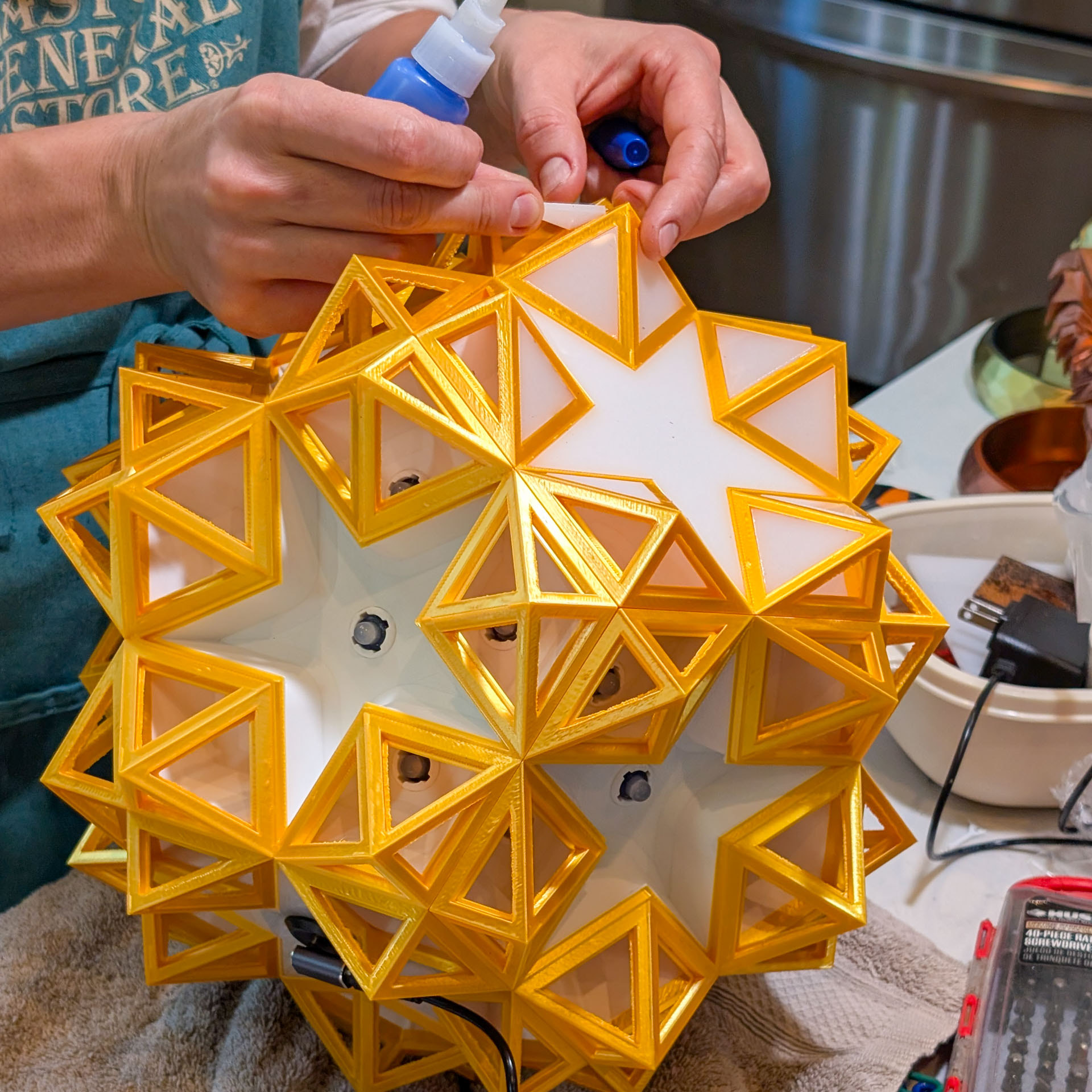

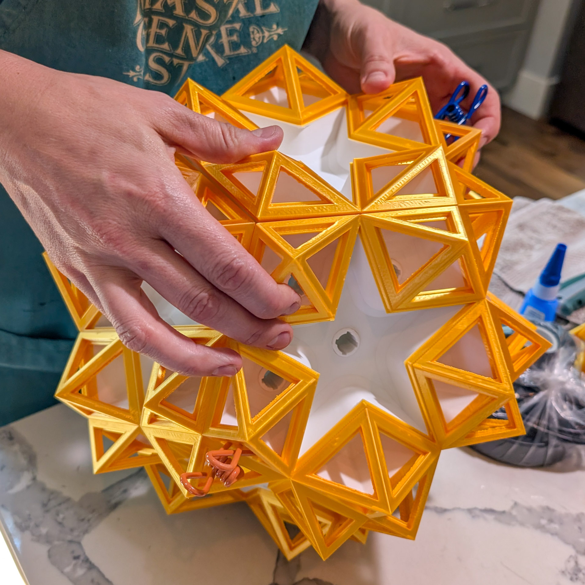

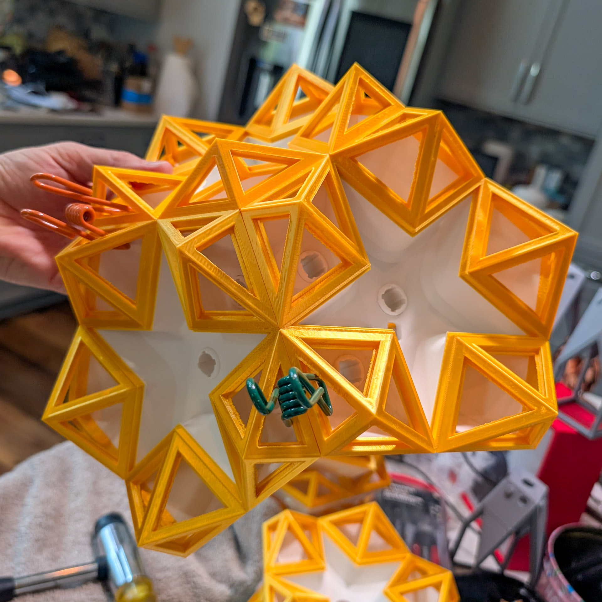

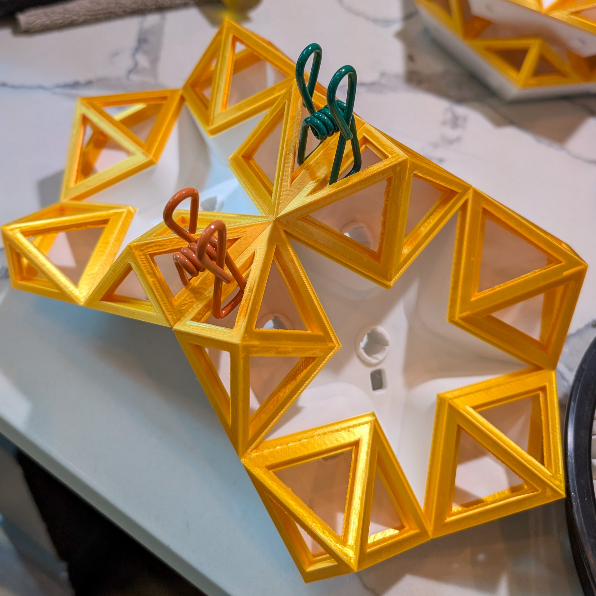

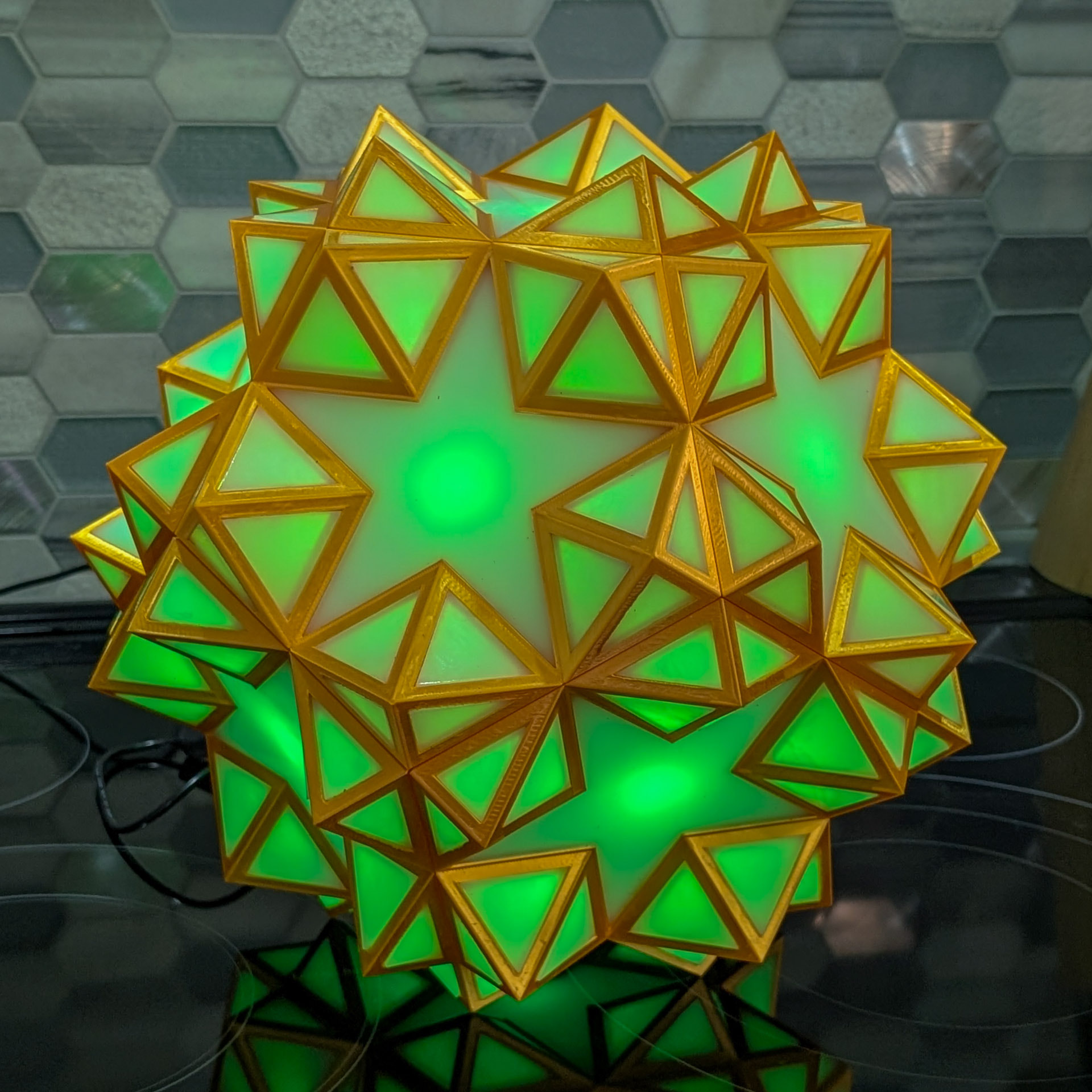

This is a Dual of Rectangular Isohedron RTC+GRTC 2. Usual process of generating shape in Stella4D, design parts in Fusion, and 3d printed with a Bambu x1-c. 12 x 3D Printed structures with laser cut milky white acrylic faces. LED pixel bulbs controlled by a IoTorero WLED Slim controller on the inside.
Build Pics

Got an estimate on the 3d print times?
91.8 hours.
