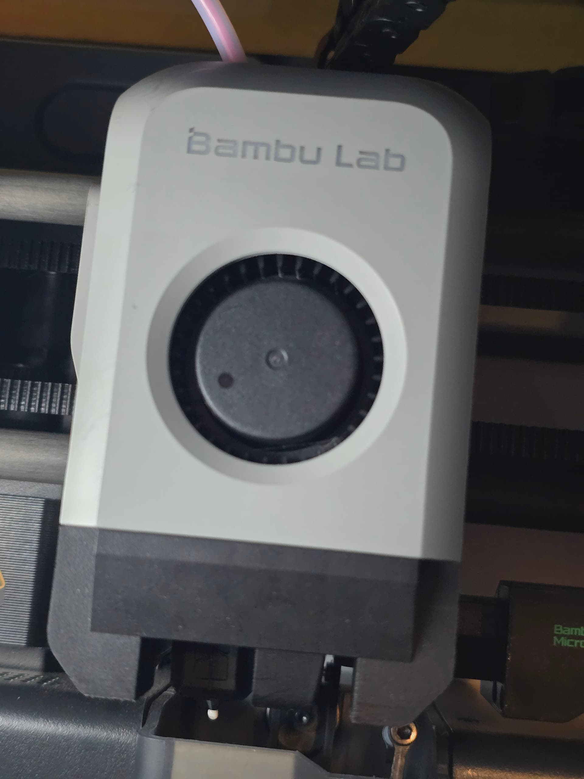

Here’s what he said is happening (copied from his Google chat messages):
The ptfe tube here moves when printing. I believe that’s the problem. I can’t find anything that is supposed to hold it in place while the filament gets pulled through it.

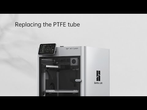

Here’s the video where they show how to replace the ptfe:
https://www.youtube.com/watch?v=xzrpJi5bKtc&t=1s
YouTube video
And it’s not that clip with the blue thing on it that holds it in place.
If you watch the video you can see them just pull the tube out of the part that goes to the back of the printer. And when they replace the tube they just slide that clip up. Nothing seems to lock it in place.
When you print the whole tube slides along the path that the filament takes. And I don’t think the filament is getting pulled into the extruder which is why it won’t spit out any filament when printing.

If there is a filament jam in the nozzle, as it tries to extrude through that and it gets stuck, that may be why the PFT e tube is moving out. Out. There are definitely ways to troubleshoot and get rid of a clogged nozzle, and I could help you through that. However, if you have a spare nozzle to swap out. That would at least verify if you have a clog or not in the current nozzle. I would try swapping first and then let us know how that goes
If what @pubultrastar mentioned doesn’t work, when you change the nozzle you need to tell the machine which nozzle is installed. You get there on the panel, under accessories you should find nozzle and make sure the machine knows which nozzle is installed. You’ll update in the slider later too.

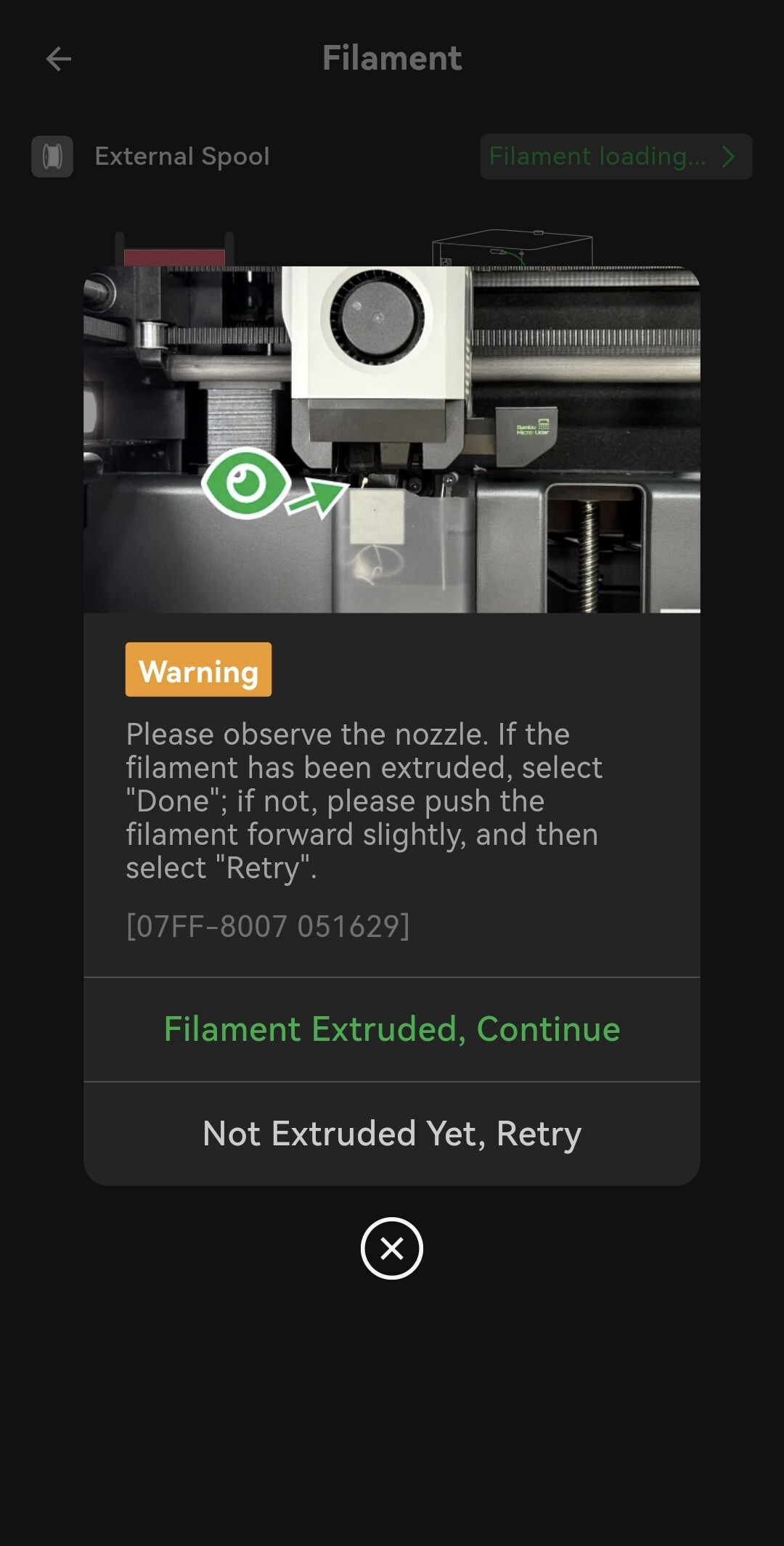

Ok I changed to a (new?) hotend / nozzle (0.6). I updated that info on the machine. I opened a new filament (bambu pla basic, pink, which is easy to see in the tube, an extra bonus) and updated that in the app on my phone. I bypassed the AMS and placed it on the spool holder in back. Inserted the filament through the tube in the back (after fighting with the coupler and not knowing I just had to press it in, ugh). Fed it in until it stopped. Told it to load the filament.
Edited to Update:I forgot to include the message lol
Now I’m stuck. I have retried several times. I unloaded the filament and started over and repeated the process and still at the same point.
It’s probably a blockage or problem with the gears.
Side note probably relevant: when I swapped the nozzle, there was a piece of filament sticking out. I tried to remove it. I don’t think I got it all. I’m guessing this is the problem? But I don’t know, this might be a secondary problem.
How do I proceed?
Thank you in advance to both @pubultrastar @hansepe and anyone else willing to help me troubleshoot and get this fixed. And those gridfinity bins! :heart_eyes:
This does not look fun to me. (Maybe if I didn’t have so much else on my plate I’d be less resistive? lol)
Sometimes when loading a new nozzle, I have to tell it nothing came out a few times before the new filament actually starts extruding. It is actually annoying how many times you have to tell it to retry…
