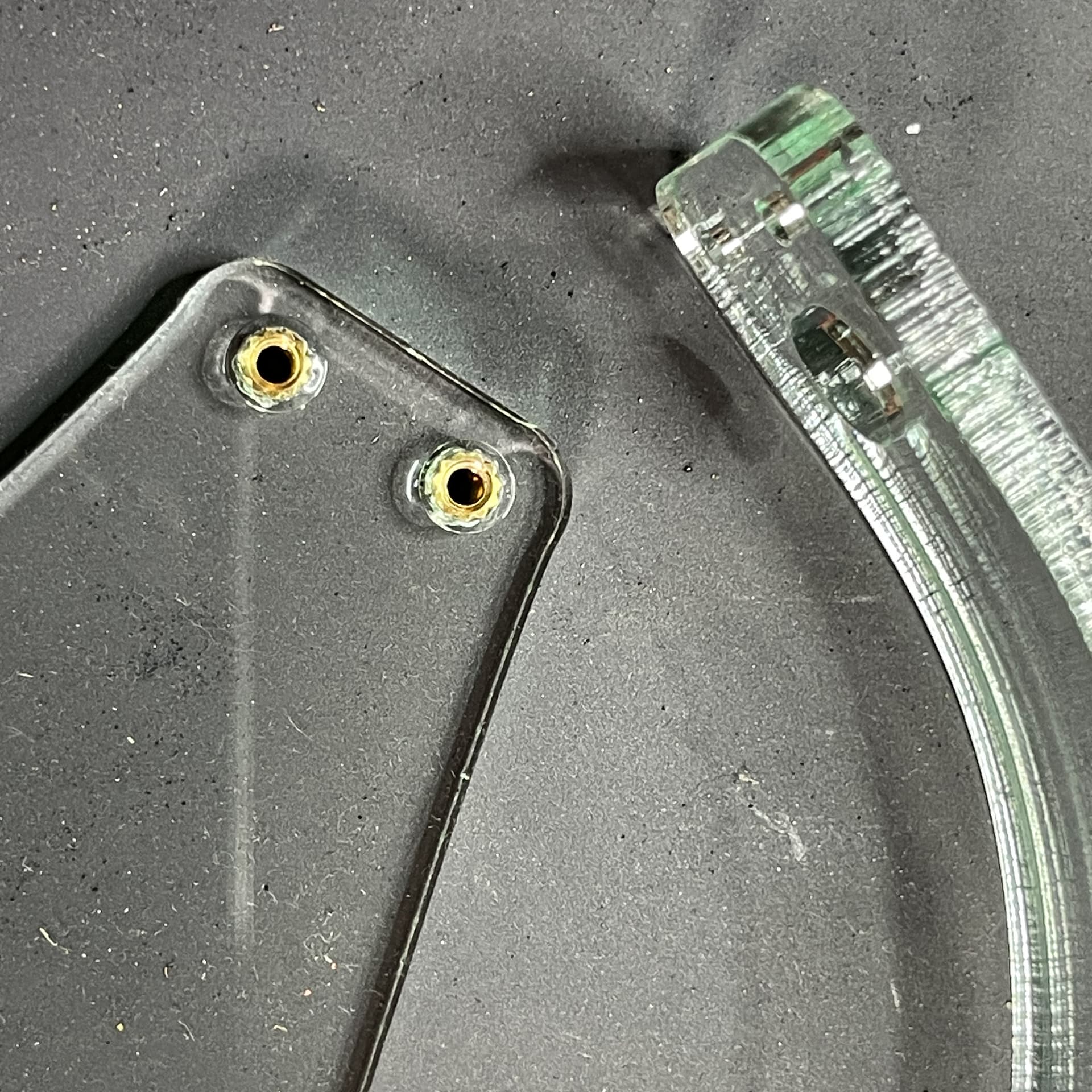

There is now a second stand made with heat-set inserts! They worked great.

I can see these obviously, but what exactly are they? I like the way they look and might have some use cases.

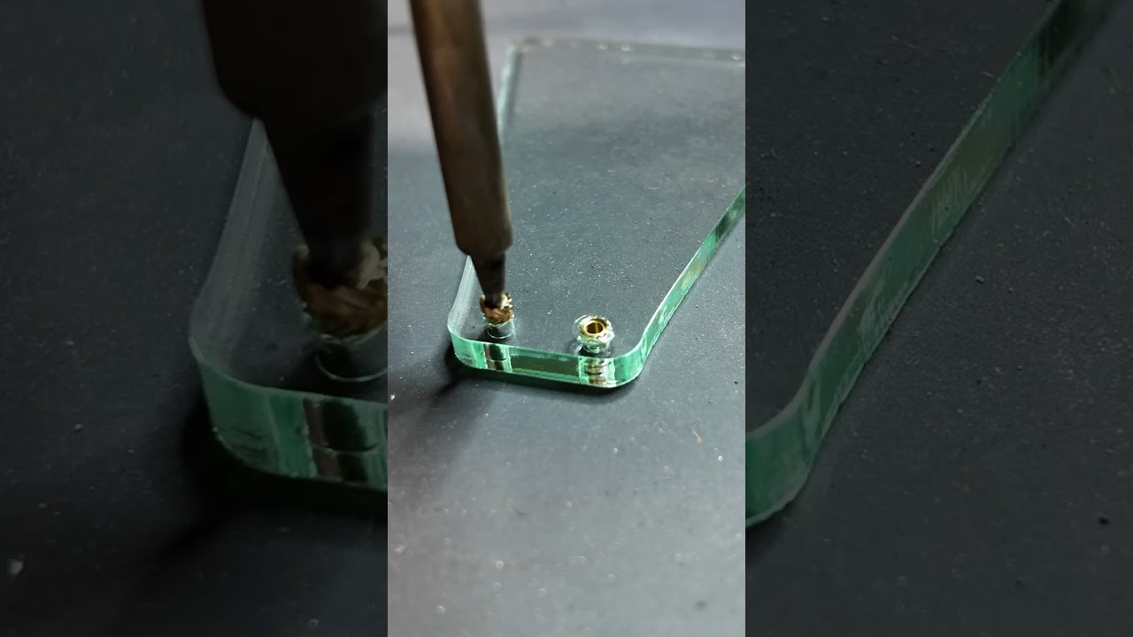

Heat-set inserts are little metal (usually brass) pieces that are threaded on the inside and have a rough structure on the outside designed to melt into plastic. You install them with a soldering iron, or, if you are fancy, a dedicated tool. You make a hole in the plastic a little smaller than the insert (in this case, 4mm or 3.8mm kerf corrected for the M3 insert), then use the soldering iron to melt them in. The melted plastic flows back into the structures on the outside of the insets to help keep them in place. People use them in 3D FDM prints a fair amount.
Here’s a video of installing one:
Great…thank you so much. You gave a good description and I will watch the video. :slightly_smiling_face:
FWIW, that video is 18 seconds long.
