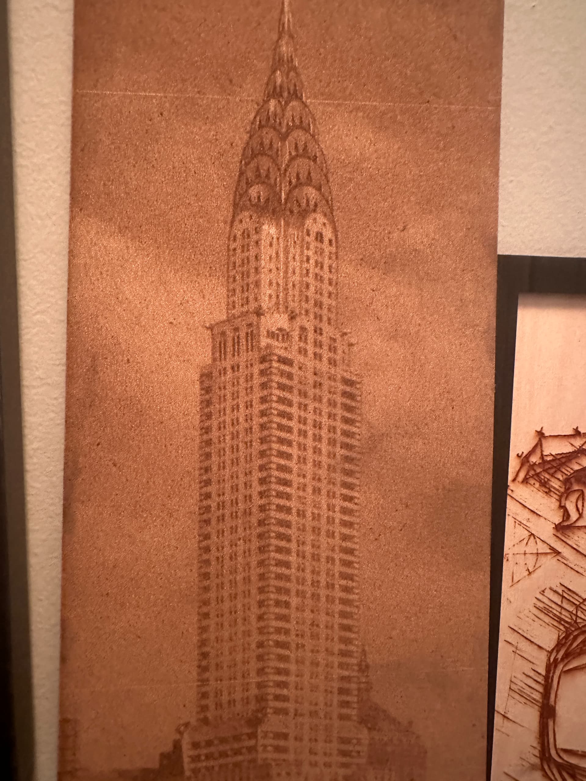

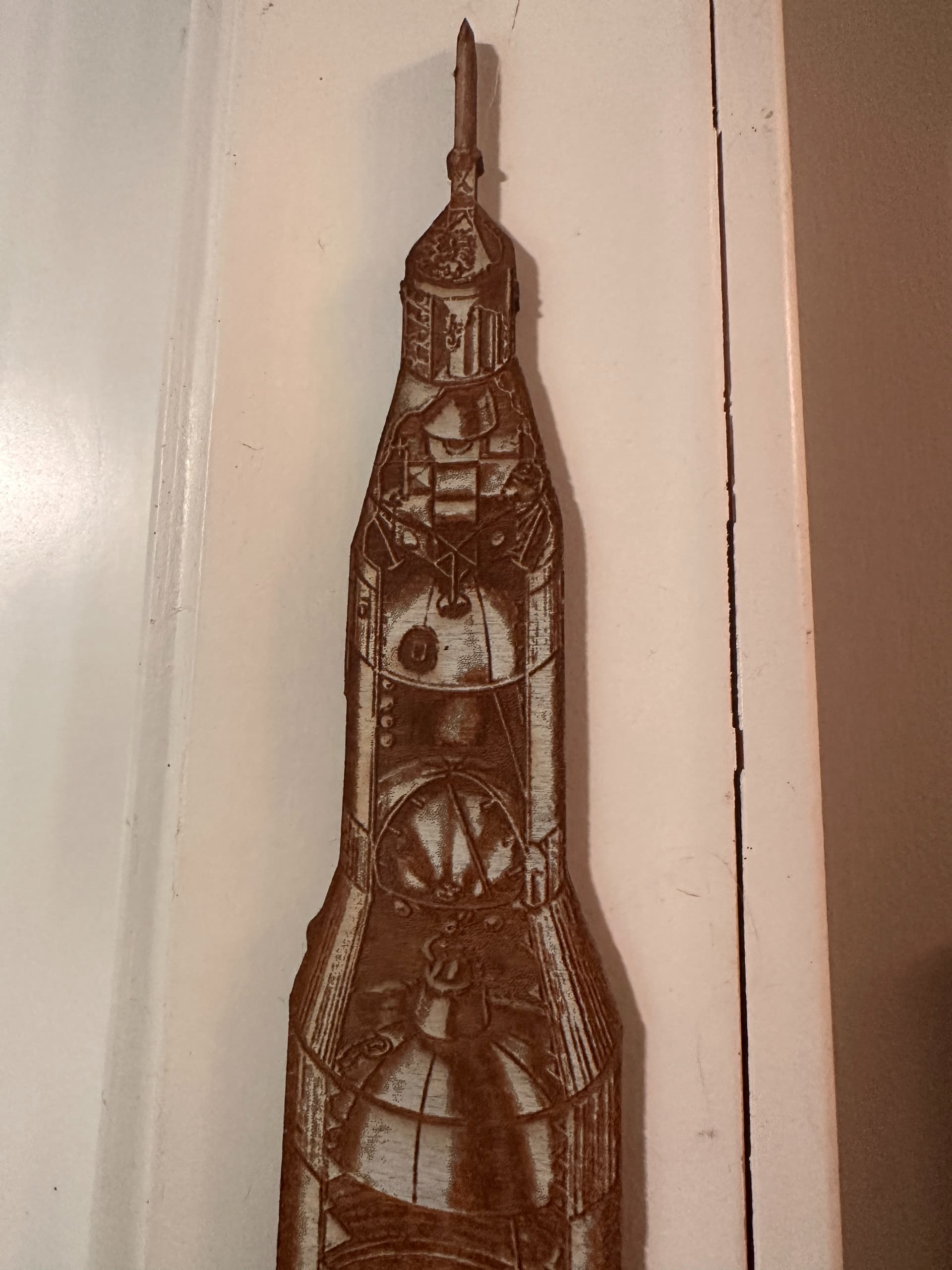

Just took two pics. The Saturn 5 was 4 steps, two skips are here but very hard to see in the pic - I touched them up with a pencil. The Chrysler bldg ones I left alone, as a reminder…
