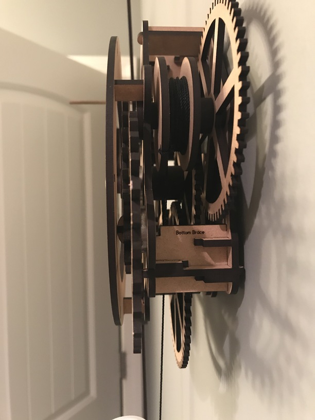

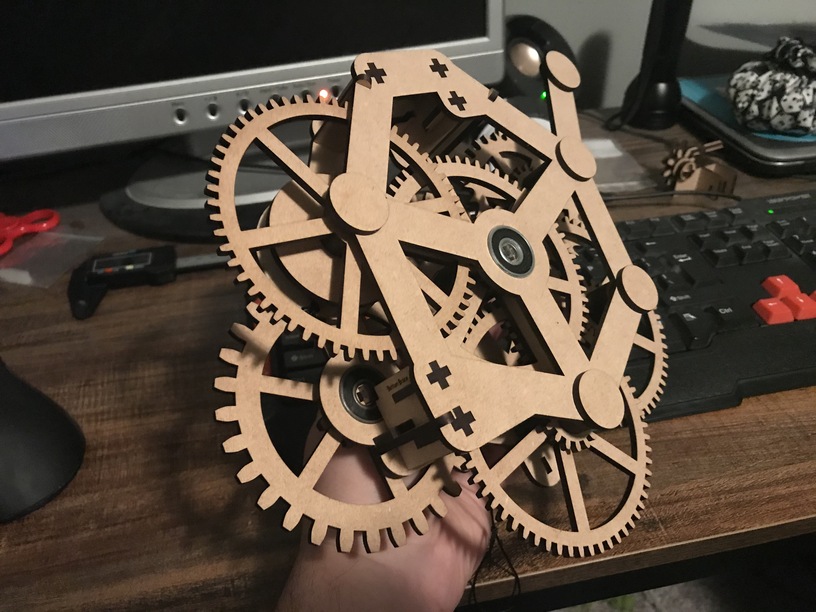

Well, my calculations were off again (I will have to look into that). The holes for the bearings were to small, so I had to sand the frames to get them to fit. But, they are in and the gears have been swapped to the new frame.
You can only see them from the back.
The bearing for the hour-gear seems to make that area too thick. It makes the time hard to set on the clock, and I may need to tweak the clock-face a bit (it doesn’t seem to sit flush anymore.)
Not sure if you can really see it in the photo, but the axle-cap for the hour-gear is now resting on the back of the face, and the bottom brace for the face is not all the way in…
The new frame ran for about 10 hours on its first run, but it was stopped when I checked on it in the morning. Everything looks pretty solid. Not sure why it stopped this time, but I just touched it and it started ticking again. (Next time I will have to examine it without touching it…)

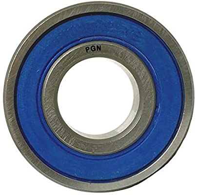

I got the new bearings installed, but if anything things got worse…
I tried to install them without taking the whole clock apart, and I am not sure if that caused a problem or not.
I might still need different bearings, I don’t know. These are “skateboard” bearings, I think. My dad was telling me about “slot-car” bearings that sounded smaller, but they might be too small.
Are there different bearings for slow speeds versus high speeds? These are high speed bearings, but I am not sure if they have more resistance at lower speeds?
I think my next steps will be looking into some “Dry Moly” spray for the gears. Trying to rub in the graphite powder would be to much work. I am also contemplating cutting all the gears out of acrylic.
At the end of his book Brian Law talks about bearings, has a link to the people he gets his from. You might reference that and look for someone here in the US that you could get them from.
Thanks, I don’t think I looked at that part. I will check it out!
Edit: Yep, I missed this part, “The type and viscosity of the lubrication in the “as shipped” bearing is highly significant and represents a considerable drag inside the bearing. I recommend that the grease or oil be soaked out with white spirit.”
I think that is exactly what I ran into. I think the lubrication on the bearings is causing drag.
There are skate bearings and there are skate bearings.
I think the fidget spinner crowd has honed in on the most “frictionless”…
You definitely want unlubricated versions.
Yep… I think I got lubricated ones… I bet that is my problem.
But, I am also thinking the friction may not be where I placed the bearings. I might try without bearings again when I add lubrication to the gears or cut them out of acrylic.
You can soak and rinse lubed bearings in a solvent. That’s how we clean old grease out of used ones before re-packing. Brake cleaner in a spray can is fantastic…
