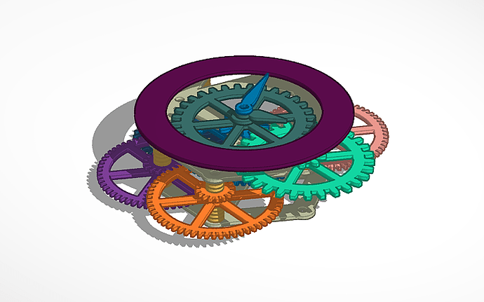

Played with Tinkercad again tonight:
I still need to a pendulum, pulley, and mount for the face.
But, I am tired and need sleep…
