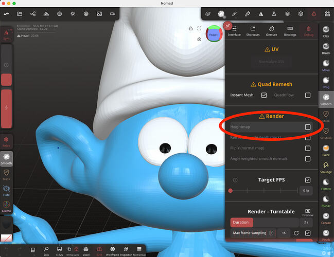

From the clips I’ve watched, Blender’s way feels a bit convoluted. Sculpting programs like ZBrush and Nomad make it virtually 1-click easy.

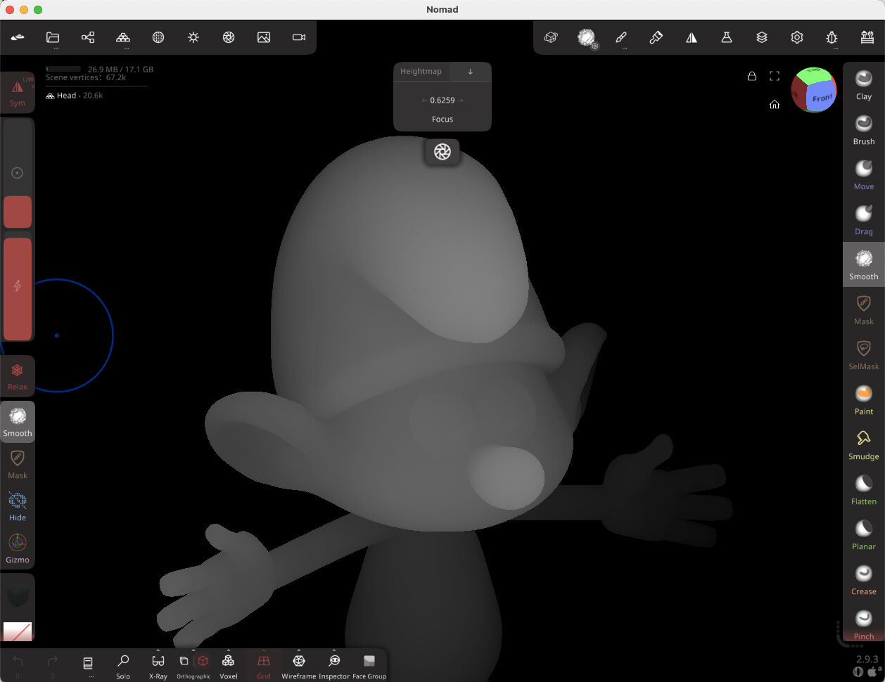

If you sourced a 3D object (whether self-made or downloaded), load it into the sculpting program. In an app like Nomad, there’s a tab option that turns on Heightmap. While in this mode, the model can still be twirled around to grab as many angles as you want.
This way, your height maps will be uniquely yours.
