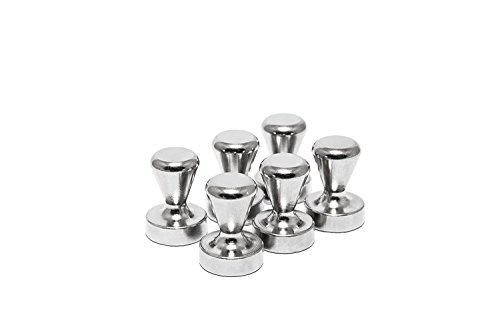

Do you think these magnets would work? I like the handles on them.
Yeah, the handles would be handy. Need to remember that the magnets and material together can’t exceed about 0.57" above the crumb tray, otherwise the air assist port will impact the magnets.
Good point! Thanks.
