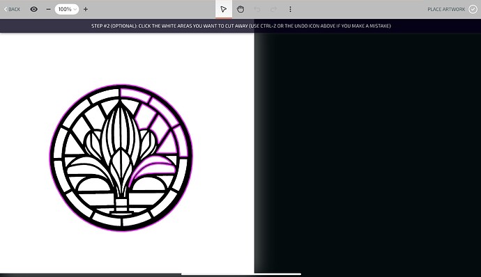

Okay, I looked over your images but since the original design you traced was not in there, I decided to show you with one of mine.
Here is the image I traced:
I printed it on copy paper and put it in my laser.
Step 1: open a new Trace file
Step 2: The software tells you to draw box around the area you want to trace. This is what I see after doing that
Step 3: the software tells you to click where you want to it to cut (I.e., generate a vector cut line), so my first click is in the white area just outside the circle. Notice the pink trace line.
Step 4: click in any interior white areas where you want to generate a vector line. Here I’ve clicked a few of them
And here I’ve clicked them all
Step 5: now click Place Artwork to go back to the create view
You will see two operations. The top one is the engrave, which you will set to Ignore. The bottom one is the cut file which shows all those vector lines.
I think it ended up with a pretty good result, although for myself I’d probably still end up doing the whole thing in Illustrator. Please note that to get this good of a result you need a printout that is very clean, and all the lead lines of the pattern are completely filled in with black. Note also that I did this entire thing on my iPad in my Aura (although doing it in the Glowforge Pro works exactly the same).
