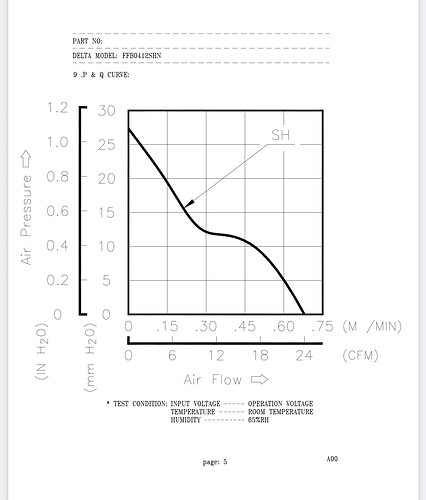

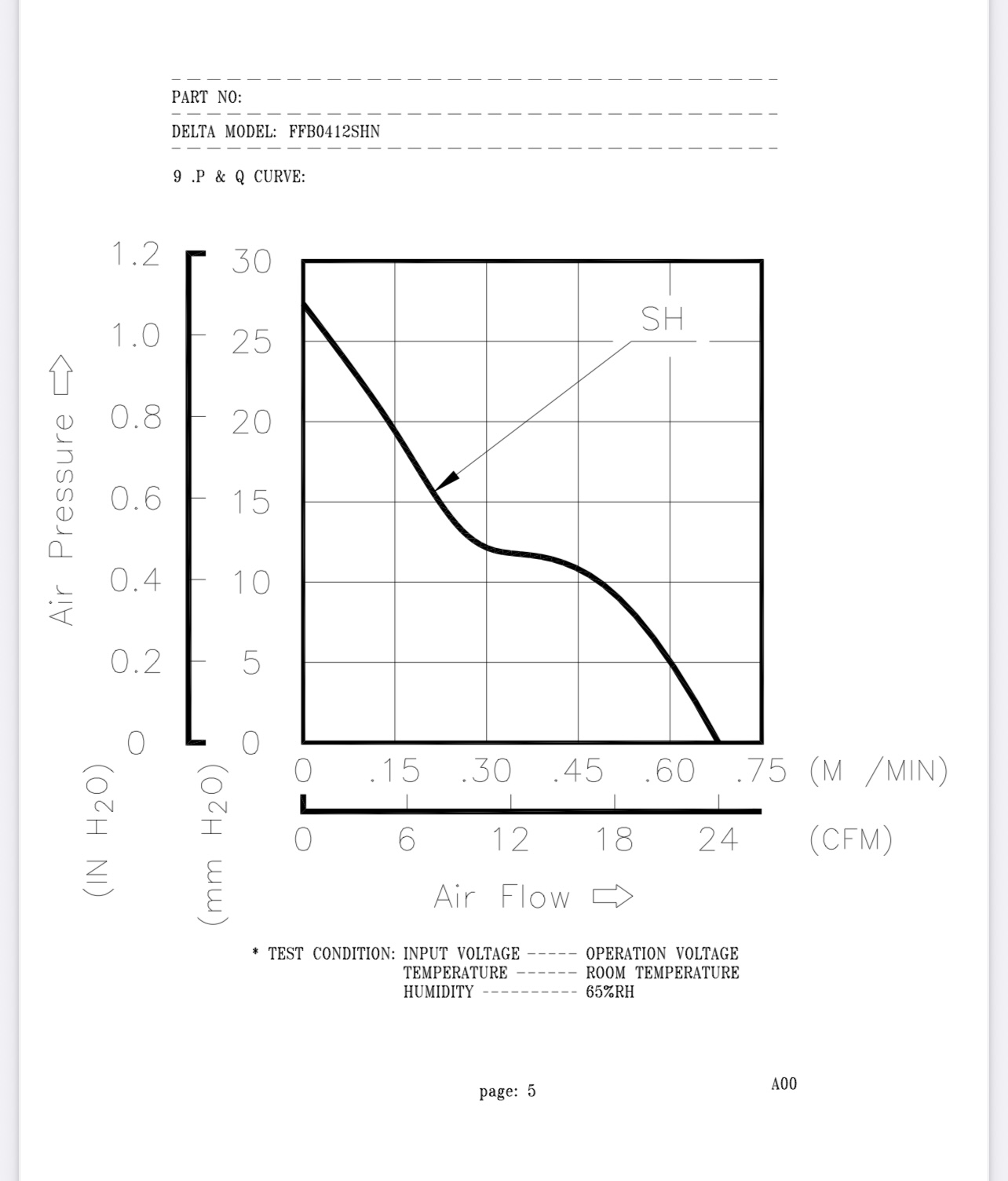

CFM ratings can be tricky. I would probably take a 190 CFM fan that runs at a higher static pressure over one that’s 300 CFM at a lower static pressure. Both fans would be seriously affected by resistance in the airflow path but the higher static pressure fan will be less so.
You have to look at the power curve for the particular fan to figure out what actual airflow you’ll get at different loads. I got into this a bit in the vacuum tray thread but the math gets complicated pretty quickly, and we have very little insight into the actual dynamics of airflow inside the Glowforge. You would need to measure the pressure drop across your fan to figure out what actual airflow you’re getting.
For example I feel like my external S6 fan doesn’t work as well as the internal fan by itself. I think this is because the internal fan leaves so much resistance that the S6 can’t really compensate, especially considering that the entrance and exit are only 4 inches instead of the six. I would imagine that if I were to remove my internal fan that I would get a performance increase, but since I have a pro the heat sink already causes a serious amount of resistance so I’m not sure how much of a gain it would be.
Also because it is a pro removing that fan is significantly more difficult. It just isn’t worth it to me. If I’m doing anything that’s particularly smoky I run both fans, and I do think that that’s an improvement over just the internal fan.
More info about fan specs:
Sample graph of a fan pressure/airflow curve
It’s a little tricky to read that graph but you can see the airflow decreases greatly with even small increases in static pressure. Almost every fan (at least every fan that I’ve looked at) has a graph that looks like this with a sweet spot “saddle point”.
Somebody who’s got more time and experience than I do should probably try to go quantify this for the various Glowforge models. It would be really interesting information.
