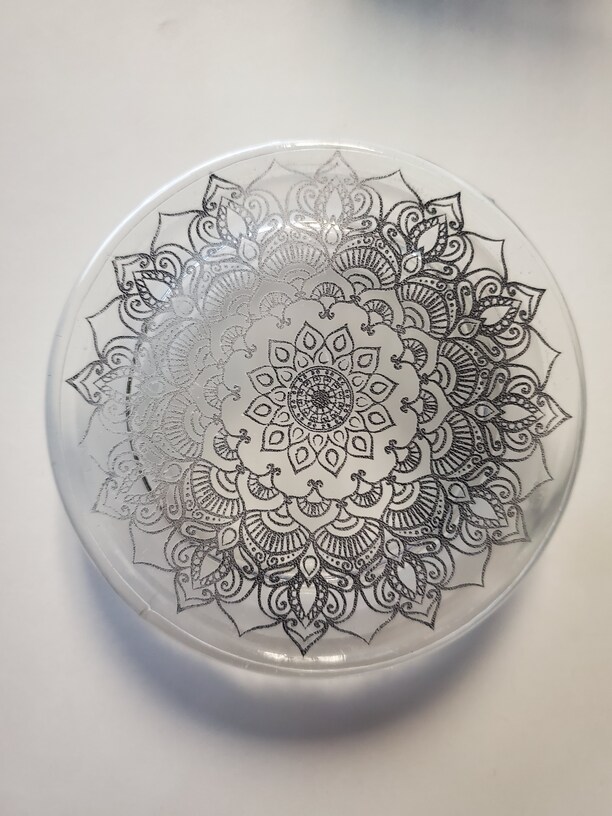

I tried it on steel just to see… HEY! DON’T JUDGE ME!!! :rofl: That was a no-go and I figured it would be. It darkened but didn’t stick.

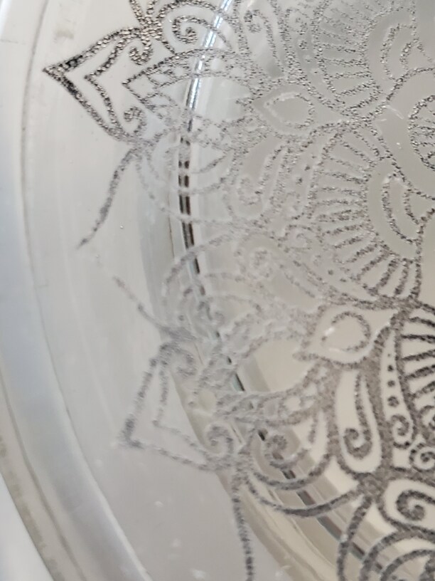

Then I did it on the only glass I could find. Mixed results. It definitely works. But I had some that was sort of faded and some that worked pretty good. I did NOT clean the glass first and that could well be the problem. So test glass yourself.
It DOES seem far more raised than it does on the ceramic tile though so something definitely different about it. But still just as permanent I think.
with the white paint still on it
You can see the left side (which I think was probably on the horizontal plane and not the vertical in the machine. I forgot to mark which it was before I pulled it out) where it’s almost whitish instead of dark.

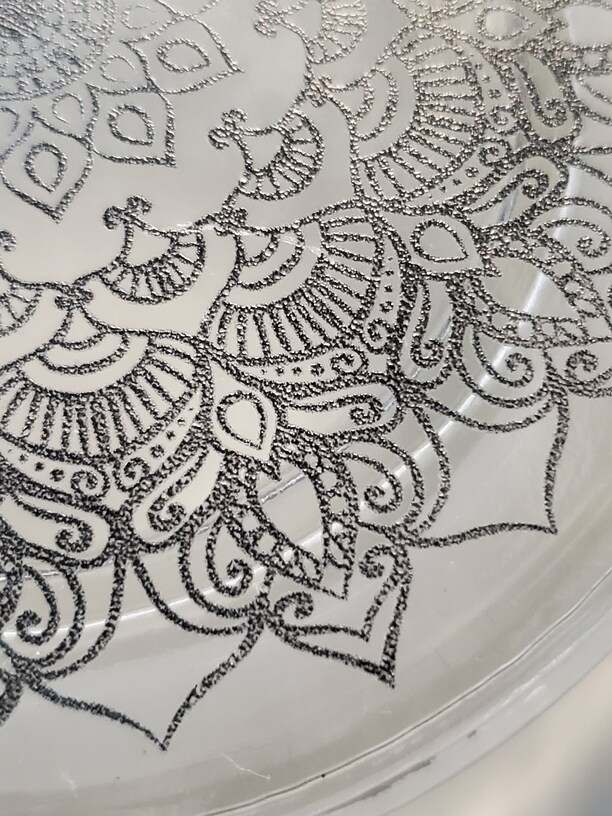

And a couple closeups.
340lpi / 25 power / 225 speed

  1. check out the shininess of the glaze. Even if you are not getting the large divots of regular lasering of tile, I strongly suspect that you are getting really tiny ones, filled with carbon as you burn the paint, so not so different as regular, but cut and paint at the same time,
  2. 2 pews actually work and do “damage” the tile surface so 20 pews may be overkill.

Interesting. I know in the case of the glass candle lid I did, it was not pitting the glass. It is actually raised significantly. On the tile it doesn’t feel divoted but neither does it feel as raised. I tend to lean in your direction that it’s probably etching the tile and filling it at the same time, but whatever else is going on it is incredibly durable as well. Not sure what’s going on with the glass though.
i wonder if what’s happening is at the low power/high speed combo, you’re melting or fusing some of the surface glaze enough to burn the paint into it, but without enough power to cut through the glaze and into the tile itself.
At this point anything is possible. My current guess is sorcery. Though your guess would also explain why paint darkened but did not stick on the steel test. But… sorcery.
