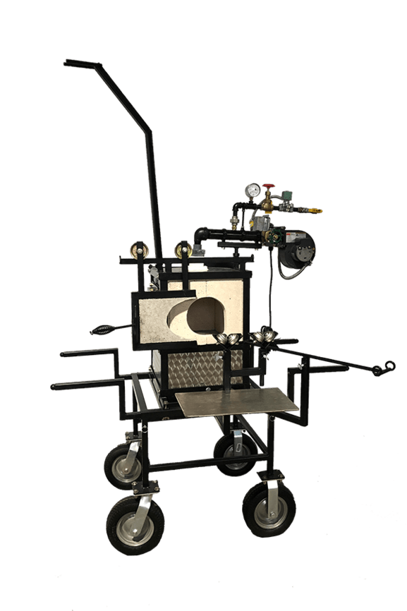

Not that I’m going to encourage you to jump into a new craft…but this is the Glowforge of hot glass work :slight_smile:
“Glory Hole” :grin:
Nah, I enjoy watching the craftsmen, but not enough remaining life minutes for me to venture into that!

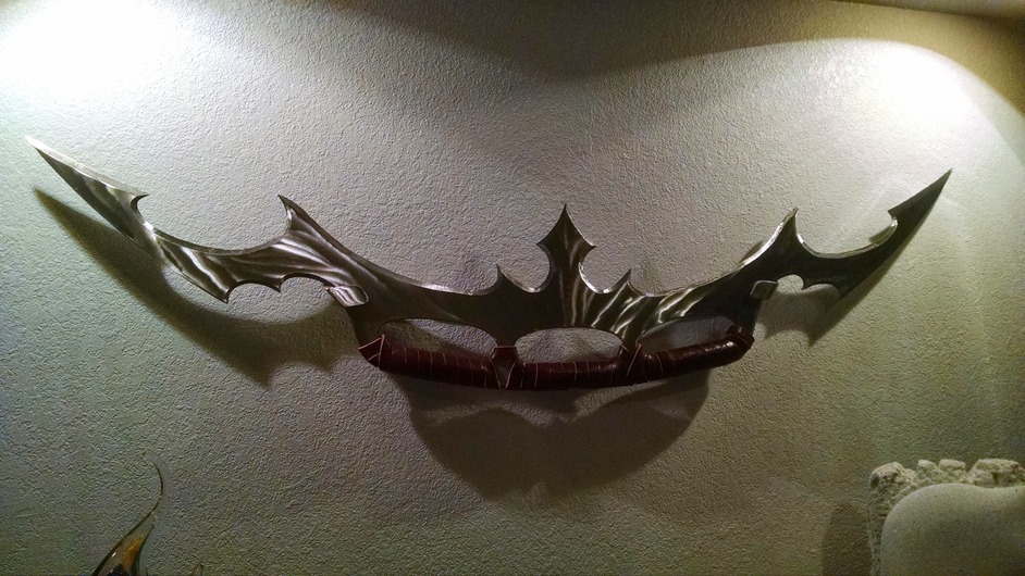

After free-handing another plasma cut Bat’leth I found myself thinking of your rig… :heart_eyes:
Seriously? There’s a reason for making more than one? That’s a 10 minute job. (200 ipm cutting speed)
Are they longer than 4 feet?
What are you making yours out of?
When I first entertained the plasma I thought about doing the freehand process for bears and things. Doable but smaller more manageable sized stuff was definitely going to expose the limitations of my hand-eye coordination :smiley:
I made that first one and my son begged it off me. I decided I would have one of my own. They are 3/16 mild @48" long.
Actually the cutting wasn’t that bad, it’s the edge grinding that hurts.

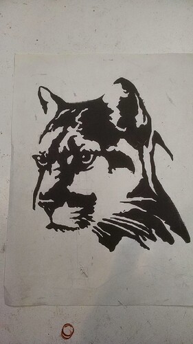

This was difficult freehand. Hard not to melt the thin spots, 3/16, about a foot tall.
(sorry for hijacking your thread @cynd11 :roll_eyes:)
Wow! Super nice.
That would be where my hand-eye coordination issue would present itself :smiley:
The CNC is good because you can get really consistent speeds which takes care of the dross. I wonder if I could create a cutting bevel by tilting the torch in its mount so it cuts at a slant. :thinking:
Thanks!
Oh man. I thought of that, I was thinking the term is gouging? Tilting the torch would be cleaner I think.
Sloppy CNCers don’t get the torch perpendicular to the bed and then complain about the bevel :slight_smile: This would be doing it deliberately to get the bevel. Then it should be a straightforward cleanup with a flap wheel or 1" vertical belt sander for polish instead of grinding to get the bevel.
The final finish could be fun. There are some neat techniques dyeing steel that could be very different than the traditional polished steel with a clearcoat. My blast cabinet isn’t big enough to do a 4ft one though so no powder coating :frowning:
