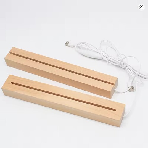

I’ve never done the backlit stuff. I’ve never bought the bases to do it. :disappointed:
You can do it in other ways as well. U-channel can be used as a picture frame. Lay a strip of led lighting in it and bring the power wires out the bottom or back to the power supply (maybe create a wooden base so you can stand it up and use that for hiding the power wires too). Then you get even lighting all around the engrave too. You can get the u-channel at big box stores or even repurpose craft store picture frames. The led strips are all over Amazon and you can cut them to length.
The bases are so convenient and cheap, it’s not worth messing with making one unless the regular bases aren’t suitable. I even took one apart to use the inner components, rather than assembling something from scratch - and I’m an EE.
Bases like these are cheap on aliexpress and look a bit nicer than the plastic bases.
