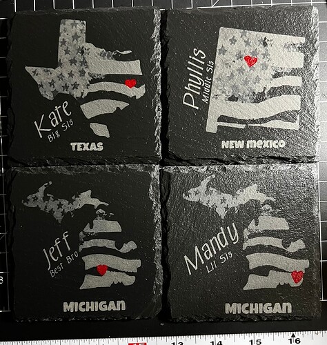

I just want to say how much I appreciate everyone in this community! My first try on slate (I’m still a super newbie with my GF) turned out amazing (at least I think so lol). Gifts for my siblings and myself. So, thank you ALL! You are incredible. :smiling_face_with_three_hearts:
You did a good job on these, and it is obvious that you are going to enjoy having a Glowforge.
Great gifts and you have found the most useful accessory to your GF, this community. Keep trying new things, ask for help when you need it and share what you make to inspire the rest of us. Glad to have you here.

Settings I use are full power and full speed for engraving slate. But the real key is the coating you can put on prior to engraving. In @amanda.smith805 post you can see shine on the coasters. They have been coated and so that is why the engraving turns whiteish and stands out.
I use shellac to pretreat slate. Its food safe and laser safe.
