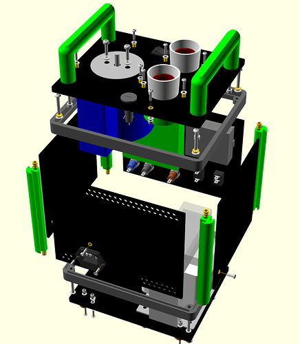

My latest piece of lab equipment that I had to make sans Glowforge.
It is mains power supply that has an isolation transformer to allow safe working on live equipment, a variac to allow the voltage to be varied and a digital panel meter that shows voltage, current and power. Two 100W light bulbs in parallel can be put in series with the output to provide current limiting in case the DUT has a short. There are jack sockets for attaching my Mooshimeter if I want to log the current and voltage or view it remotely on my Phone.
I modelled every part in it except the wire, sleeving and ferrules in OpenSCAD, so is all 100% parametric script.
If I had my GF I intended to make the top and bottom panels from Delrin and the sides from acrylic. Instead I milled it from DiBond as that is what my router is set up for. Having metal skins meant I had to earth all six panels and then make sure everything inside was double insulated. It would be safer in an all plastic box.
Cool render. Do you have a picture of how it turned out?
Spot the mistake I made:
the display is cockeyed. :slight_smile:
Yes rotated 90 degrees. The printed text fooled me into thinking it was portrait but when I powered it up I got a surprise.
bummer as it is rectangular and you can’t just pop it out and rotate it.
Looks sharp though.
I fixed it in the model but because the meter was designed for thinner panels I hot glued it in. I would have to dig it out and desolder the switches and sockets and then rewire them again so I am leaving it for a rainy day.
