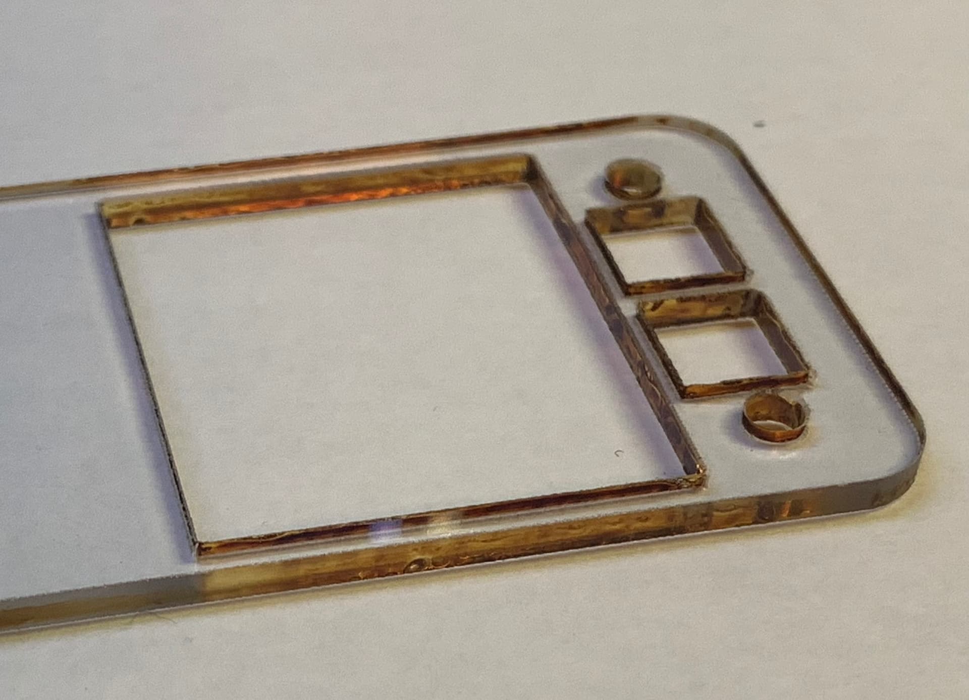

New ultrasonic arrived today. I made similar cuts in the iridescent acrylic. One I immediately cleaned, the other left plain as the control. I used glass cleaner, a toothbrush, and a dab of Dawn dish soap in the cleaning.
control
cleaned
both; control is on L
It helps a great deal, but it’s not perfect. There will be a yellow-brown dinginess at the edges and in score lines. Still, much better than before. Plus, the ultrasonic gets everything else nice & clean.

I recognize that color! Saw the same when cutting what appeared to be clear acrylic:
This particular material was pulled from a ‘too-cheap-to-ask-questions’ bin at a local plastic purveyor. Totally looked and felt like acrylic, but apparently there was something else going on.
Perhaps the plastic we’re cutting/engraving isn’t actually acrylic… polycarbonate?
That would be my guess as well from the color.
