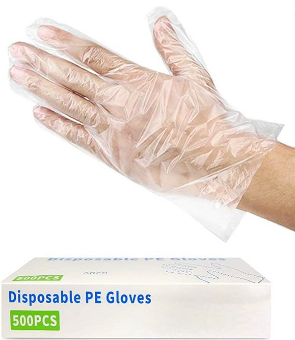

To clarify:
CA glue DOES stick to nitrile.
If you get enough CA on a nitrile glove, the heat from fast curing can destroy the glove and glue little bits of it to your fingers.
CA glue does NOT stick to polyethylene gloves. That’s these kind of things:
Nitrile gloves are great PPE, and I use them for all sorts of other things, including working with resin prints, keeping paint off my hands, keeping PVA glue off my hands, working with wipe-on poly, etc.
In addition to standard nitrile exam gloves, I also keep some heavy-duty ones around for certain types of things.

I am concerned that I might still be creating confusion. If you want gloves that CA glue won’t stick to, you need something like these:
https://www.amazon.com/ForPro-Professional-Collection-All-Purpose-Non-Sterile/dp/B0CMSX29JK/
The link in my previous post was for some heavy-duty nitrile gloves. CA will stick to those.

I only use the cheap poly gloves when doing glue ups (of any kind) and they’re so cheap i don’t mind tossing them when they’re still “perfectly good” The loose fit isn’t a problem for that. Nitrile gloves are for when I want dexterity and durability because I’ll be wearing them for an hour or more.
