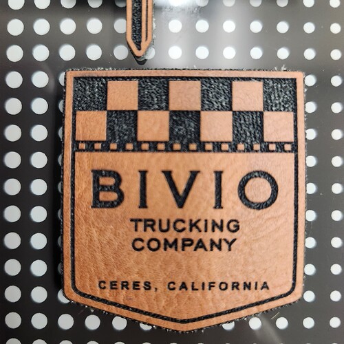

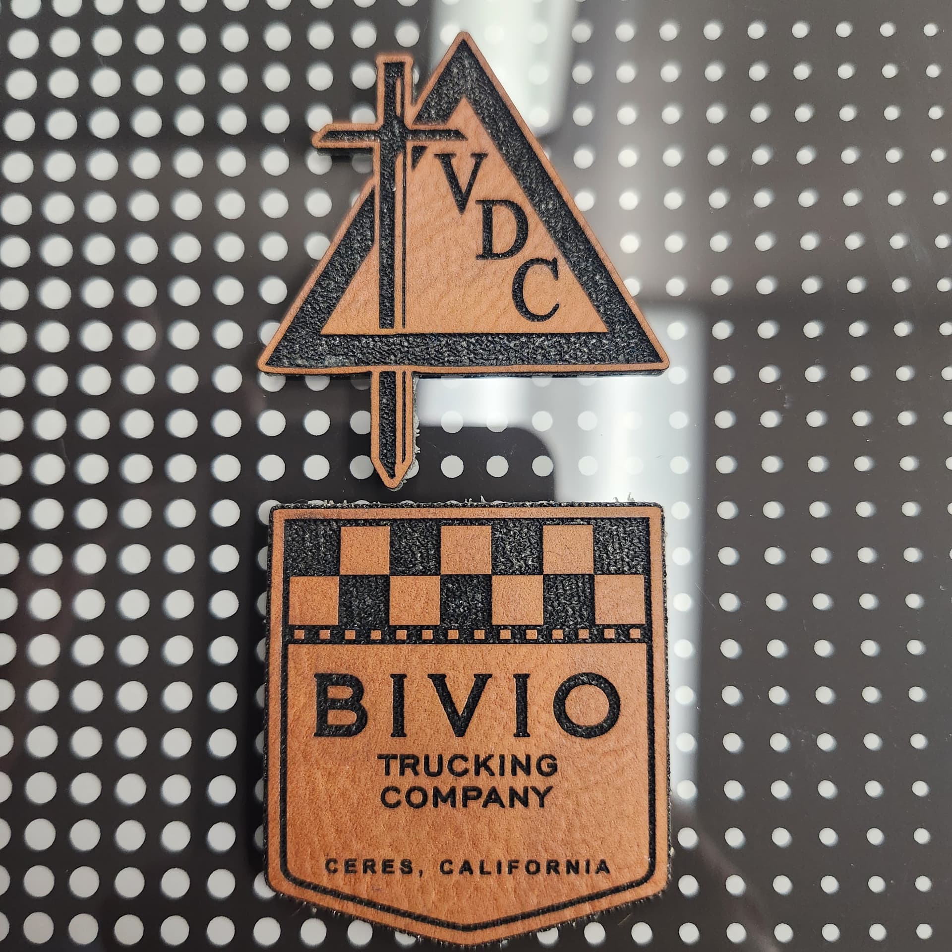

Trying to get the best and cleanest laser engraving possible, Not bad on guessing how they would turn out. Now time to press them to the left panels as these are customer samples.

Did you use any form of masking? If not, did you have to clean them?
Welcome to the forum! Those turned out really nice, and I’m sure your customers are very pleased with them.
Those look great, so crisp and clear!
Yes I had to use Awesome on them to remove the smoke. I am going to use a masking on the next one to see if that helps because of using white leatherette. Dollar general has the spray in a bottle for $1.00.
Ah, is this the stuff?
https://www.dollartree.com/las-totally-awesome-all-purpose-cleaner-20oz/152664
What were your settings for these? Speed/Power/LPI?
Speed - full
power - 70
Lpi - 270
