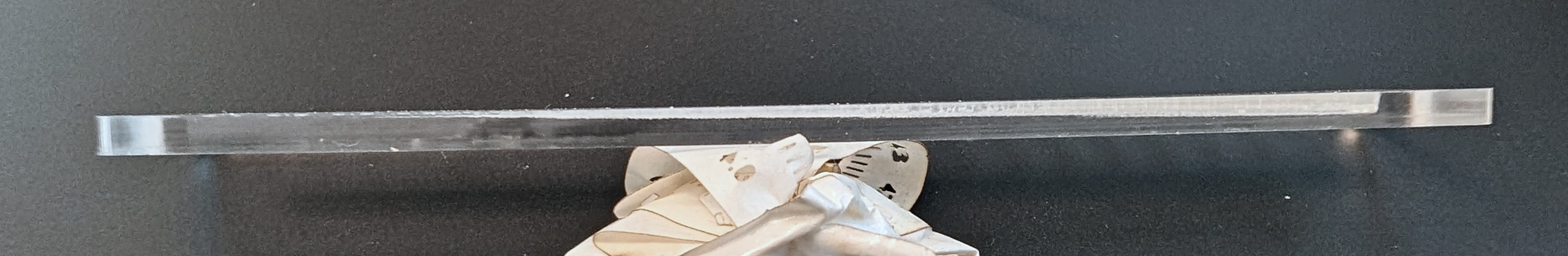

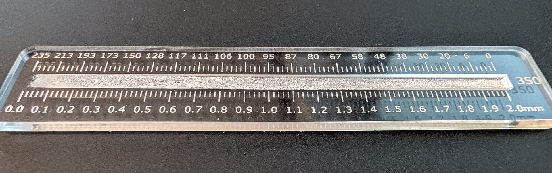

Lately, I’ve been using the 3D Engrave feature to create accurately contoured recesses in acrylic. After several failed attempts to get the desired results, I discovered that the relationship between grayscale value and engrave depth is surprisingly non-linear. So I had to bite the bullet, make some test pieces, measure the results, and try to map grayscale values to engrave depth.
Grayscale values typically range from 0 (black) to 100 (white). Keep in mind that the relationship between grayscale value and laser power is inverted, so a value of 0 (black) is full power and 100 (white) is no power.

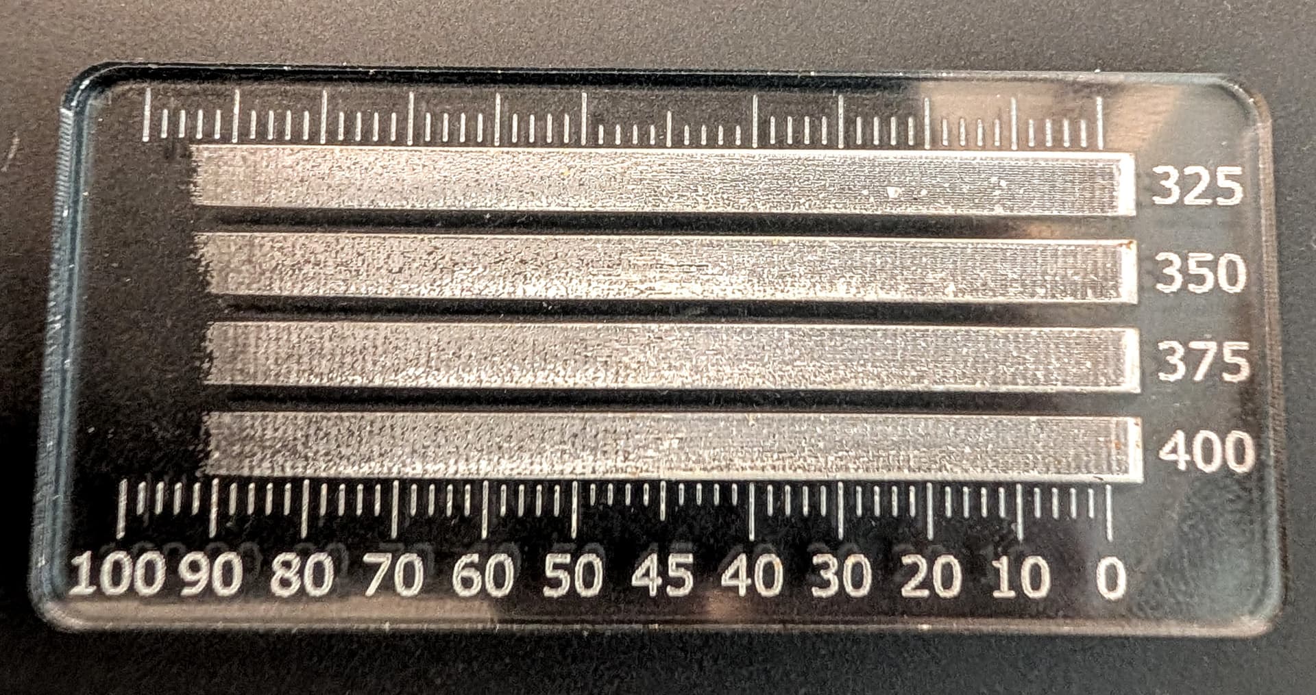

Here’s what I found: starting at a value of 100 (white), with Min Power set to 0, the laser doesn’t even make it through the backing above a value of 92. Engrave depth increases gradually from 92 to 50. From 50 to 40, engrave depth increases dramatically. This 10% of the value range accounts for 30% of the engrave depth range. After that, engrave depth increases fairly linearly from 40 down to 0 (full depth).
Keep in mind, these are just my results on an OG GlowForge, cutting PG acrylic–you’re mileage may vary. I haven’t tried doing this on any other materials yet, perhaps this non-linearity is unique to acrylic. I’m wondering also wondering if this non-linearity also applies to things like cut depth.

I think I’ve got it dialed in now. Running at 350/full, I’m within about +/- 0.05mm, some areas being better that others. @evansd2, I tried tweaking the final gradient stops in RGB mode (0-255), not sure if it made much of a difference though. I feel like I’ve been chasing my tail for the last few iterations, trying to eek out some precision/consistency that’s just not there.
There’s definitely something funny going on in the 50-60% power range. You can see that it gets a bit lumpy around 0.5-1.0mm. As the laser scans across the gradient, you’d expect it to smoothly dim and brighten, but it doesn’t! The laser visibly flickers as it passes over that trouble area. Weird. Perhaps there’s some proprietary magic going on, like transitioning from one modulation regime to another.
