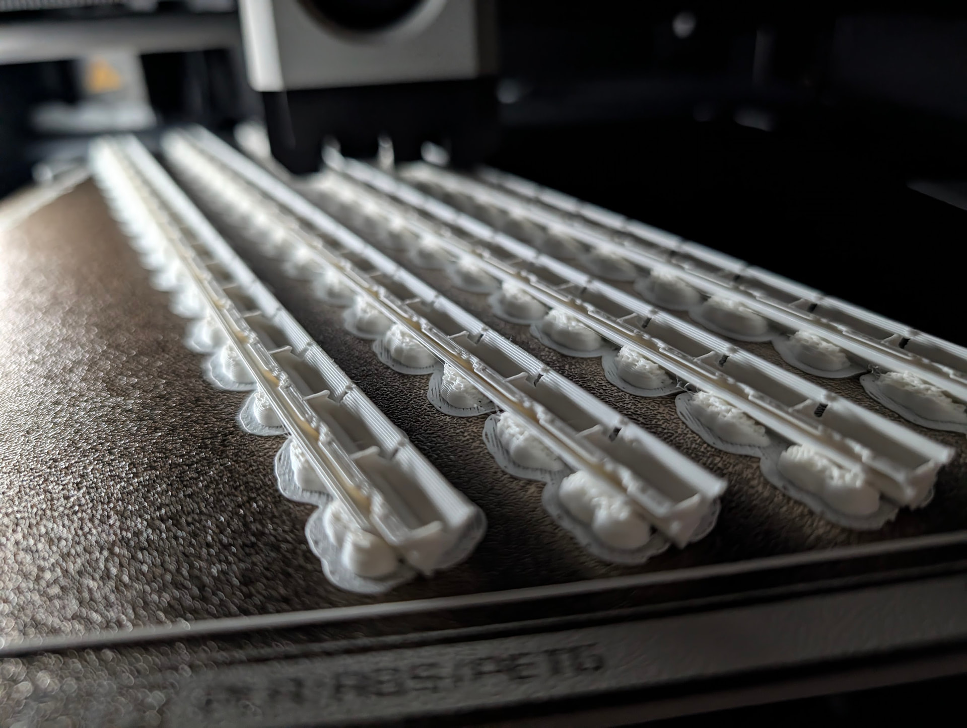

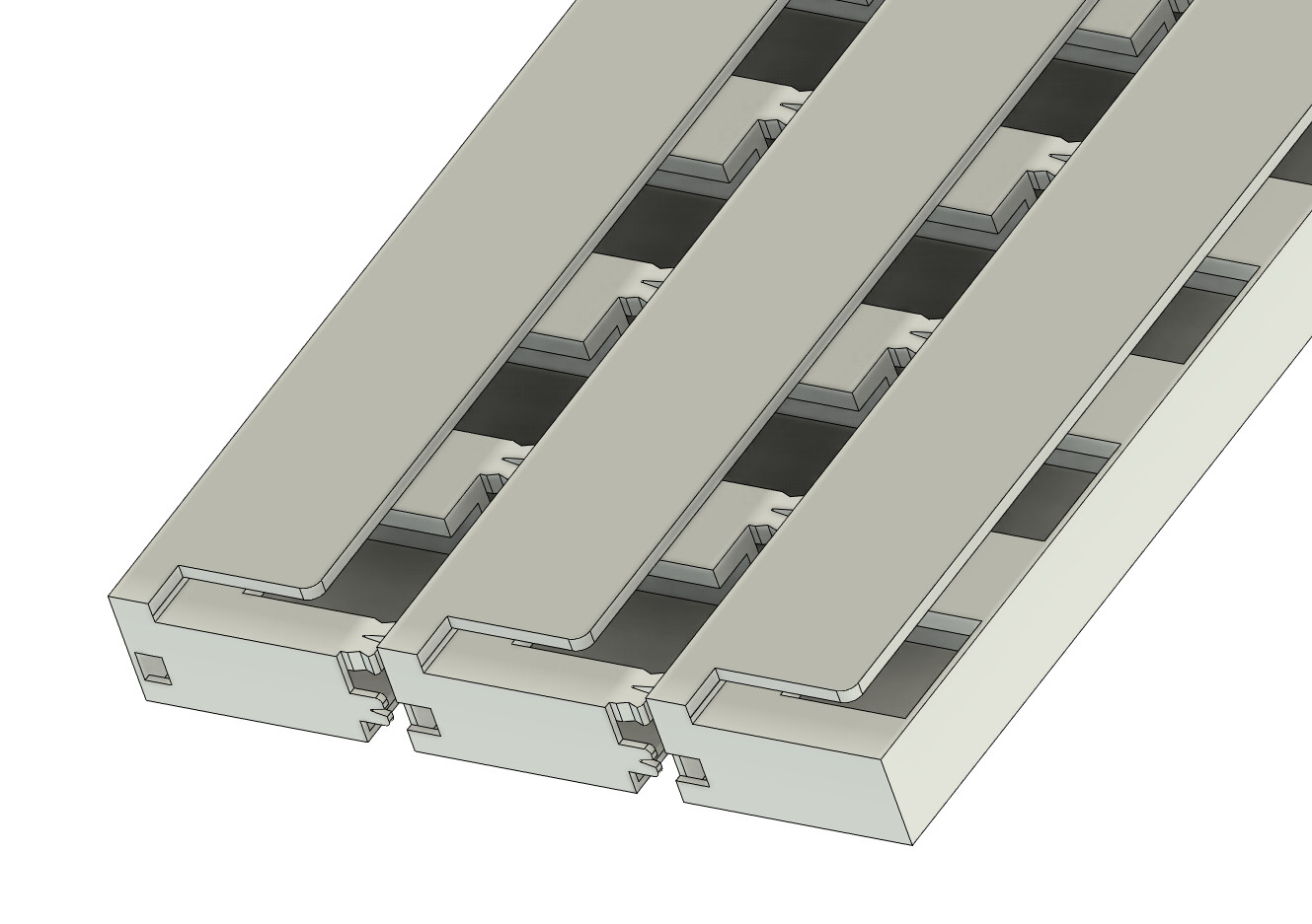

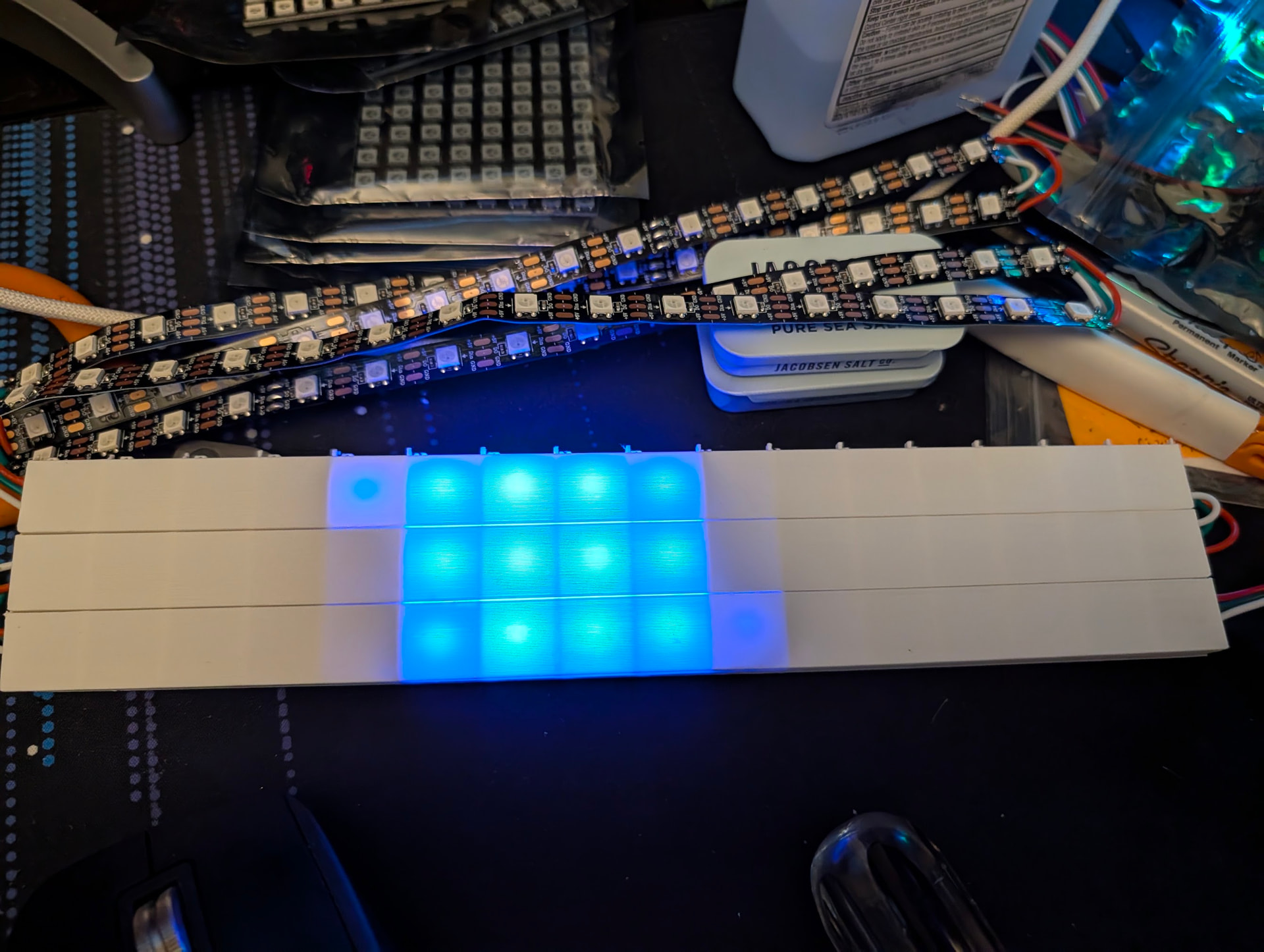

Sometimes I reach for a tool by habit instead of stepping back and thinking through my options. Will I convert this 3D-printed light panel into a laser cutter design instead of continuing to wait on multi-hour prints? Hmmm. I’ve got a design that works well, so maybe not. But maybe? The laser cutter is SO FAST compared to the 3D printer, but a good design (e.g. I like to avoid glue) can take significantly longer to lock down.
Also, if you aren’t already rotating your 3D printed designs by 45 degrees to avoid internal supports, this is your notice to try it. This snap-together-columns design has an internal floating “shelf” that holds the pixel strips in place, and internal supports would be unreachable. Rotating the whole column by 45 degrees lets me print “floating” internal structures with no supports. The outside tree-style supports snap off cleanly.

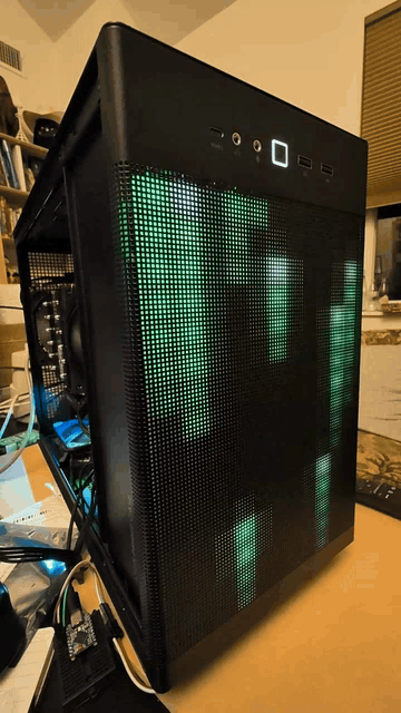

This part of the build is temporarily installed…
PXL_20261003_024225440
That is so cool. I’d steal the idea but my PC sits wrong for this to be seen.
@timjedwards - I’m confused. Can you explain in easy terms (cause my brain isn’t that smart!) why rotating something 45 degrees would change internal structure when you’re not adjusting the outside structure? Are you just rotating it on the print bed or is it in designing the structure itself?
@dwardio - you’re right. I don’t recall if the “they” was just comments I’ve read, or whether it was from a manufacturer (Bambu, Sunlu, whomever). I’ve found that even within the FD group. I’ve read where you NEED to use oxygen absorbers in EVERYTHING, including vacuum sealed jars, but every time I use them, especially in mylar, everything goes soft and I have to throw it away. One of the “experts” in the group, “FDing for 10+ years”, says that if you don’t use an OA, even though the food may still be dry and the jar has been vacuum sealed, “you lose the nutrition.” That I can’t understand why you would lose nutrition when the jar is vacuum sealed. I quit using OAs, as I almost always use jars, and I know there’s a good vacuum because I have to pry the lids off. And strangely, even the food I’ve put in mylar without an OA has remained nice and crisp. I had done a batch of green beans right after I got my FD, and forgot to put the OAs in. The next batch of green beans I did, I DID put the OAs in, and within 6 months, those were soft and I tossed them, as I opened one bag and it had a bad odor, hence the tossing. So yeah, “They” is something I should avoid listening to. Except for the people in here, of course! I totally trust y’all!
3D printers can do small overhangs (where the hot filament is not supported by anything below) but only a very small distance before things start to sag. So if you print an angled object (e.g. a “V” shaped wall with the point on the print bed), each progressive layer’s overhang is small, supported by the layer beneath.
So when you have hard-to-support structures that are parallel to your print bed, rotating the entire design results in angled walls that can use this principle to print with no temporary support required.
Another benefit of this technique is that it alters the seam lines relative to the design, which can lend strength to delicate structures which might easily snap otherwise.
@ellencadwell You know how wood is much stronger along the grain than across it? Well, FDM 3d prints work the same way. Not super important if the design is decorative, but if you are going for strength, it becomes paramount.
The strength of FDM 3d prints runs along the X and Y axes, with the Z axis being weaker, or much weaker, depending on the design and the filament.
If you are still scratching your head, say so, and I’ll post with illustrations.

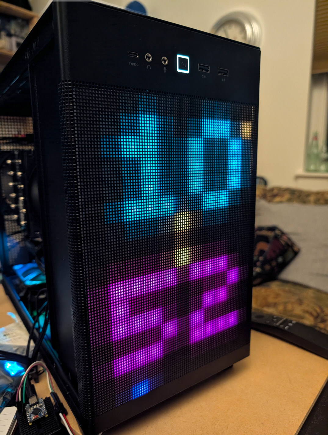

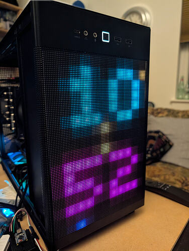

As I was assembling this PC the all-mesh case with snap-on panels was whispering ideas to me the entire time.
This front panel mod is so fun! Here’s a quick little clock app with NTP that stays active even when the PC is asleep…
I’m loving this, I’ve been thinking on what to do above my center monitor as my monitors are currently mounted L-R vert, horizontal, vert, making a U shape with free space above the center.
You are about to convince that adressable LEDs are the way to go!
@timjedwards - okay, that makes sense. The LEGO illustration helps!

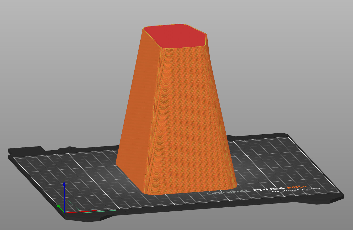

Okay, now time for illustrations. This is body one; I just made it for this.
Body one is sitting in the orientation that’s easiest to print, but let’s say it will be stressed to break along its xy (as it sits, this orientation is the weakest because of the layers).

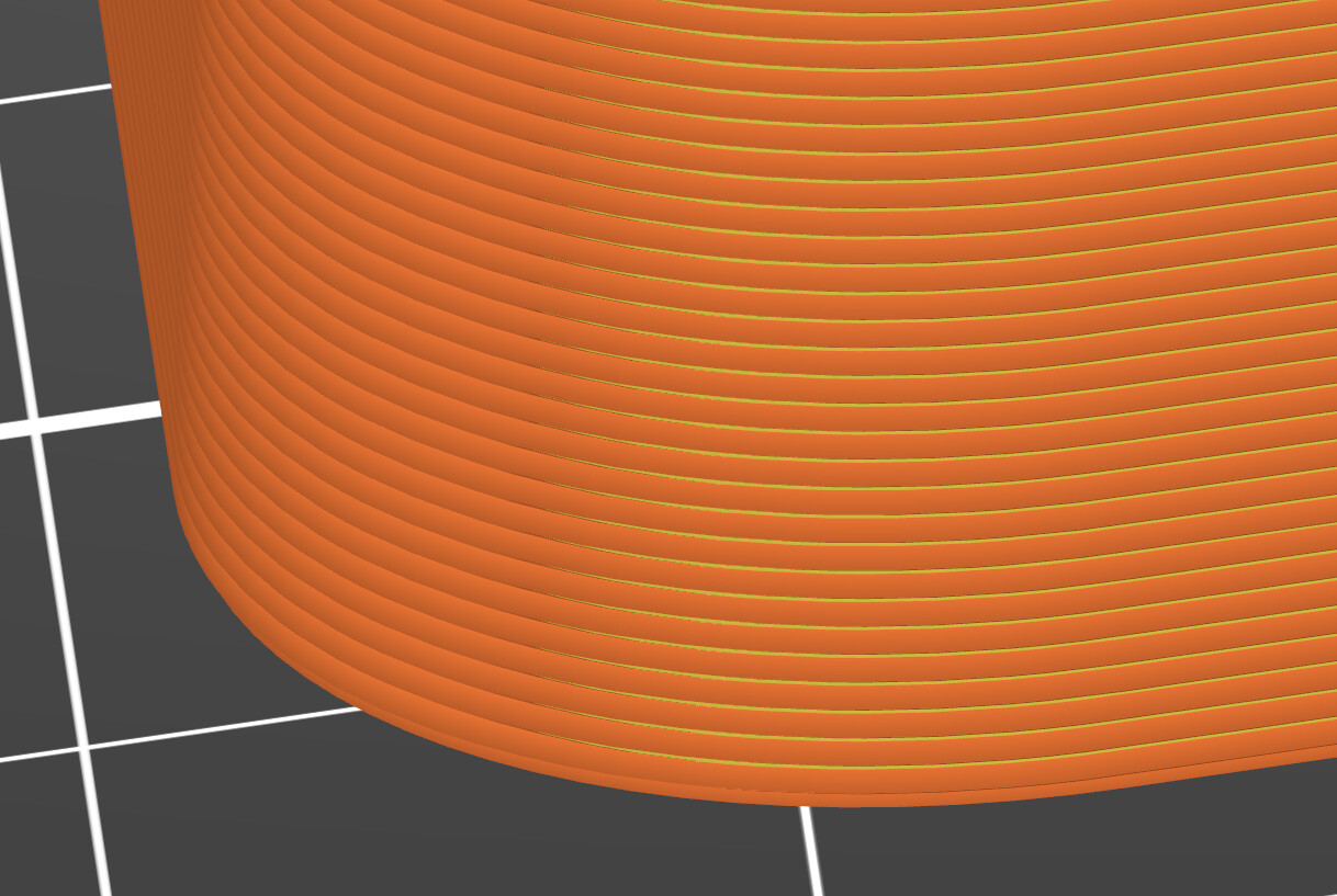

Here we are zoomed way in to show the layers; it will break the easiest along those lines.

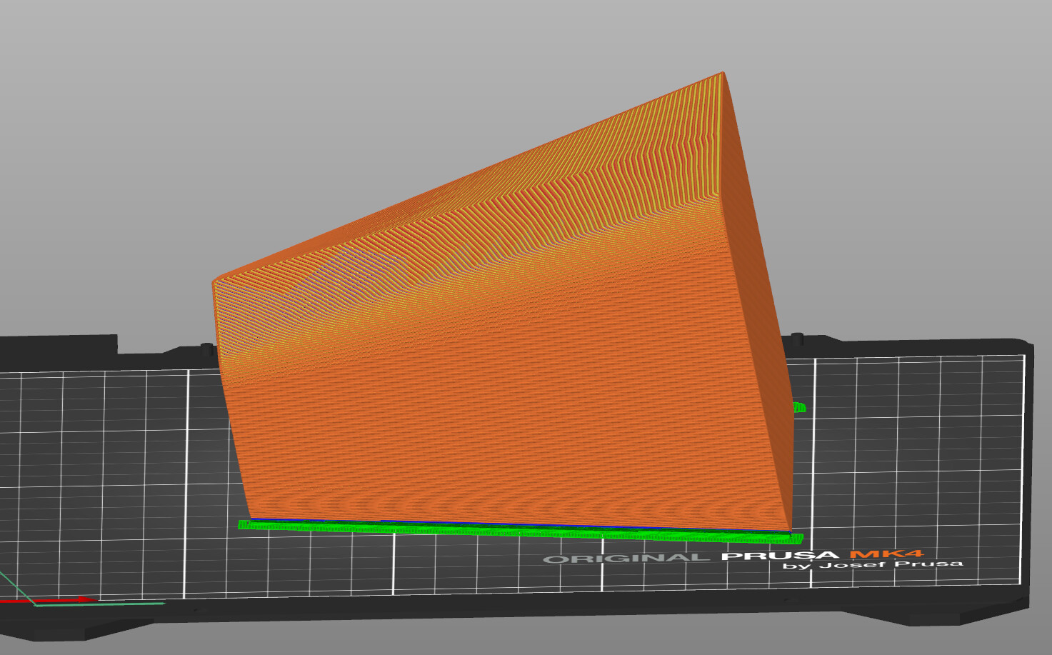

If we put it on another flat face, we add a lot of strength and only need a little support.
The support is in green below.

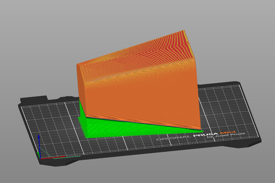

Now, if strength is number one in our needs so we don’t care about using significant support material or long print times we would place it like this:
I hope that helps. If it’s still not clear, ask away, and we’ll get there.

Okay, that makes sense to me now. Of course, then I’d have to worry about how to design the support to get it to the right height! And wouldn’t it need some type of tree support in the middle of what is actually the bottom to keep it from collapsing? Or am I overthinking it? I have seen designs where Bambu says it’s best to reorient something, but maybe that’s on multi-color designs where it builds the tower next to the design (can’t think off-hand what the tower is called).
