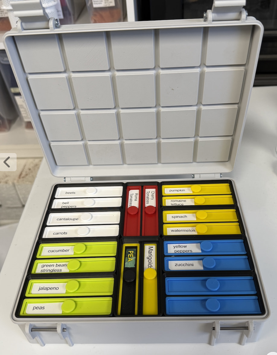

So I found this lovely little item on Makerworld for holding our garden seeds. I also used the link he had for the case. His design actually has where you can print the seed info right on the lids, but I chose to just print labels. It wasn’t until I did the peas and needed a second container for them that I thought about just cutting the info off the label, which I did afterwards, but some of them wouldn’t fit anyway because of the way they were printed on the package, so I’ll stick with my own printed labels.
The individual boxes sit in a 1x2 gridfinity case that has a divider in the middle. But Marc had trouble grabbing the knob (he’s got bigger hands than me) as the knob was even with the divider, which is lower than the sides of the case. So I added a little height to it (the red box), and now the top of the box is even with the divider, but the knob is still below the case edge, and it made it easier to grab.
What’s great is that the lids have little notches in the middle that keep it from sliding all the way out unless you want it to, but basically they open half-way or wherever you slide it open to, and snap closed nice and tight. No more fumbling with little paper packages and trying to keep them folded and keep the seeds from spilling out. And I don’t have to worry about moisture getting to them. And they hold a LOT of seeds (except bigger ones, like peas or green beans).
The hardest part was that there was no mention of what to use for the hinges and latch. We ended up using #6x1" wood screws (#6x1/2" would’ve worked better, as Marc had to cut the screws to length) for the hinges and top of the latch, and I think he just used a piece of fencing metal for where the latch hooks.

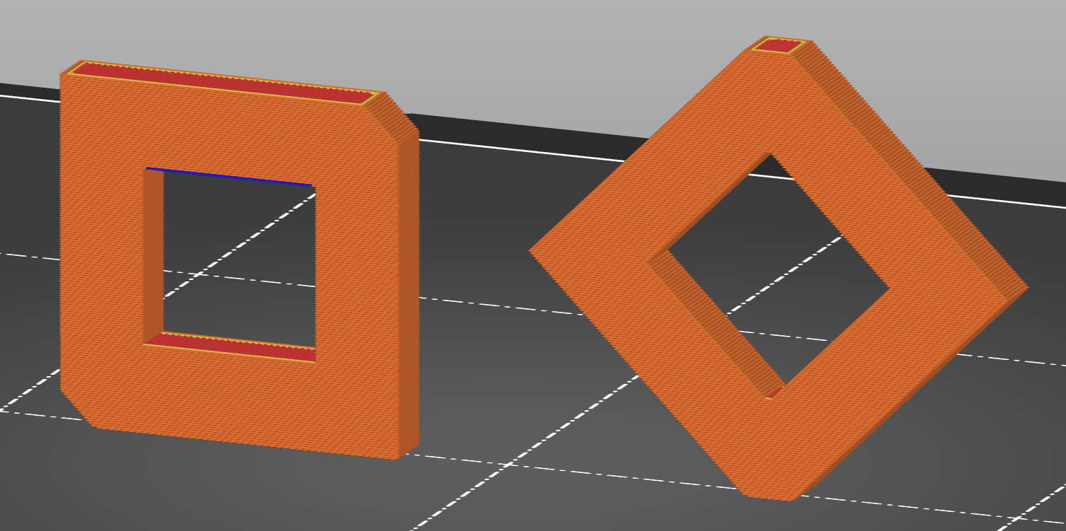

Well that all depends on the load axis, if that was in compression in Z that would be strong.
If you are using Fusion (most CAD programs have some sort of analysis function) you can put a directional load on your model and find the stress points. In fusion it can be a static load or dynamic (If I recall the dynamic costs credits while static doesn’t)
I’d add you are discussing non-isotropic polymers (like PLA). When you flip to engineering plastics like Polycarbonate or Polyamide (Nylon) you have hydrogen bonds between the polymer chains, these are equally strong in all axes. If strength is all you need for a functional part, polymers like Tullomer (a crystalline aramid) is stronger than tool steel by unit area, and is also isotropic and actually not crazy hard to print.

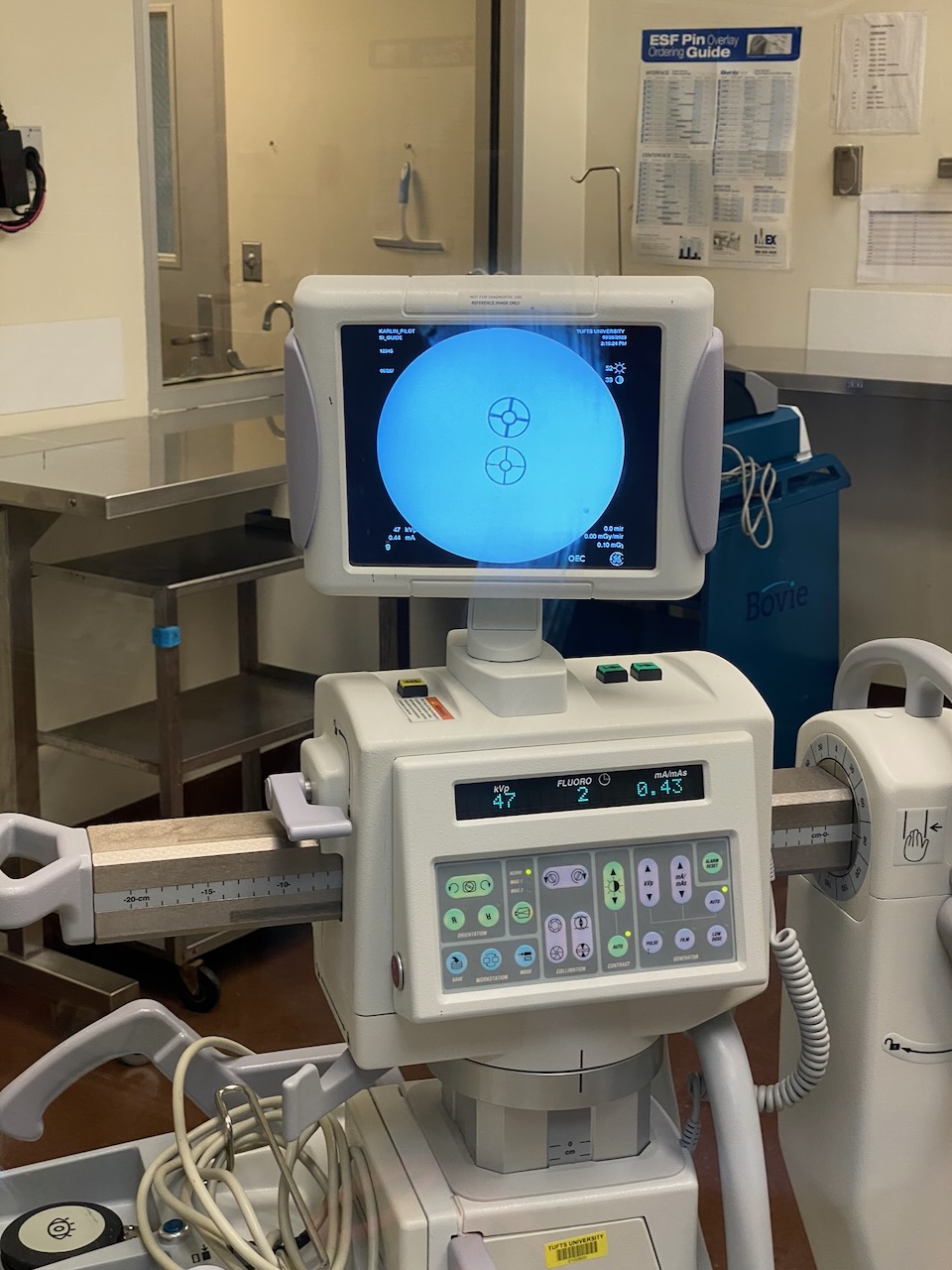

On the opposite end of the spectrum I have printed in Tungsten-PETG, which is 75% tungsten by weight (which isn’t hard since it is 1.6x dense as lead) and it is radiopaque. Used for radiation shielding applications. We made all sorts of gadgets to go in the x-ray beam, and even steel didn’t hold a candle to it for function. Unfortunately with supply chain shenanigans, the spool I have at home which was $175 way back when, is now like $1300. So not printing a benchy with that! But it’s always fun to hand someone a small plastic part and watch them almost drop it as it weighs like a pound. But I can only really print it using my diamond nozzle as tungsten will happily tear up hardened steel nozzles. For comparison the top of the x-ray picture is the tungsten-PETG and the bottom is tool-steel. The flat blades are about .4mm thick and still are totally opaque.
