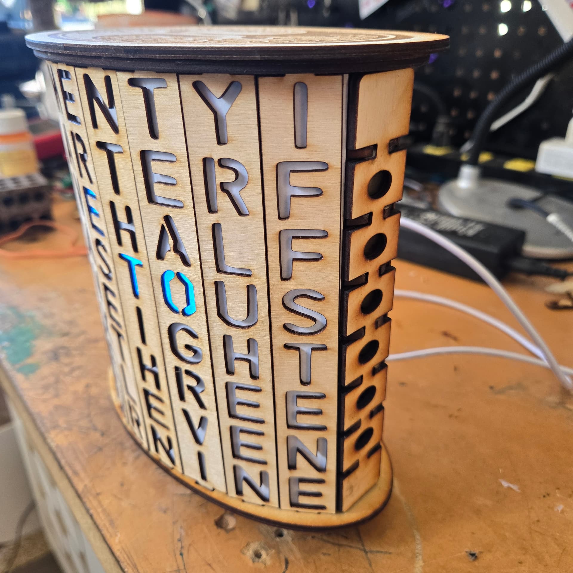

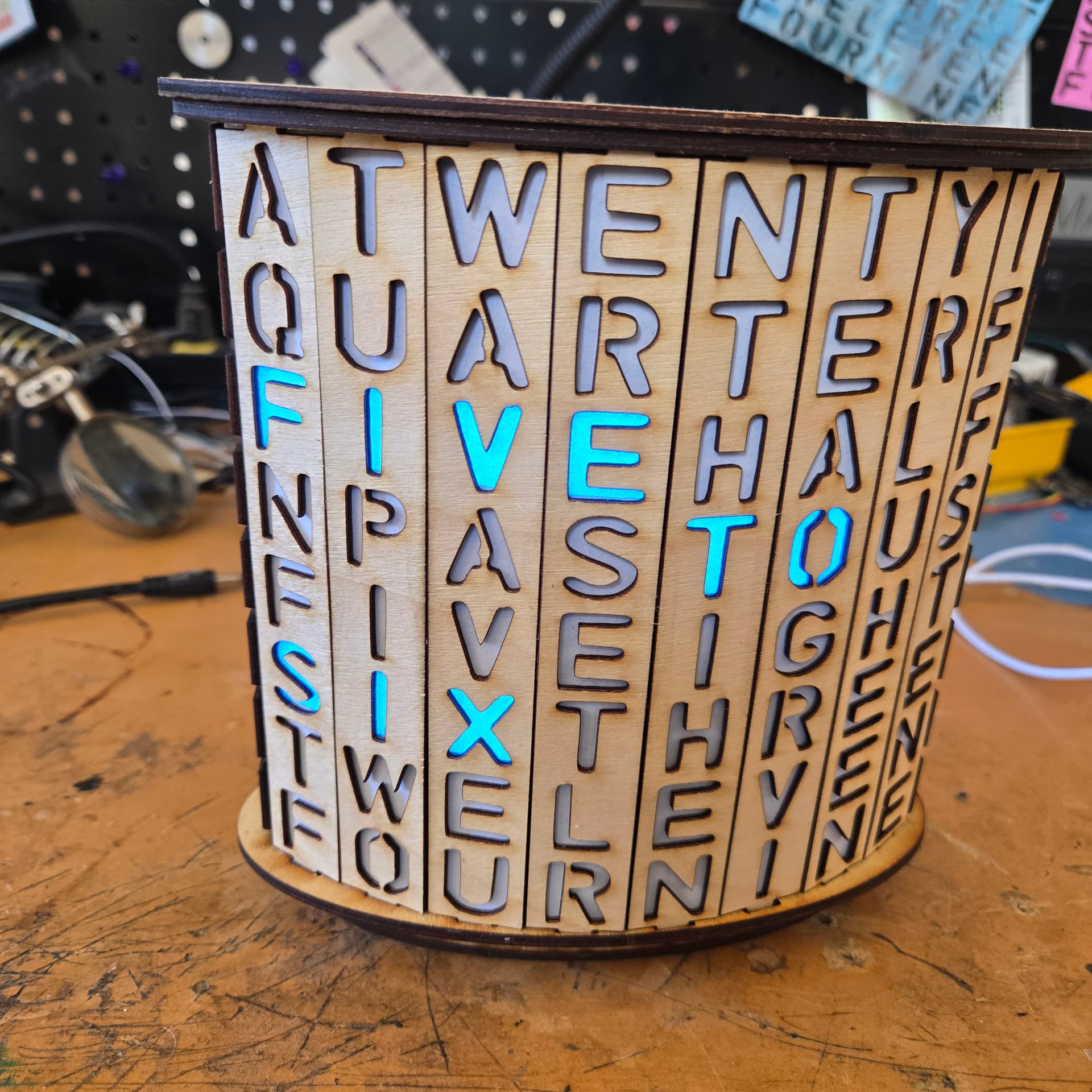

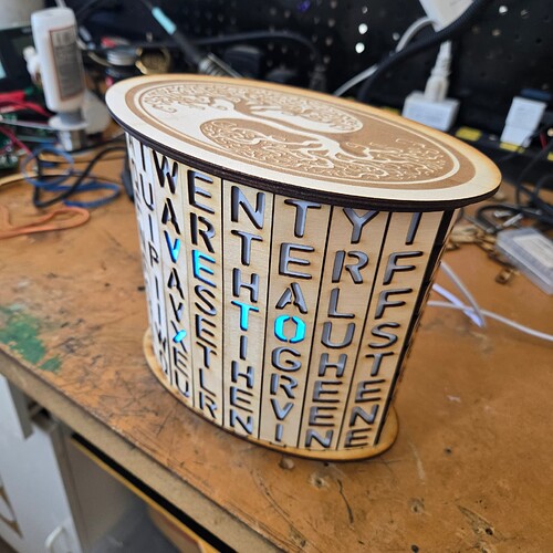

Yet another wird clock. This one morphed my 2 -sided spirit lamp design into a word clock.

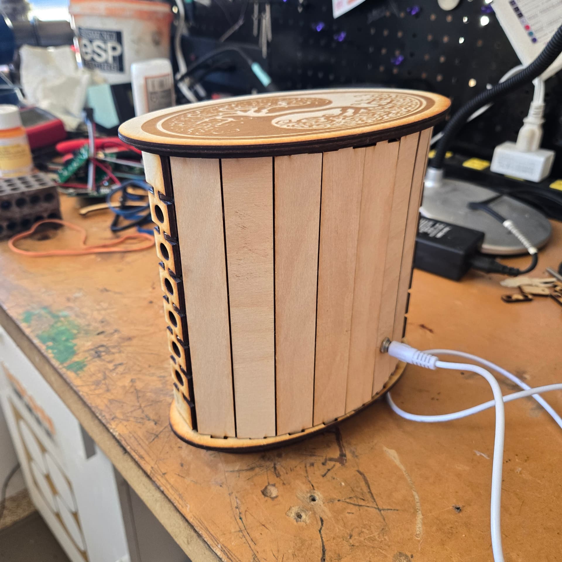

That’s cool. Did it turn out the way you wanted? It seems like it’s a little harder to read than the traditional flat-faced types, does it work out that way in person or is that camera distortion?
Good question. It is a tad harder to read from side angles but on par with early flat faced clocks that used 1/8 thick material for the faces. I used 1/16th ply for the letters which helps make up for the issues caused by the angled portions.
Unlikely to build a lot of these vs flat face but it was a fun adventure.

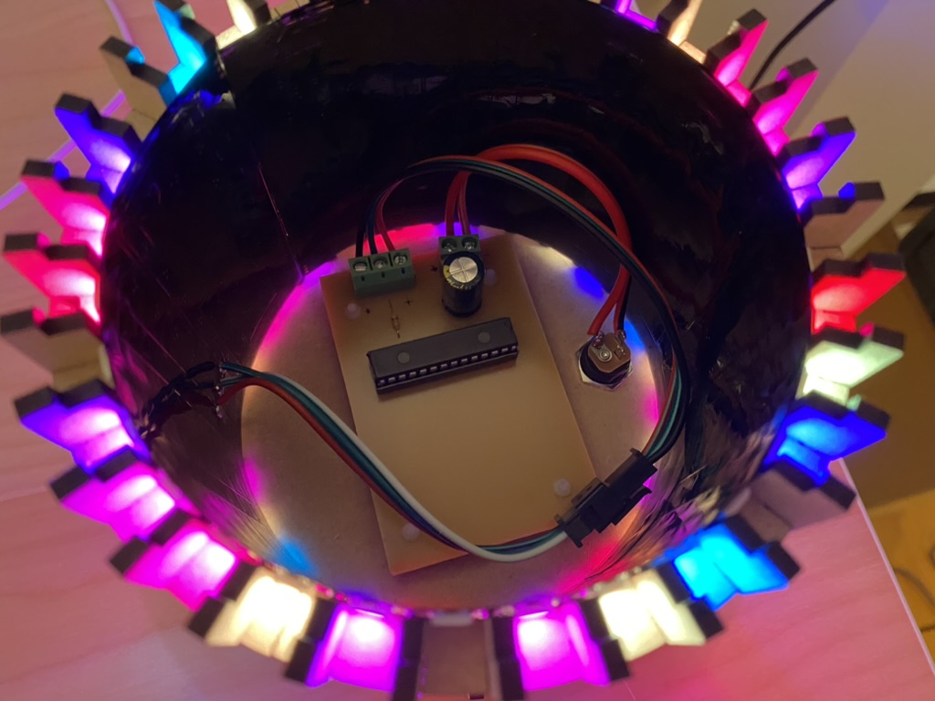

It’s worth knowing about the option to drop down to direct port manipulation (if you don’t need the safety checks that digitalWrite does). My own version of the matrix lamp uses a bare Arduino chip with no clock crystal, which means it has to run at half speed with a less stable internal oscillator. Yet it has no problem driving the display, because I didn’t try to clock out the bits myself. I’d rather use the great FastLED library and take advantage of the collective knowledge and optimization skills of the open-source community.
