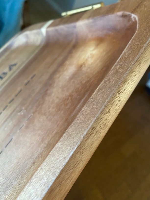

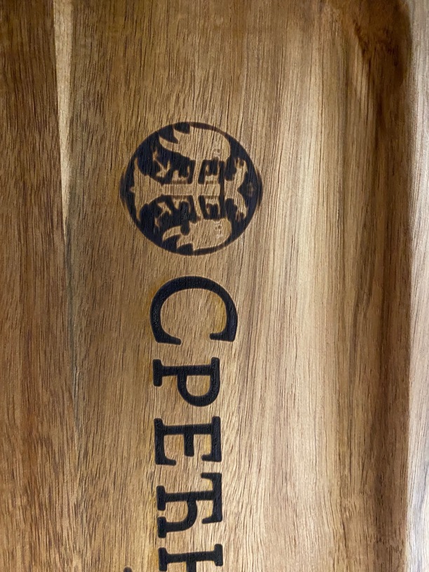

So I engraved two exact same boards/files a few days apart with (I believe) the exact same settings. First board came out perfectly; the second one is like too soft and the image is blurry. I can’t figure out why. Any insight?
They are acacia trays, about .48" with the crumb tray removed. Settings are 1000/100/270. adjusting the power doesn’t help on the second one.
(sorry pics are in reverse)

the darker one looks very out of focus.
Yeah. The files are the same and the machine is fairly clean. What could be causing it to lose crispness?
My first guess is that the height of the two pieces isn’t the same and the focus was not reset to the second which would cause blurriness. Are they different thickness/heights?
as i said, out of focus.
this. when the laser is out of focus, you’ll get that kind of burn. you need to be 100% sure you’ve either manually set focus properly or used setfocus to get proper focal height.

image image
This darker engrave on the left is completely out of focus compared to the lighter one. there’s no way the laser was focused properly for the left engrave. all detail is completely blown out.
