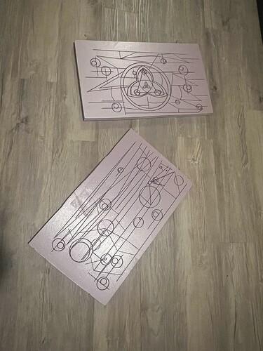

One of my favorite new shows is Ashoka on Disney plus. Made this action figure diorama for my friend. I used 1/8 cardboard settings.

Would you please care to share details of your technique?
What is the substrate used? and how did you give it relief and texture?
How did you achieve such depth in the paint job?

First off thanks.
  1. it’s just insulation foam core from Home Depot. I have great ventilation and wear a respirator when I’m using it. Even though it gives off very very low oder.
  2. draw lines and circles as best I can from Ashoka episode #1 in Inkscape.
  3. used 1/8 th cardboard setting in Glowforge. It’s about a 6-9 minute score.
  4. use respirator again and then use blow dryer to harden scored areas on foam core so that it doesn’t melt when I spray paint it black.
  5. spray paint black to get into scored crevices
  6. spray paint at an angle with brown or grey, but don’t get it into crevices.
  7. dry brush technique with light grey or white very lightly
  8. dry brush with medium dark grey and medium dark brown
    That’s it.

So you´re telling me there was no texture added and it´s all optical ilussion of the paint technique.
That even makes it more astounding, because it looks like it has relief and texture.

The spray paint melts the foam a little. I forgot to harden it with the heat gun/ or blow dryer. It would have made the same effect, but I would not have had to wait 1 hour between layers of paint had I hardened it first. I had to rely on the first coat of black spray paint to be my hardener and tread lightly on the layers of paint. I volunteer at a prop shop, so that’s where I learned how to make foam look real. Here is a better example of what can be accomplished with foam and dry brushing with paint. ( no Glowforge in these pics)
