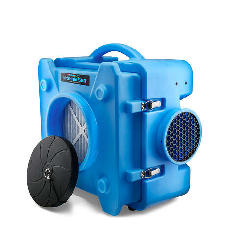

I have been using Blu-Dri since before Glowforge had one. It is 500 CPM, well above the ~250 CPM of the Glowforge, and there are several specific filters rather than one combined one. The HEPA filter is very expensive, so having to replace that every time the others get full can get a lot more pricey.
It does have a 12" input which is an issue but less so than other filters. As I am able to use a window, I have it just cleaning the air for the whole house now.
