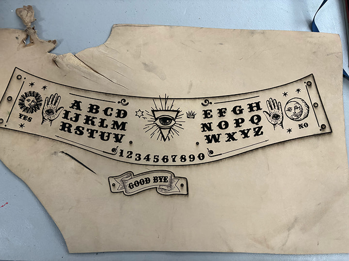

Willing to post a picture of your material?
I have tried several different leathers that are mine, mostly matte not very nothing crazy. the thing is i had another glowforge and i put all sorts of things in it all sorts of leather, thick thin whatever and it never gave me this issue. i did it for years and years.
Here is the leather. I was able to laser it but I used another piece of the same color and I got the error
There no reason that shouldn’t work that I can see.
My next suggestion would be to mask it.
It also might be worth reaching out to Support. They might be able to see something in the logs that makes it make sense! You’ll likely have to jump through a number of hoops. Letting them know when you ran the GoGM and including that picture might speed it up.
