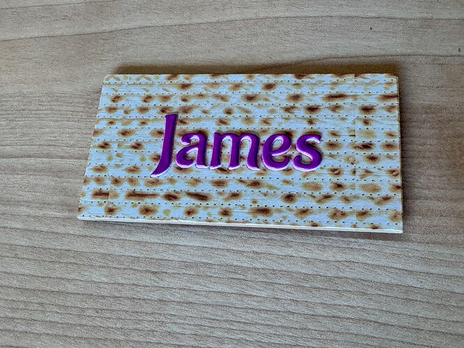

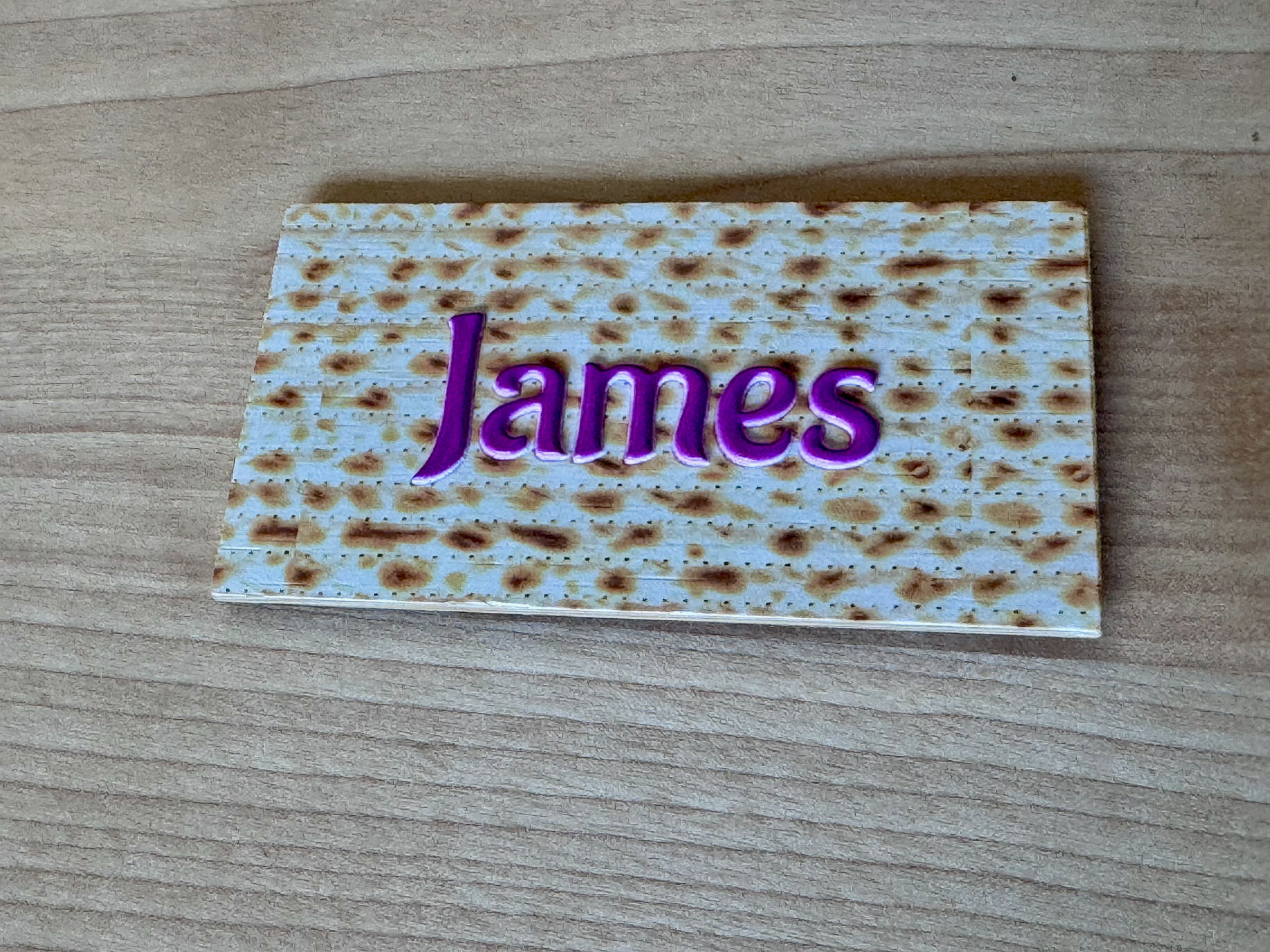

As usual the place cards are the big project for production, and while this year’s crowd isn’t by far the largest we’ve had, we still are having 27 people. One item my projects have always had as an issue is that 3D printed projects take a while to print, like the Nefertiti heads several years back which were 5-color prints took like 4-5hr each, so when we had last minute guests (was still adding 2 people last night!) it was almost impossible to make quickly, so being able to whip a spare out last second is useful, and I always try to use my latest maker toy, this year being the Eufymake UV printer. Originally I was planning to do ceramic magnets (similar to the ones that come with the printer) except… Basically they are unobtainable, and I finally found a vendor (on Etsy) that sold similar 3x2” ceramic magnets, but they didn’t arrive until this week, which was too late to begin the place card manufacturing. So I chose an alternative media, which were bamboo (not Bambu - I’m a Prusa guy) business cards, these are from amazon. They are 3x2x0.07” in size. I quickly made a jig to be able to quickly produce them without having to worry about positioning (I mean it’s a rectangle hardly worth discussing). And put down a high res scan of matzah, and the name was done inside the EufyMake studio making the text the default 2mm raised (honestly it was accidental but looked cool and only added about a minute). So they came out like this:
While the line of where I tiled the scan is obvious in the photo (that is in reality tiny). Not bothering with a banana for scale since everyone has seen a business card before. I got a set of nice self adhesive magnets for the back, and they stick well to things. Anyway, takes about 10 minutes to do one if we get any other last minute folks. And since they are cured as soon as they come out of the printer you can immediately use them for REALLY last minute prints.

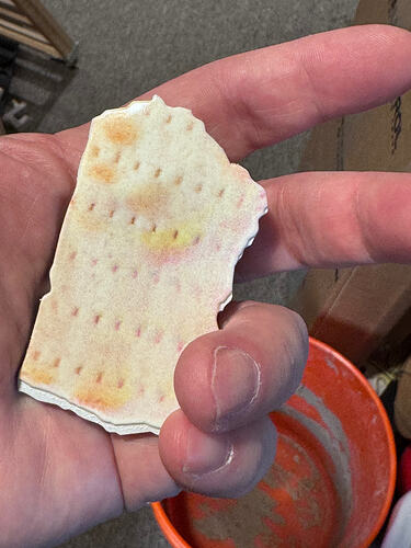

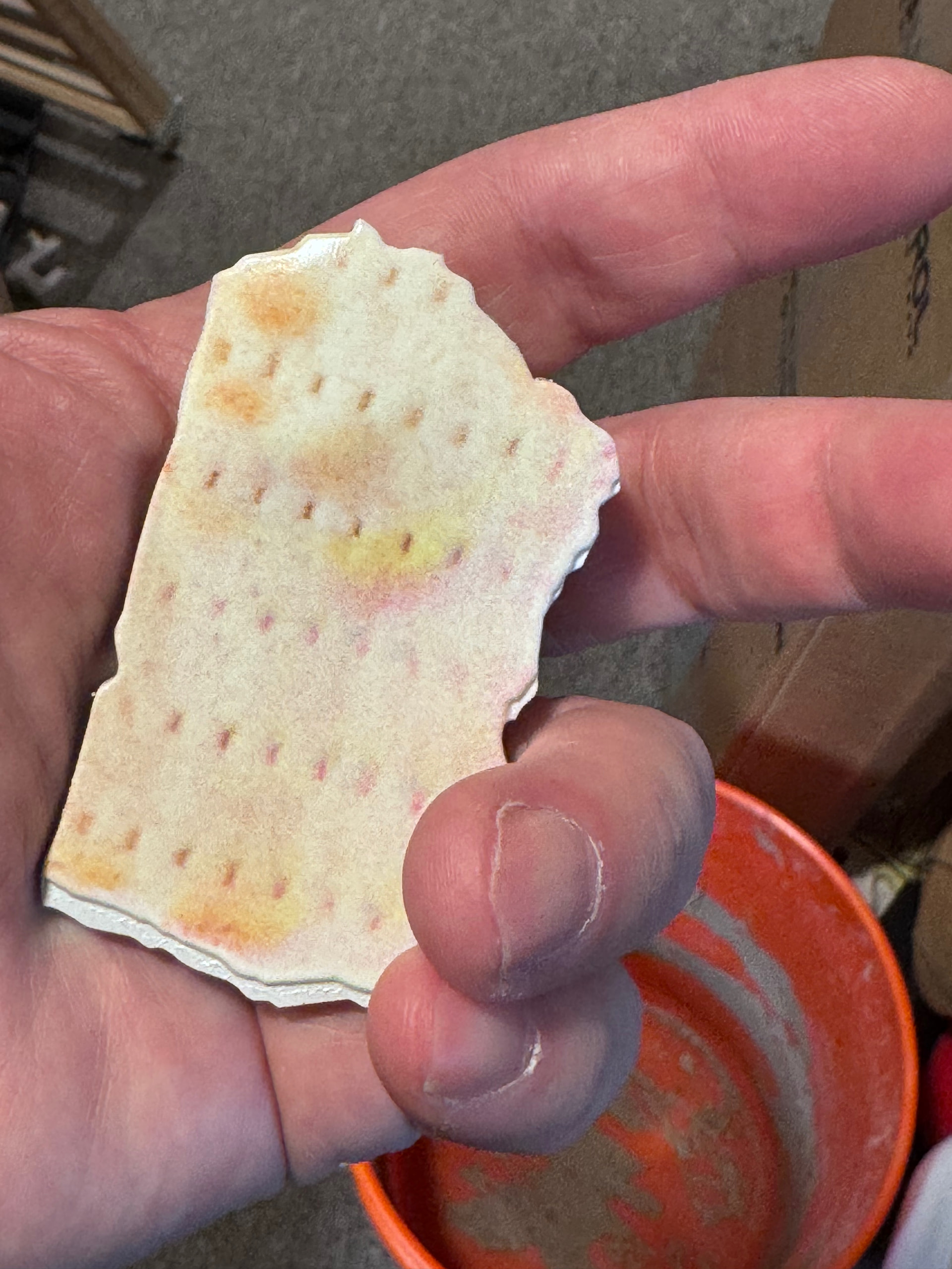

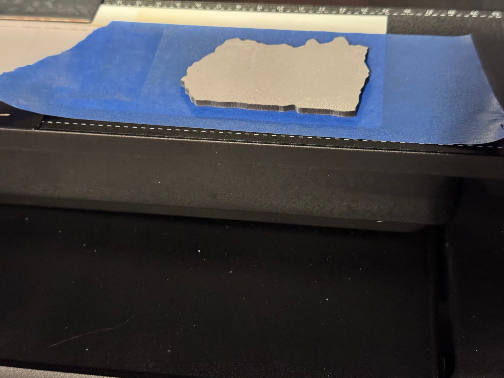

Sooo, finally to the project. If you have a laser cutter, a UV printer and some matzah the answer is obvious: Fake Matzah. Yes, instead of all the obvious hiding spots (since we have to eat it once reassembled a lot of places are out of bounds) so instead how about filling the room with draft board fakes, so like the scene in The Thomas Crown Affair, we flood the room with fakes. So first step is getting a good scan of broken matzah, get a good cutout in Photoshop using the magnetic lasso tool, then take the outline and pump that as “Paths to Illustrator” and take the path as a SVG to the glowforge and cut out the piece of Draftboard, a quick layer of white spray paint (you don’t need it but spray paint is like 1% the cost of white resin):

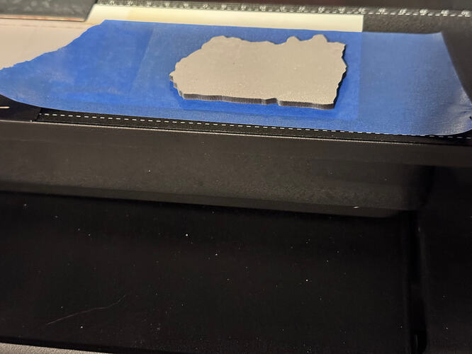

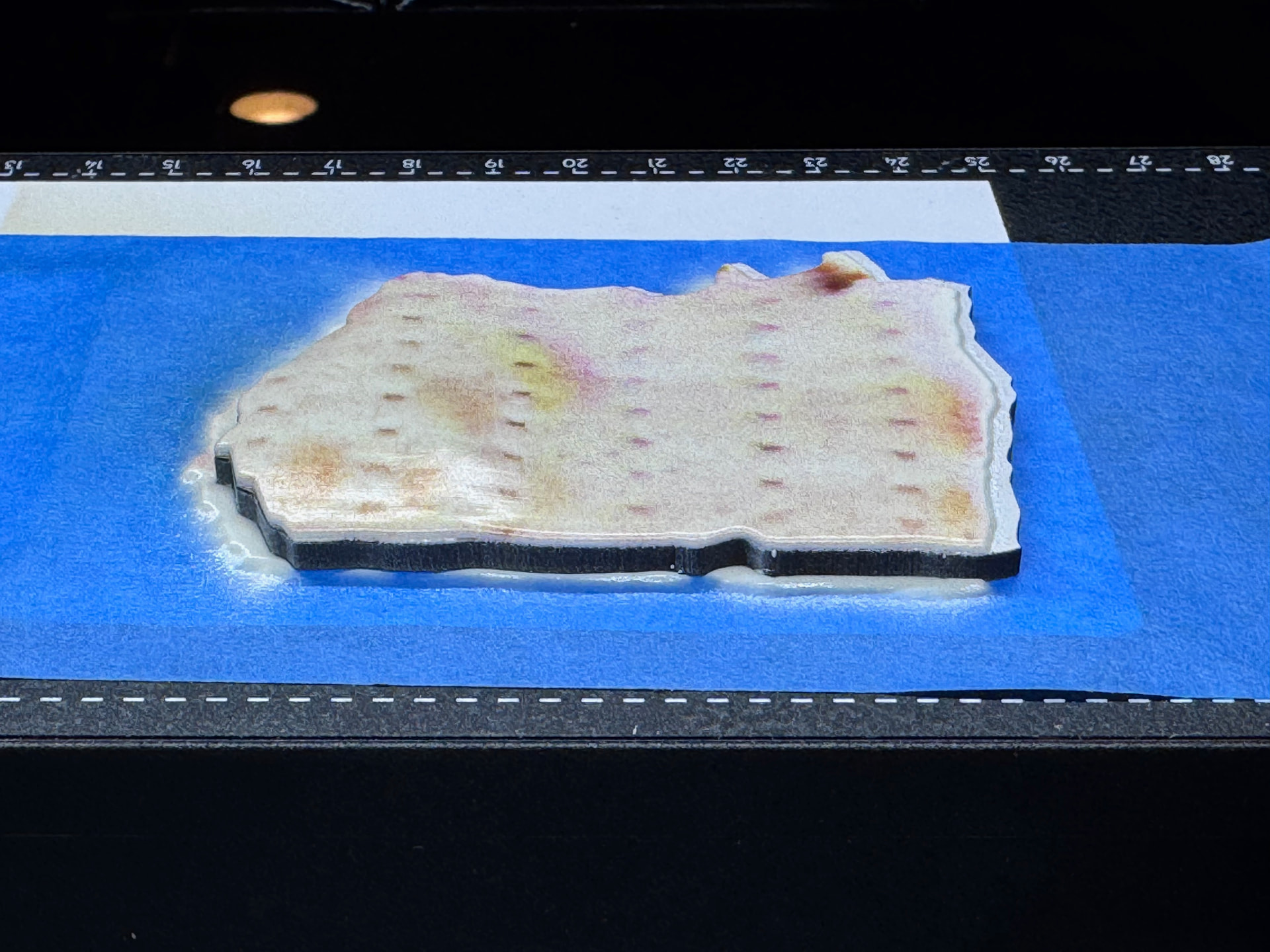

I took the PNG I had made the SVG from, and put that in Eufymake Studio set the mode to a raised pattern.
OK didn’t quite get the alignment perfect, but given this is only quick and dirty around the room this is fine. The blue tape is because I knew I was going to get some overspray.
Need to turn off the gloss coat layer (didn’t even notice I had it on)

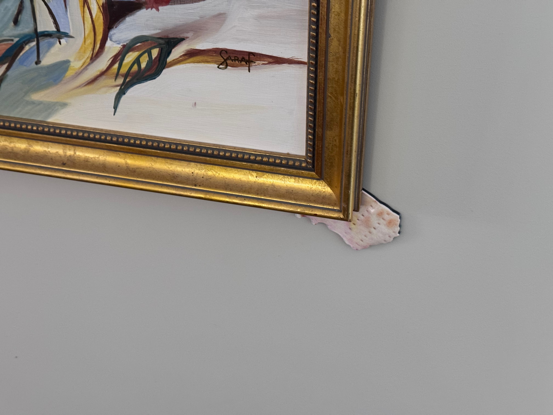

A classic hiding spot of Afikomen matzah but that is Draftboard!

The raised name really adds, so yay for missing turning it off :blush:
