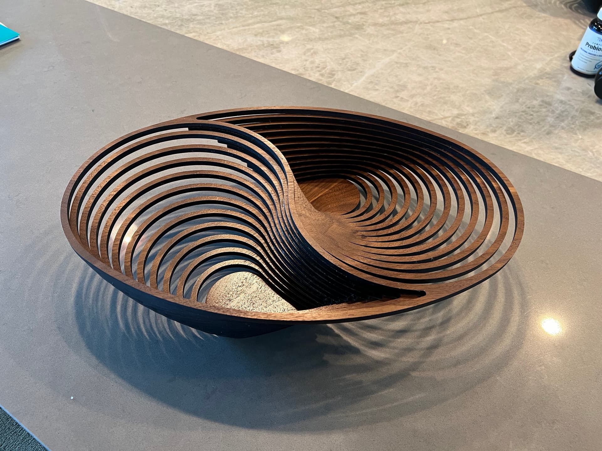

Another Stratified Walnut Bowl
Gorgeous!!
Turn that bowl over and you have an incredible lampshade .
Thanks everyone for your kind comments. I will post more as they develop.

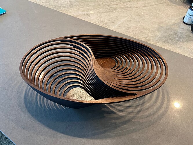

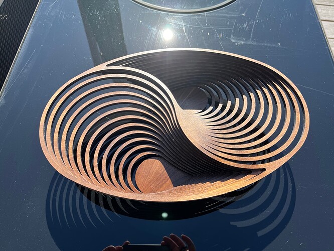

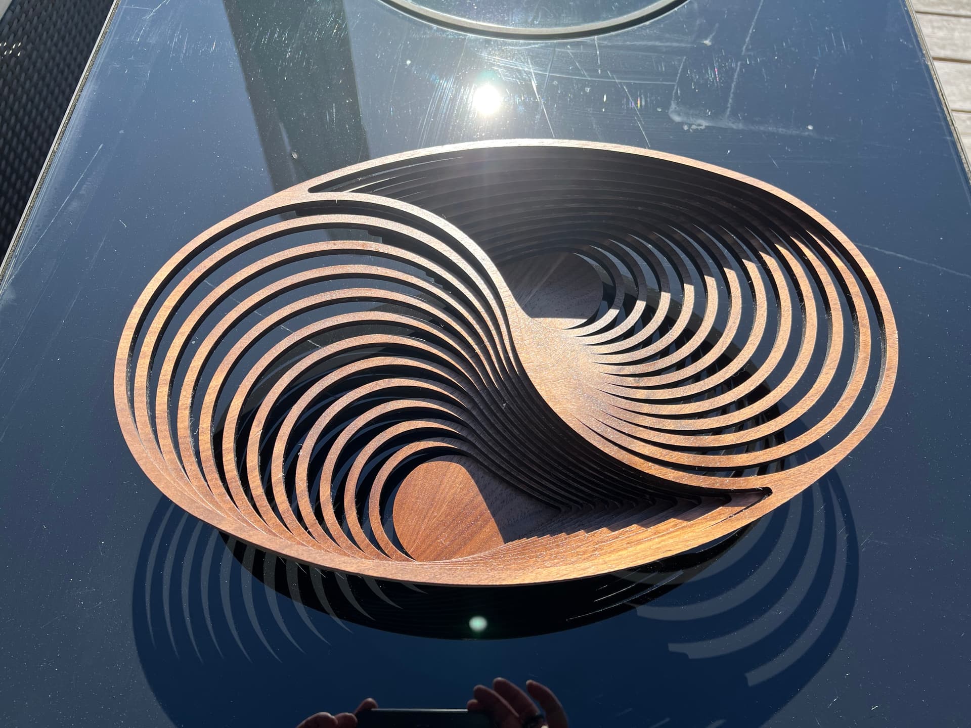

here it is in walnut.

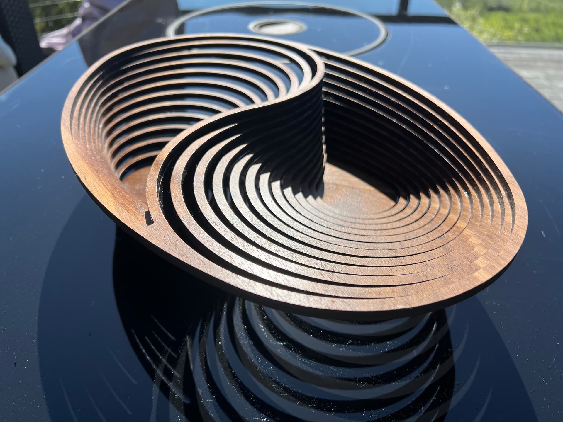

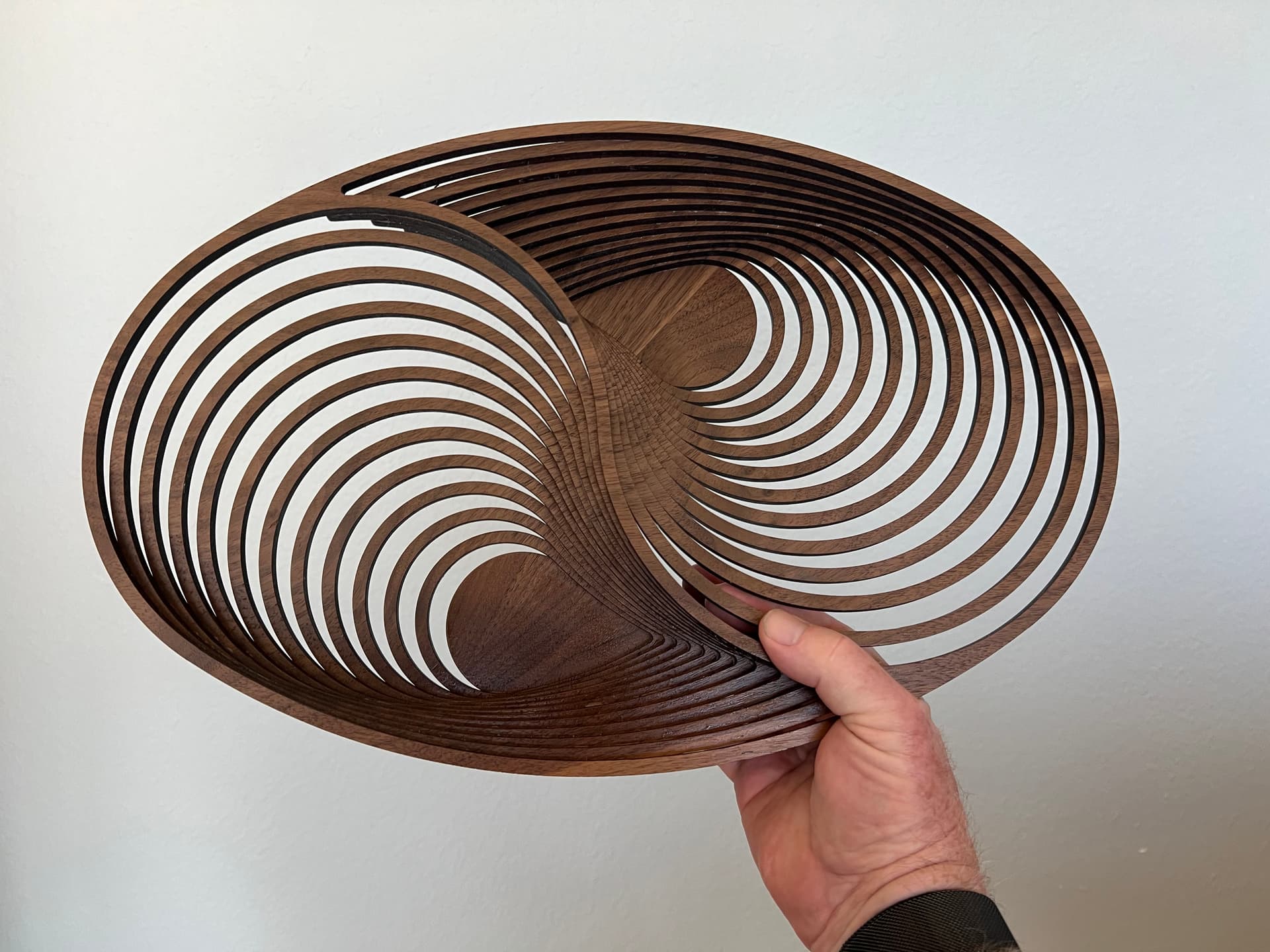

Here is the latest bowl, with two compartments. I think this may be my nicest yet. A gift for my daughter’s 30th I want to try one with three compartments next.

Beautiful!
Wow, that looks spectacular!
That’s mesmerising!
That’s great for entertaining in addition to decor. My wife would fill it with different snacks (wth a cloth lining the bowl sections) that compliment each other.

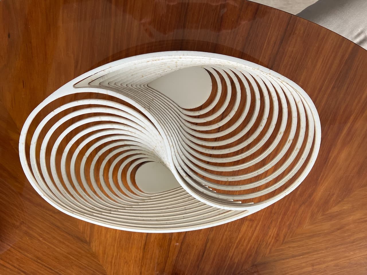

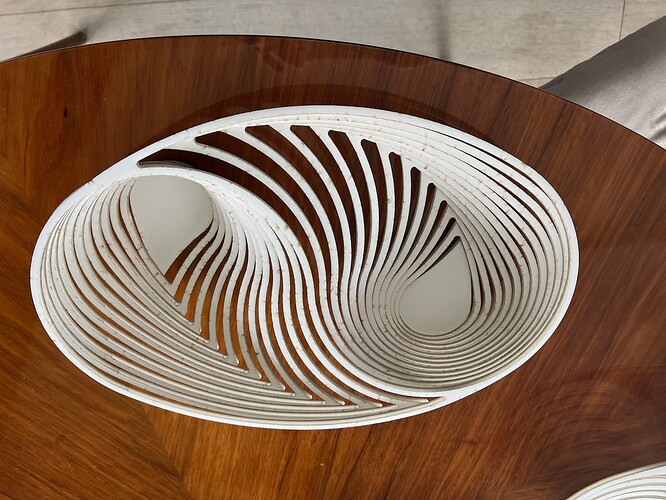

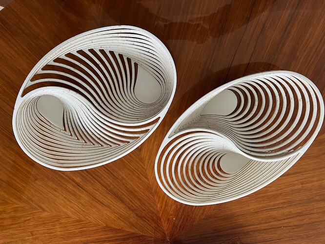

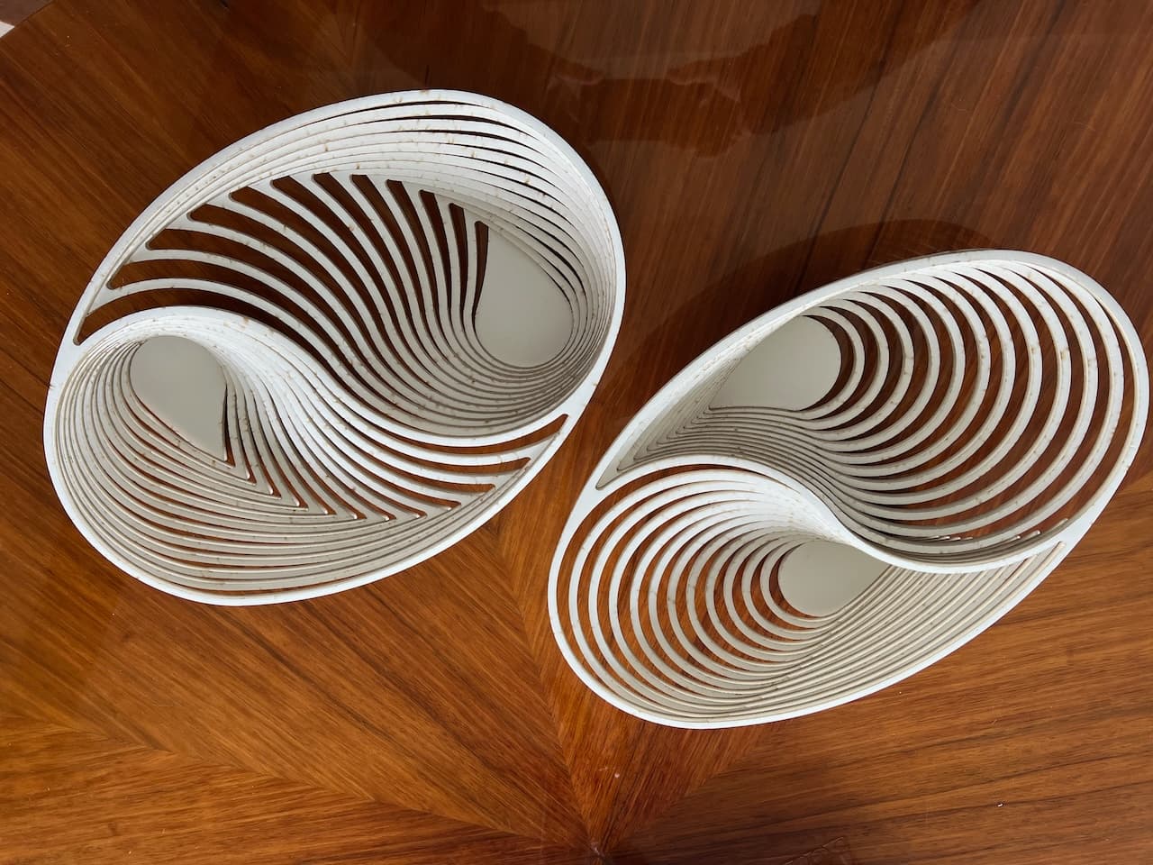

I always make foamcore prototypes first to se if I like the shape, and check for structural integrity and ease of assembly. It is interesting to note the profound difference in aesthetics if each layer is rotated clockwise or counter-clockwise. In this case, layers were rotated 4.5 degrees.
Matt
Thanks for giving insight into your making. These are beautiful bowls!
Material for the prototypes–is that the standard so-called ‘artists foam core’ panels, or did you use a different thickness? Does the thickness of the prototype differ from the final material, or does it matter?
I learn so much from this community!
The material is plain old foamcore as you suggest. It is a little thinner than 1/4”, which is the thickness of the wood
