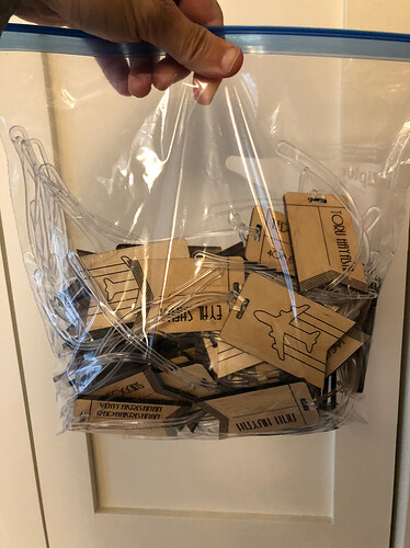

Art Deco Style Luggage Tags
(upload://ok701H8zVWn4yMOWV21M2B7OCFx.jpg)
Full Instructable and source files in Illustrator and SVG here https://www.instructables.com/id/Art-Deco-Luggage-Tags-Laser-Cut/

It would be easier to get the back side alignment right if you include that artwork in the same file as the front artwork. In the GFUI, turn it off when you’re engraving and cutting the front, then just flip the tags without moving the rest of the sheet. Turn off the front side steps, turn on the back side engrave and go. As long as you don’t move the sheet or close the GFUI in between, everything will be perfectly aligned.
Nice! Throw a “Would You Kindly Return” on there and you’re all set!
thanks bdm1, i will certainly do that next time. Am also thinking about making a jig to hold 12x20 material the same place everytime, curious if anyone has already done that?
