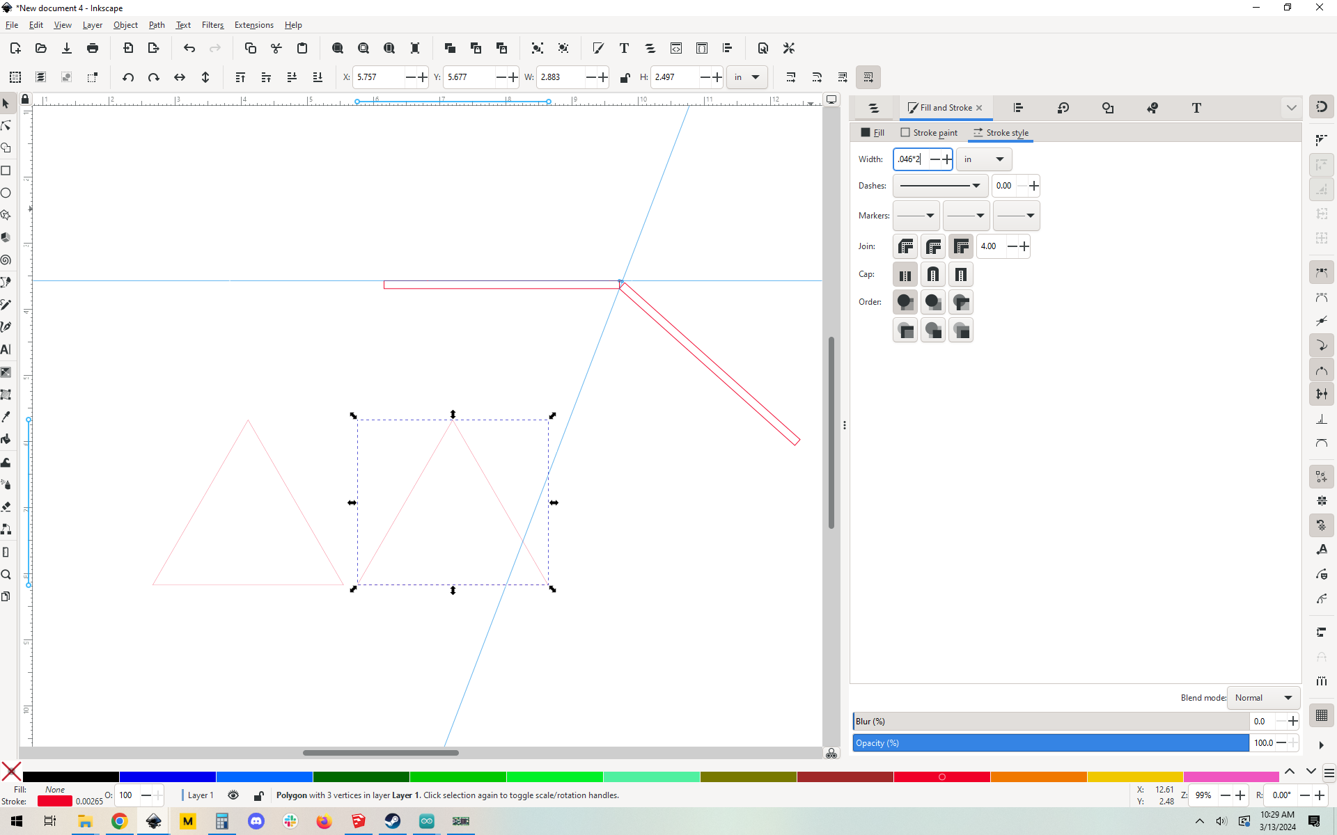

While that’s quite a compliment, I gotta agree with Deirdrebeth here. Nothing I am doing is particularly complicated, and I use software to handle so much of the heavy calculation.
For example, if I were going to scale a face like @reynoso did, I would use inkscape to simulate the joint and figure out how much to resize things. It’s all done by basic dead-reckoning type geometry at that point.
First, get the angle of the joint (called the dihedral angle)
Now simulate your wood faces (I chose 0.12" thickness because that’s about right for BB)
Now rotate one of them by 138.19 degrees and snap them together:
Now I just start drawing things and using guides.
Drop a horizontal guide on the top face. Align another guide to the top of the angled face. The intersection of those two guides is now where the faces would meet.
I don’t love the ruler tool in inkscape, so I tend to draw horizontal line segments and get their width.
In this case, 0.046". This is how much the triangular faces need to be expanded on each side. There are lots of ways to offset a shape. I’ll use the stroke to path method. Copy your triangle and make the new copy stroke be 2* your desired offset. I don’t want to do math so I put the equation 0.042*2 in the stroke width field:
Which gets you this:
Now it’s pretty standard stroke to path break apart etc. This has been covered many places so I won’t go into it.
Anyway, my point in all of this is that when dealing with geometry like this you don’t need to know trigonometry or anything and you can sort of work intuitively if you understand some basics and are pretty handy with guides and path editing. In fact there are lots of different ways to logic this one out[1], so you can just go with what makes sense to you.
I know this looks like a lot of steps but with practice you can fly through this sort of thing. I’d guess that this whole thing would take me around a minute at this point (1:15, just timed it). It’s a quick process, I think all of the creatures in this post (except the egg, which was a whole other design method that I was figuring out as I went in a 3d program) were done in about 2 weeks.
