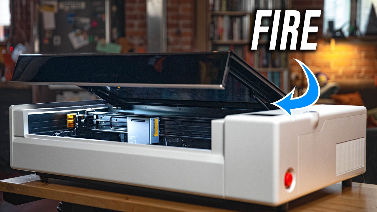

Looking at the BL site there are some impressive features.
Flame detection and Auto Fire Suppression are on this unit according to their site.

For the BL laser it is good that they put an e-stop, but they put it in the wrong place.
