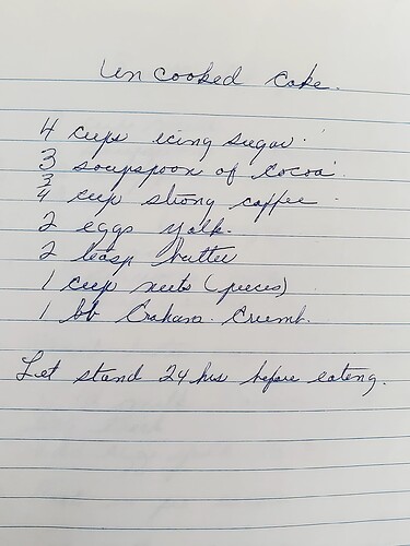

We’ve had our GF for years now, and love it. We’ve recently been getting more and more requests for words engraved on things (everything from recipes to notes left by loved ones). I’ve used online programs like remove.bg, then spend 4 hours with Silhouette to try to clean it up.
I’m thinking there’s got to be a better/faster way to learn how to do this.
I’ve tried converting pic to BW (nope), I’ve tried scanning with different resolutions to create more contrast (that was a waste of time). I’m not terribly brilliant at doing this, but also don’t want to turn away good customers because I don’t have the time or the skill to complete these projects (I mean, I can the time but don’t feel it’s reasonable to charge someone for 4 hours of work when it should only take me 20 minutes to prep, right?). Anyway, what online programs can anyone suggest? Even if those programs have a ‘free’ option but also a ‘pay for instant conversion’ option…I’m looking for advice :slight_smile:

Converting recipes to an engraving is a recurring topic here. The tricky part is that they’re all different so there is not really one rock solid method to prep every recipe.
The good news is that there’s one free program that can handle pretty much any recipe conversion you might come across: GIMP.
I know you asked about online tools but I’d recommend downloading GIMP and then reading up on other people’s recipe conversions. It’s not too difficult and the amount of time it takes will depend on the quality of the starting image. I’d recommend this over online services because it’s much more capable than any online system.

One of the hardest parts of these is getting rid of the lines. I tend to find that manually going over those with a white brush in my graphics program (I use getpaint.net) makes all the other steps pretty quick.
So basically adding a first step to the 2. Open the Image instructions above that says:
  • Zoom in closely, then with a white brush colour over any paper lines.
Also, happy cake day! It’s your forum 4th anniversary :grin:
Do you happen to have an iPad?
Procreate ($12.99 one time purchase) and an Apple Pencil makes really quick work. It can sound like a splurge to use a stylus instead of a mouse but it really makes a huge difference speeding up workflow, especially for things like those lines.
Before you convert it to black-and-white if you use the select similar color tool you should be able to select almost all of the lines separate from the text. You’ll have to fiddle with the threshold but it should work really well.
