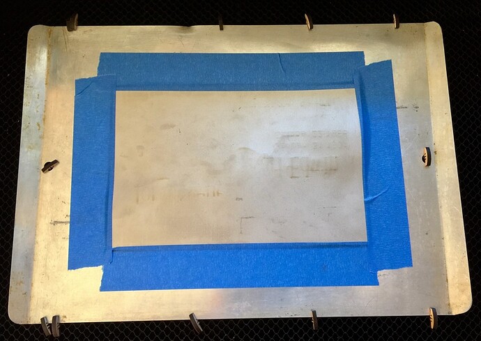

Not going to start my testing until tomorrow as it’s late in the day and the temp is a bit high here today…but, I’m ready to roll tomorrow. Found my rinky dink little cookie sheet (10" x 14" aluminum) out in our RV and have sacrificed it for the sake of my project. I still have to be able to put my sheet of Ti squarely in the GF to be able to align my file, so I drew a correct size rectangle with a Sharpie of where to place the sheet.
I taped the piece of Ti down and then pinned down the baking sheet with hold down pins. Quite handy how I got two extra anchor points with those two holes on each end! This is the back of the bent-up piece and you can see on the right side where the tape is buckled…but, I got it down flat as best I could. Hopefully, with the new piece of Ti, it will be flatter.
I can’t take up a lot of area with the tape on the Ti itself…with only about a 1/8" available margin and I still have to be able to align everything. This is beginning to make me nervous!

That’s gotta work. Good luck.
You might want to try using Gorilla Duct Tape - it’s a way stronger bond than the blue tape. I’m not sure the blue tape will hold the Ti down.
Or drill some more holes in the aluminum sheet (if you really are okay sacrificing it) and use more hold down pins.
But then this whole thing has been a fascinating experiment to watch develop.

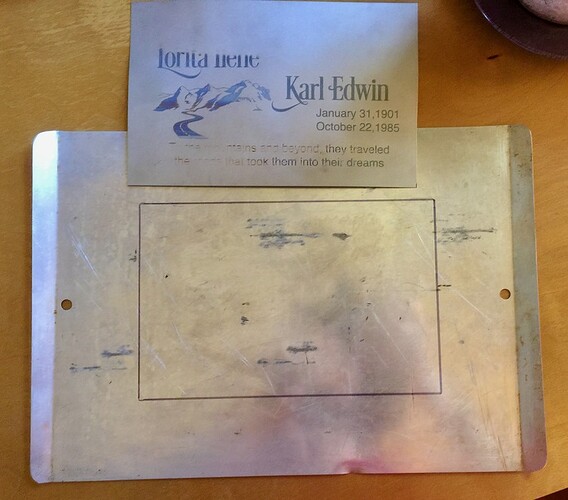

I agree about the tape. It’s going to take something much stronger than blue. I added a piece of duct tape over the one bent spot up on the right and even that is buckling. But, I’m almost finished testing for today and so far it’s all held just fine. At least the new piece of Ti won’t come being already warped like my test piece. So far, the baking sheet with hold downs is steadfast. I’m leaving it all set up until I’m satisfied with everything…but, then the whole outcome is also going to be telling when I turn the test piece over and see what happened on the other side…as well as seeing if it’s any worse warped than when I started.
